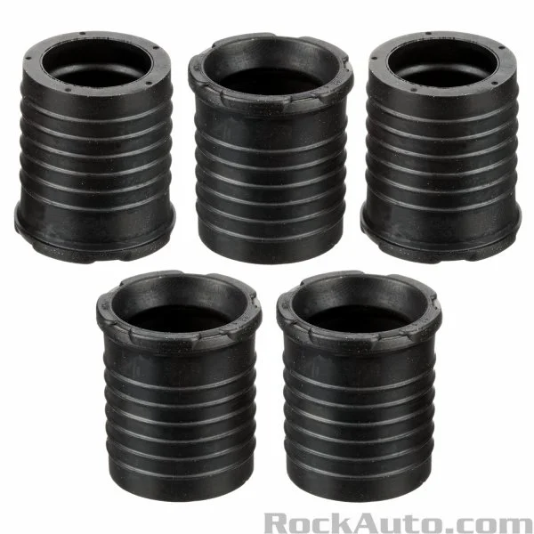

I re-seated the dipstick further into the hole with a new o-ring, but it's still leaking. I found a discussion about some sort of grommet that goes down into the hole, and how the combination of it plus the o-ring makes a good seal. I believe this is the part in question, but (a) it will be an extreme challenge to fit over the end of my dipstick tube and (b) the parts manual makes no mention of this piece. Rock auto says it fits, but I'm not convinced. Has anyone used such a thing before, or had any trouble sealing up the trans dipstick tube?

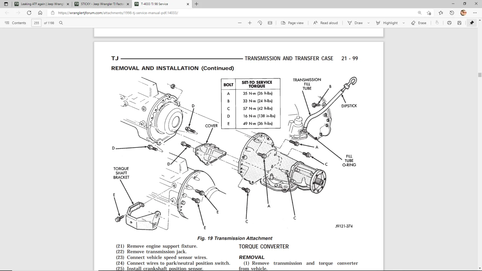

I keep coming back to the fact that I can't seem to get it to seat properly/fully AND have it all aligned in a way that lets the bracket on the tube line up with the hole in the bell housing. I asked in another thread that didn't get any action, but I would love confirmation on which hole it should be bolted up to.

yes, although the bracket on my tube has a bend in it, and seems like it wants to sit on the engine side of the bell housing. But to bolt it up to the hole pictured means it's barely seated in the hole.
