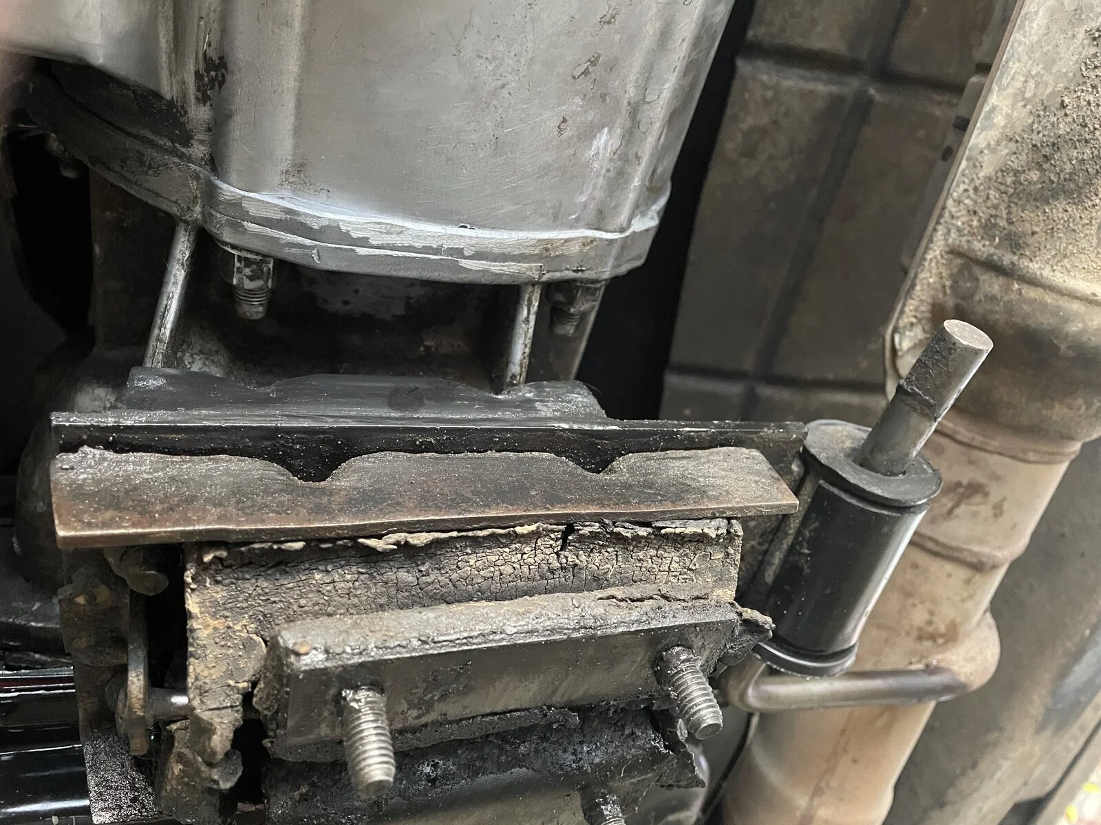

I guess yes, I don't know where to look. I've had my eyes on everything I can get them on, and my hands everywhere else and the only ATF I could see [relative to early on in this thread] was at the pan. I've since changed the pan & gasket and all that looks much cleaner now but there is ATF on the rear lip of the pan. I haven't dropped the skid yet but I got my hand up there as best I could but didn't find any leak sources.
I just went to the garage to check again. No drips on the floor, but there is a little red on the inside lip of the pan. I'm 95% sure I wiped that down last night. So its either seeping or I'm a lousy janitor. Or both. I mean, the simplest answer is the pan is slightly bent. Maybe I go back and give it another 5 ft-lbs on the back bolts, dry it off, top it off, and see what happens.
