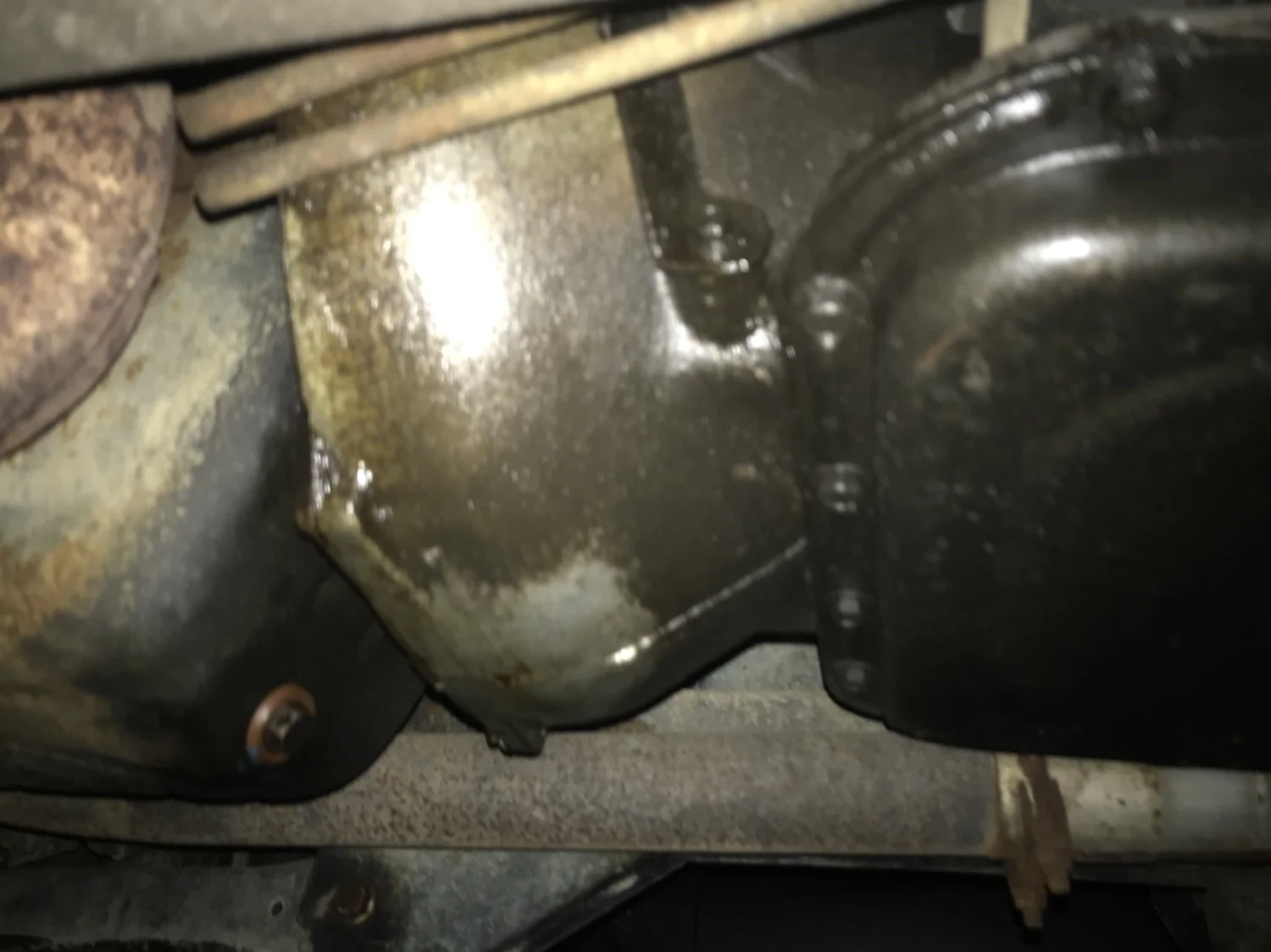

I’m leaking coolant on the drivers side toward the end of the block
Nothing is even went above the Exhaust manifold!
Looks like it’s almost leaking under it or running down right there
Any ideas

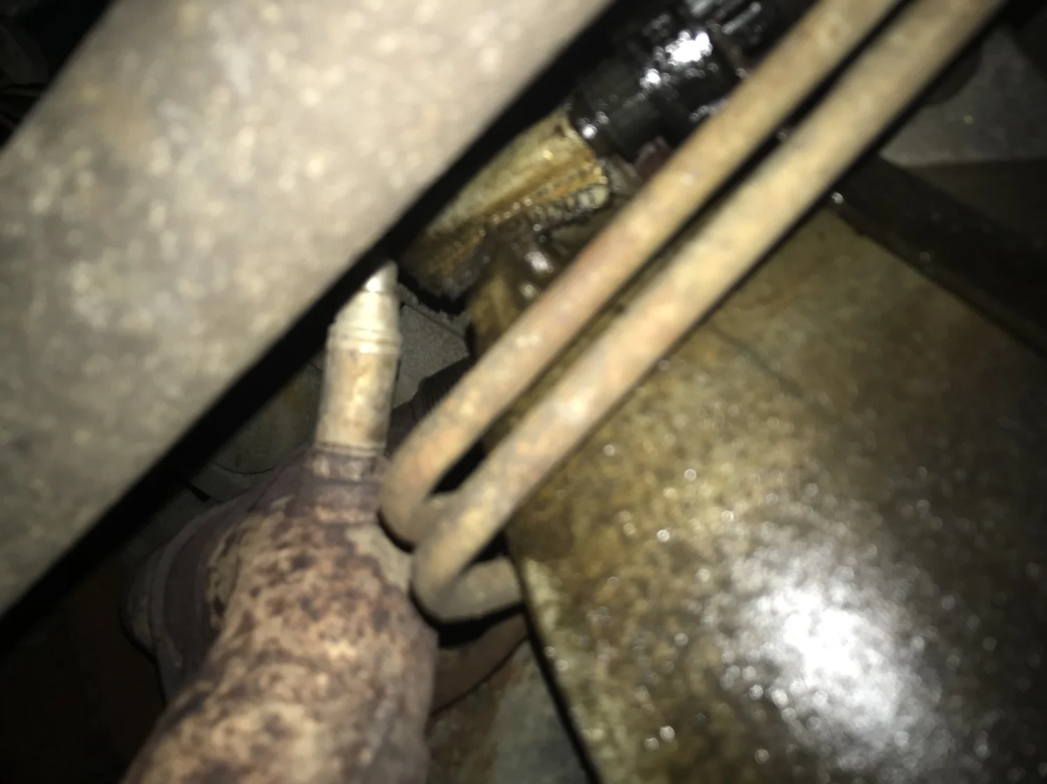

Are the transmission cooler lines on that side or the passenger side?

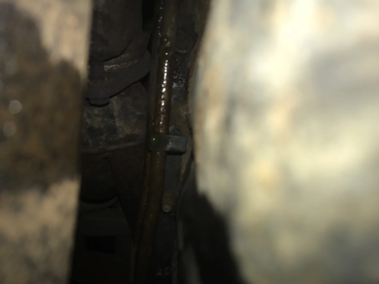

The pics are very bad but I’m pretty sure that they are the trans cooler lines
Maybe spraying and running running down ?
What do you think?
Ive been doing some checking around
The trans coolant hoses are about the only thing I think it could be!
There’s no other reason for me to be leaking coolant that far back on the motor

I’m not exactly sure where or how to check a frost plug
When mine leaked like that, it was the freeze plug on the back of the cylinder head. I pulled the transmission to get to it. When I got it out, I expected it to be all rusted out, but it was mostly solid with a pinhole. I only had 113,000 miles.
I do not have a block heater
And I’ve been looking and it seems like the freeze plug could be the problem
I know there’s 2 on the back and 5 on the drivers side
That being said I believe that it’s my furthest back on the drivers side
And tips or tricks to replace?
