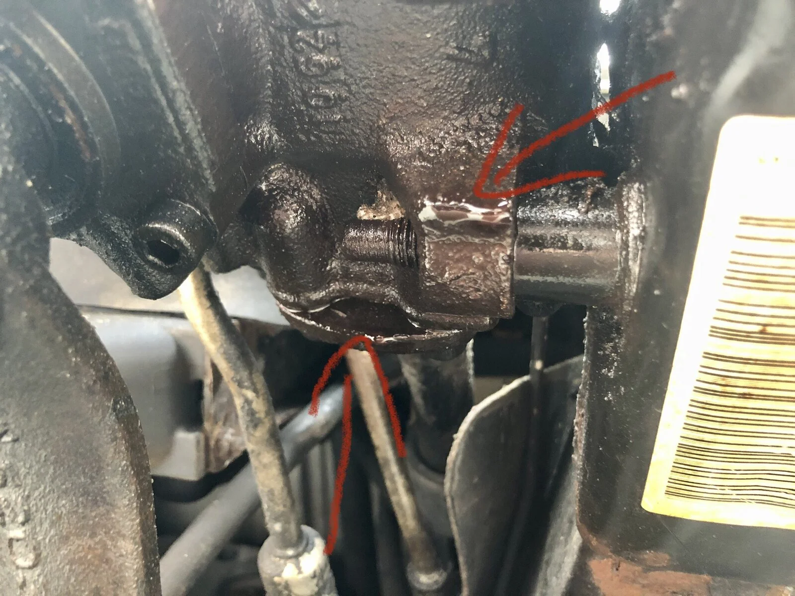

It looks like I have a leaking steering gear box. Is it worth it to try and rebuild it or am I better off just replacing it with a new one? Is it difficult to replace? Thanks.

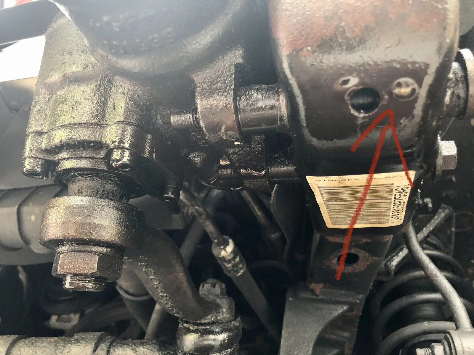

For reference the photos attached show the dripping fluid.
