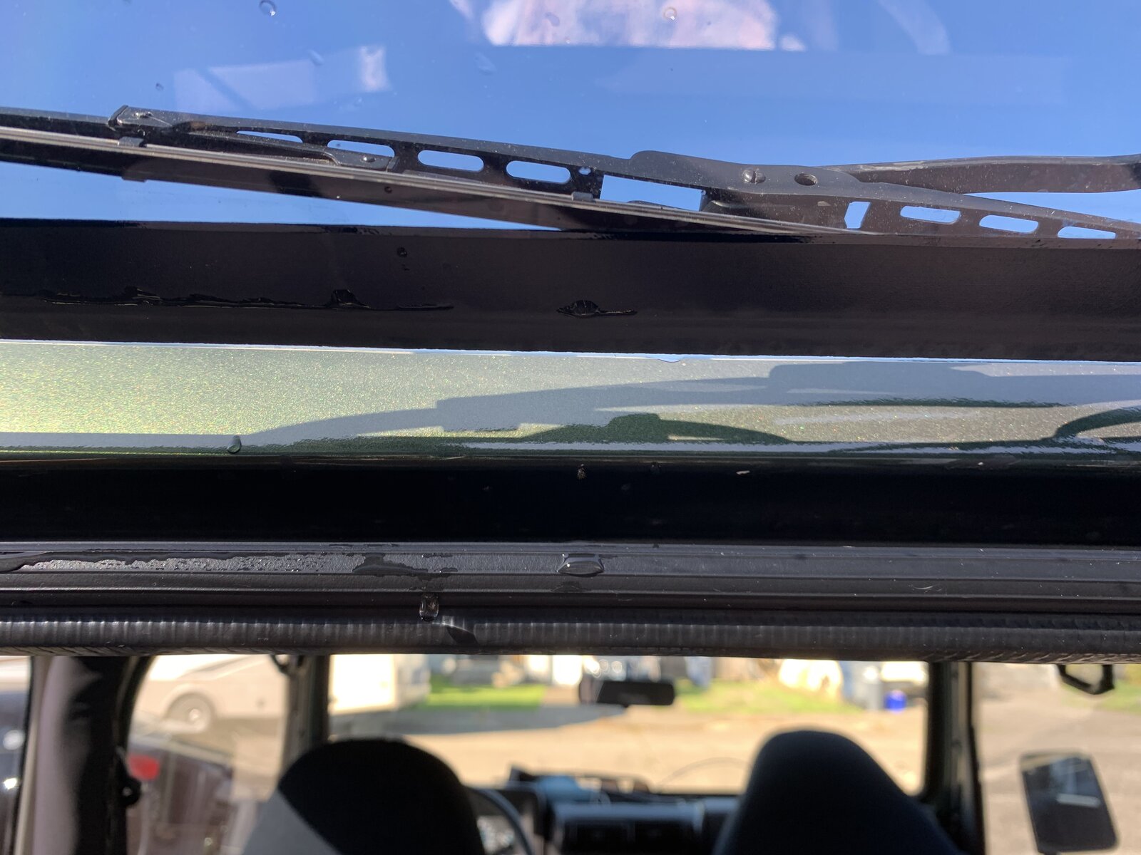

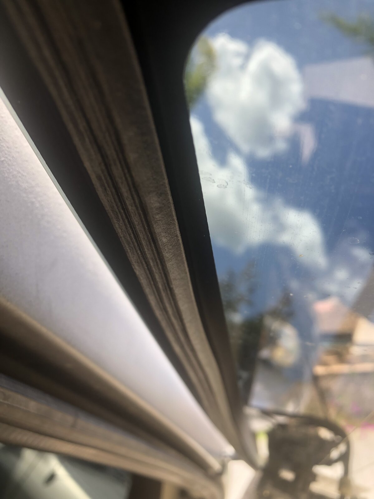

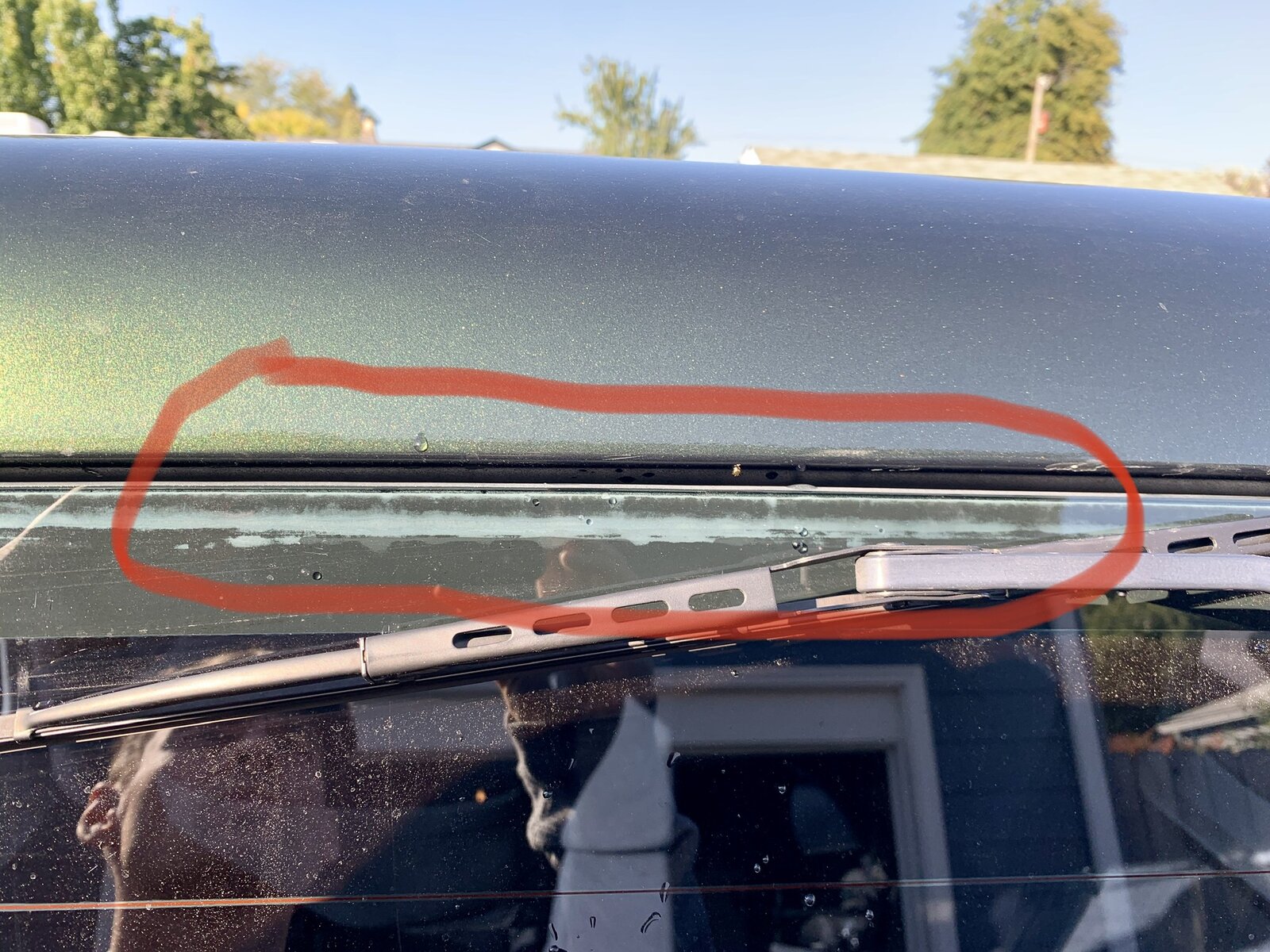

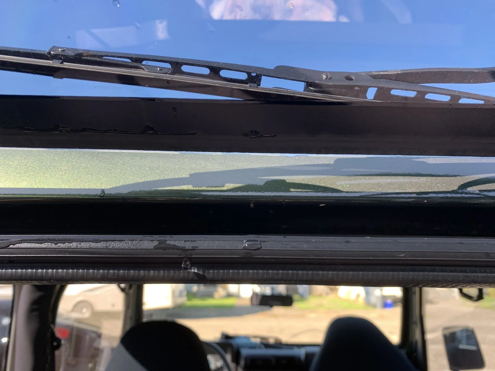

Hey all,
I know the hardtop rear window leak is fairly common. I have replaced all the seals back there and have tightened the read window bolts. The seal between my rear window and weather stripping just isn’t tight enough. I’ve read about people weather stripping the rear window. Wondering what has worked for people?

Mine definitely failed the paper test. I’m going to order some new hinges. I also weather stripped my rear glass with some black 1/4 frost king weather stripping. That stopped the leak and almost looks factory.
