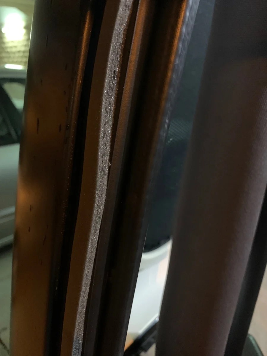

My rear window wasn't sticking (when closed) to the rubber weatherstripping of the hardtop, there was a slight gap which let the water LEAK all the time:
I did replace ALL the rubber weatherstripping, and the sealing of the hardtop (starting from the front to the back, ALL replaced with new ones)
The solution?
Quickest and less painful, and of course CHEAP.
I bought Rubber Foam Weatherseal, self-stick

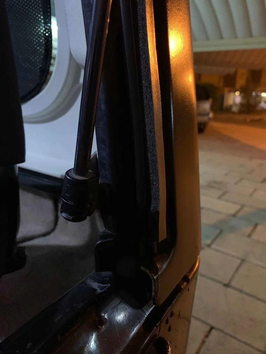

and I stuck it to the Hardtop weatherstripping, YES, ON IT.
It filled the gap, between the hardtop weatherstripping and the rear window with NO LEAK at all.
*Check the photos attached*
I find it effective.

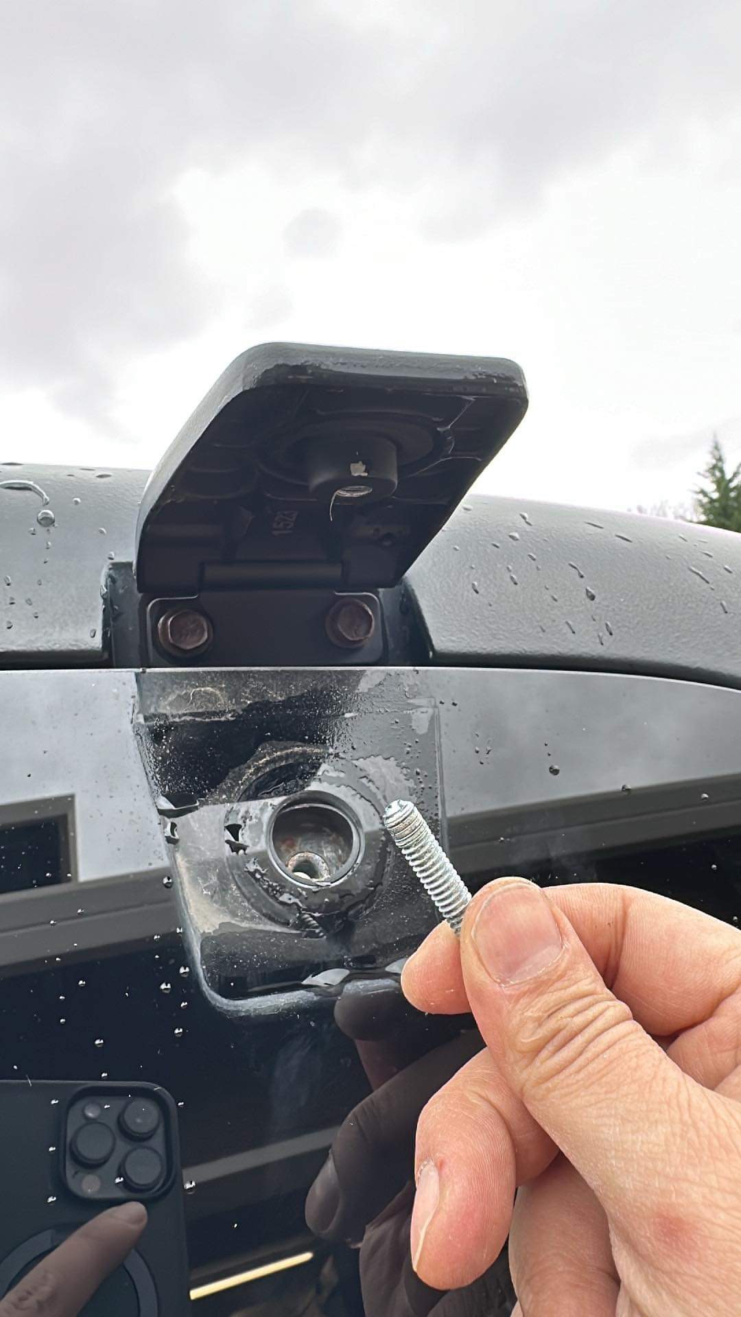

Oops, a little too much torque there? Glad you didn’t shatter the back glass, that would have been a much more costly mistake. Other option would be to tap it out one size larger and see if a bolt would fit. I don’t think there would be any issue with a larger bolt. Just don’t crank down too hard or you’ll be sourcing a new rear window.
Reactions: ChasUGC
That's exactly what I was thinking. Plus, if the rear window had the defogger and tint built in, it would probably cost a thousand dollars.
Glass is just one reason I keep full coverage on my TJ. Minimal difference between liability and full coverage, and that $0 deductible on glass replacement is worth every penny.
