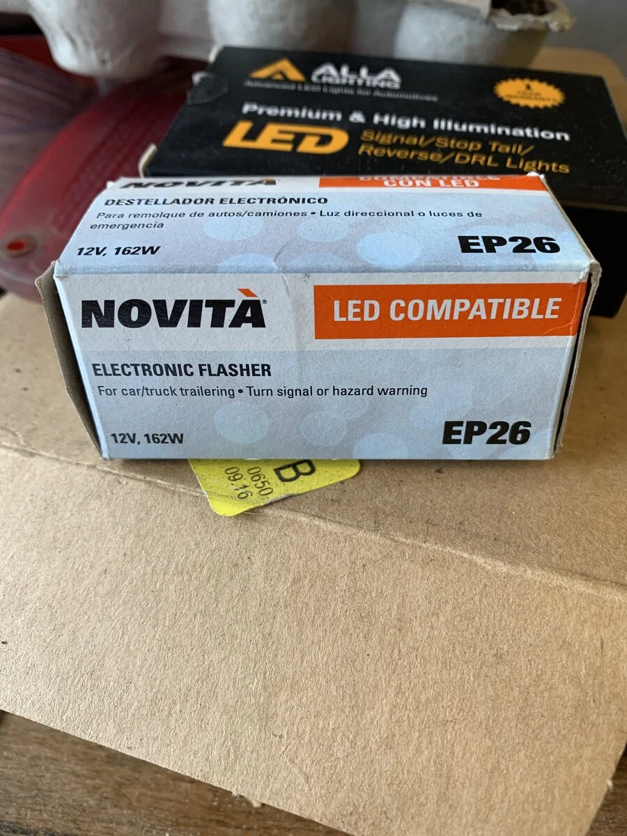

So I just finished installing all of my lighting. Here’s the order of operation:
1. Installed Alla LEDs in the front turn signals many months ago after replacing the one socket. Worked fine except for the hyper flash.
2. While the Jeep was out of commission, I installed Alla LEDs for the read brake/signal lights, as well as the reverse lights. Installed Zmoon LED headlights.
3. Replaced the side markers with standard yellow bulbs (for my clear covers). Again, these are not LEDs.
4. Installed a Novita EP26 LED flasher
Now, the turn signals will work when the headlights or parking lights are off. When the headlights or parking lights are on, the turn signals do not function. I connected halogen headlights, the issue was unchanged.
I removed the one front turn signal and replaced it with a standard bulb, and that signal now works with the headlights/parking lights on, but the rear signal is barely noticeable.
Any thoughts? Did I get a bad or crappy flasher relay?
Also, I reinstalled the original flasher. With the a halogen installed in the front turn signal, the signal works just with hyper flash when the headlights/parking lights on. With LEDs in all but the side marker, the signal still doesn’t work with the headlights/parking lights on.

I have a box of resistors, so I’m going to look up how to wire one in to see if that helps. I thought the LED flasher was supposed to negate the need for the resistor, but apparently not.
I have another EP26 flasher coming. I think the first one is defective. If that doesn’t work, I’ll pick up a set of standard brake bulbs test further.

With a new EP26 flasher, LEDs in the front signals, LEDs in the brake lights, non-led in the side markers, and LED headlights, I get the following:
Headlights on: no turn signals or hazards
Parking lights on: no turn signals or hazards
Headlights/Parking lights off: turn signals and hazards work properly
