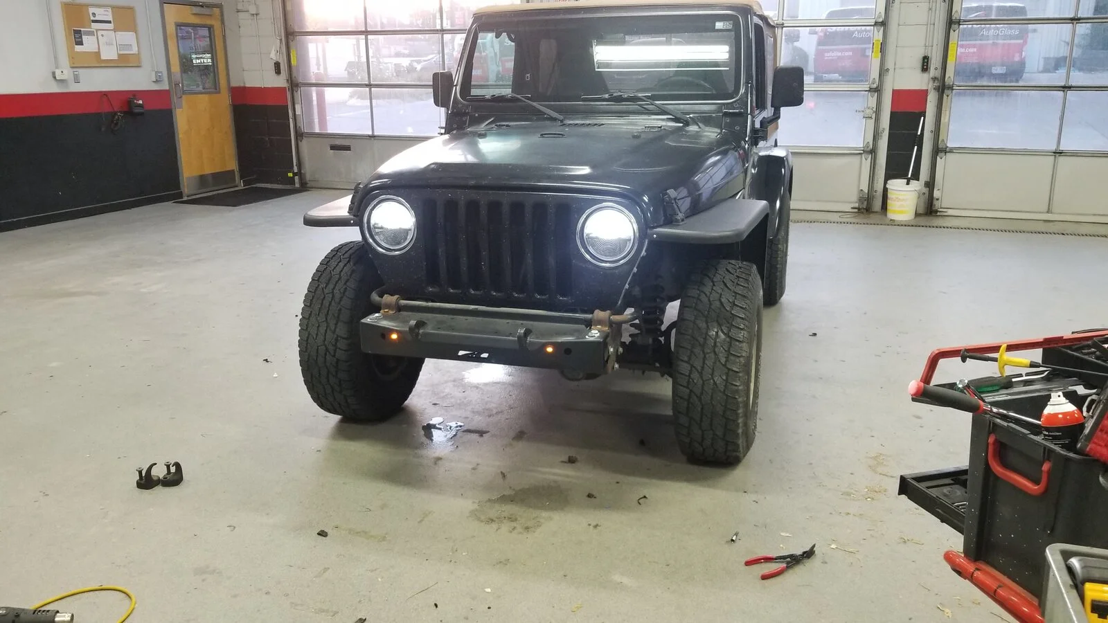

Ended up keeping my heated trucklights, even though I perfer a more yellow halogen..... Couldn't justify swapping them out after spending money on them 6 months ago. I did however install the mce fenders and used those led 3 wires above. Install a novika e27 or whatever it is to get rid of hyperflash. All lights work except the hazard. Relay freaks out when you turn on the hazard and just clicks like crazy. Turn signals are temporarily mounted in my Motobuilt stubby bumper since it had 3/4" holes in it and I was on a time constraint to get them in really quick. Obviously the oem fender cover alot more so plenty more things need painted and buttoned up.
