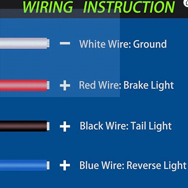

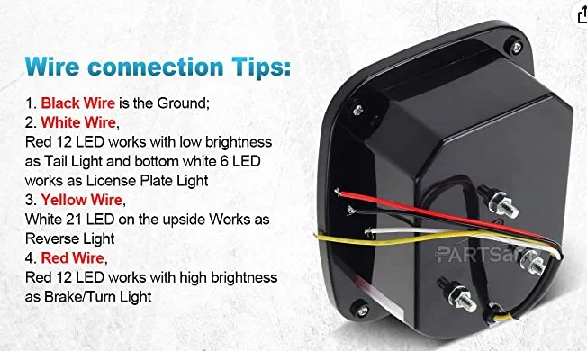

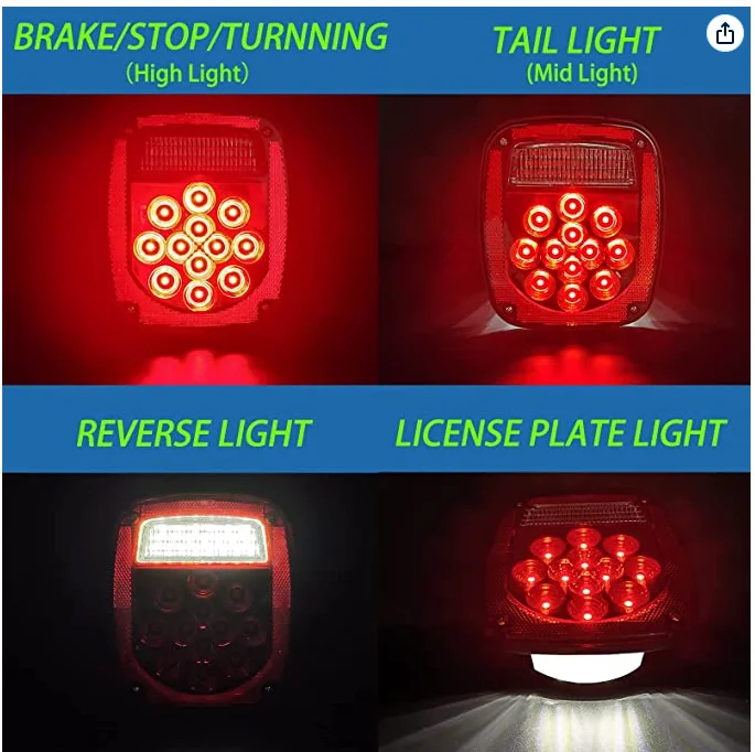

Every pair of cheap no-name lights I've ever seen has different color wiring for each function. There is no standard they follow.
I know you don't want to ring them out.........but it's 3 wires my man ⚡
A quick trip on Amazon show this to be true.
