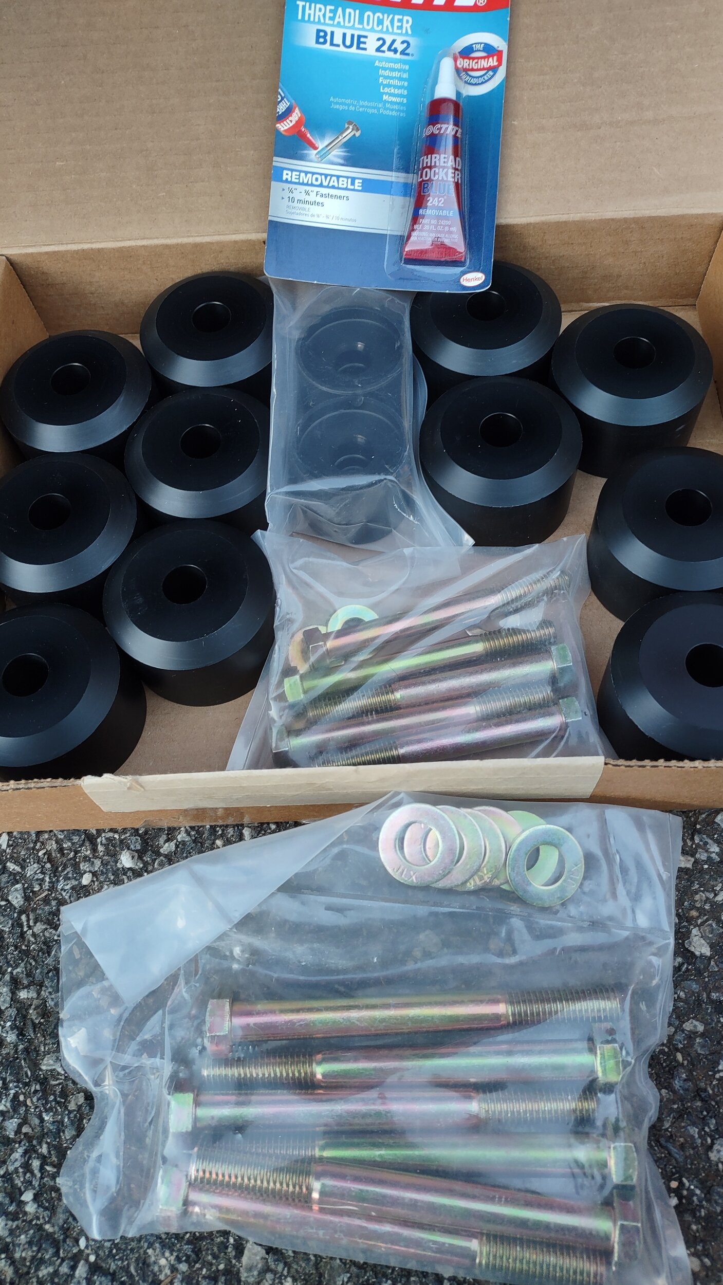

BMB BL.
https://blackmagicbrakes.com/ols/pr...its-97-06-tj-and-tj-unlimited-all-trim-levels
