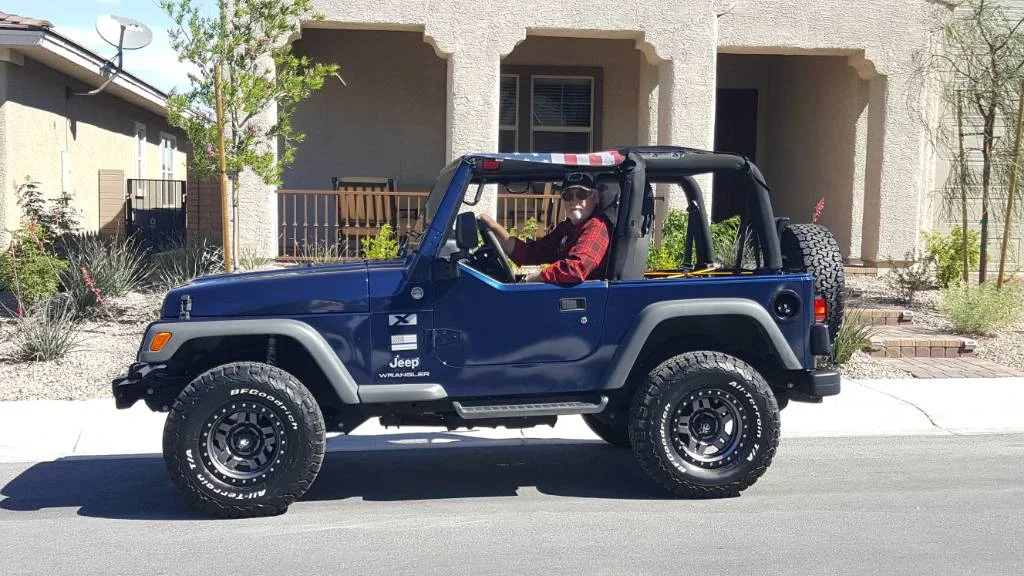

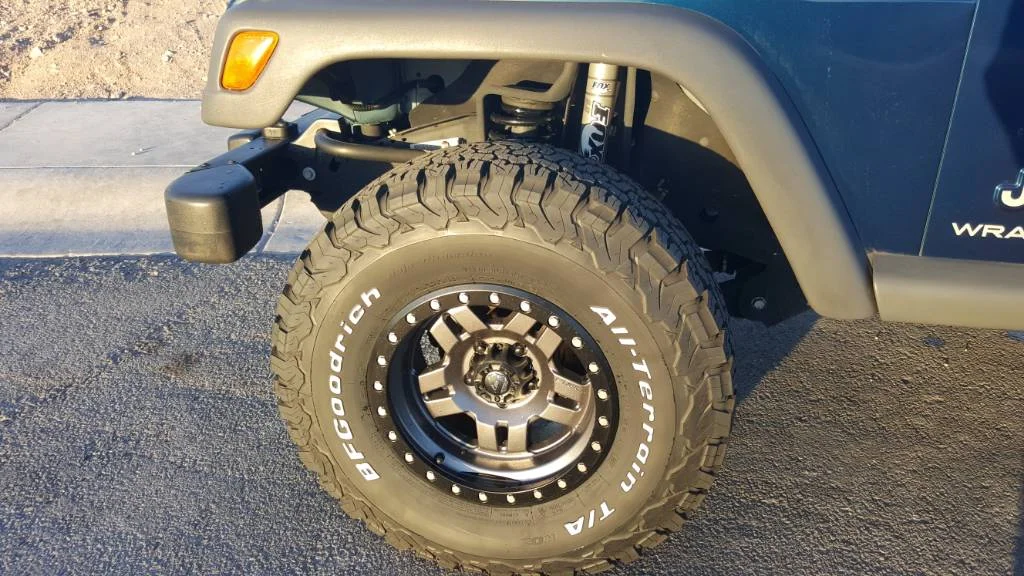

I did exactly that and love it! ProComp springs and Fox shocks and 31" All Terrains. From stock.
