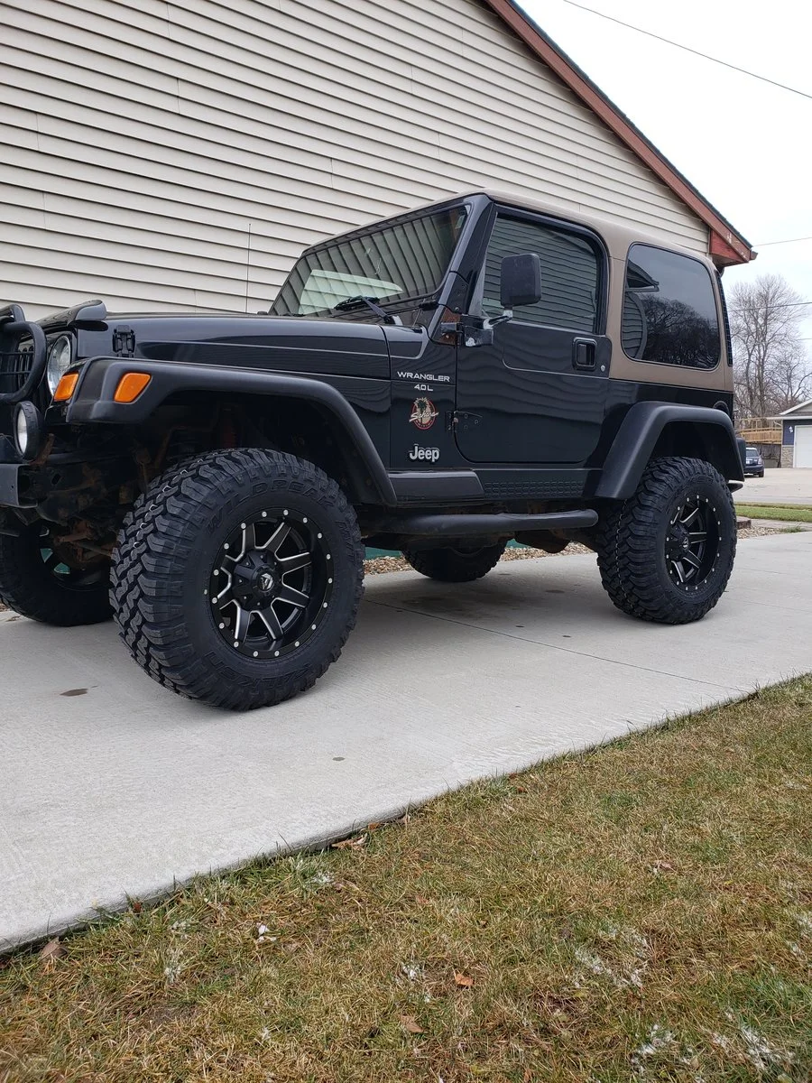

Mikepapesh New Member Joined Mar 28, 2020 Messages 3 Location Iowa Mar 28, 2020 #1 Just bought a 2001 tj a few months ago. I'm trying to figure out how much lift it has on it. Any ideas on how I can do this?

Jamison C Heil Savvy 🙋♂️ Supporting Member Ride of the Month Winner Joined Sep 1, 2018 Messages 3,441 Location Sedona, AZ Mar 28, 2020 #2 Stock springs are 12” in the front and 8” in the rear. Measure your current springs, and anything over 12” in the front and 8” in the rear is you current lift height.
