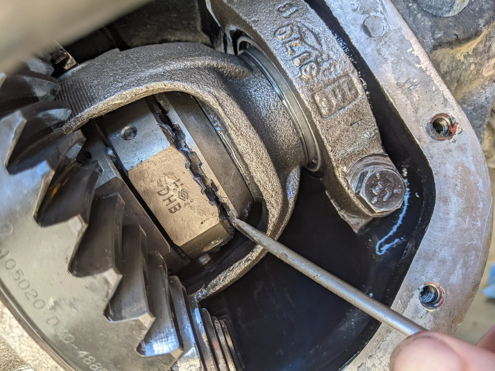

Followed instructions to a T. Clearance between drivers is 5/32" as specified. Install manual says it should unlock and click by manually spinning the tires, and it's not. I can move it with a screwdriver and it seems to be able to move enough to unlock. Wth?

It doesn't unlock using either test. I can manually unlock with a screwdriver but it won't do it by turning a wheel.

Pulled cover and double checked the pins and springs, they all appear seated and installed correctly.
I'm stumped and their tech support either isn't open on Saturdays or is too busy to answer/return calls.
Pulled the carrier back out and disassembled to double check everything. It all checks out.
I stand corrected. The 5/32" measurement is really closer to 3/16". My previous measurement was made with the ring gear on which made it hard to get my calipers into the gap.
Hard to understand how that measurement being ~0.010 out completely mucks up the whole works, but that's the only thing I have to go on at this point.
