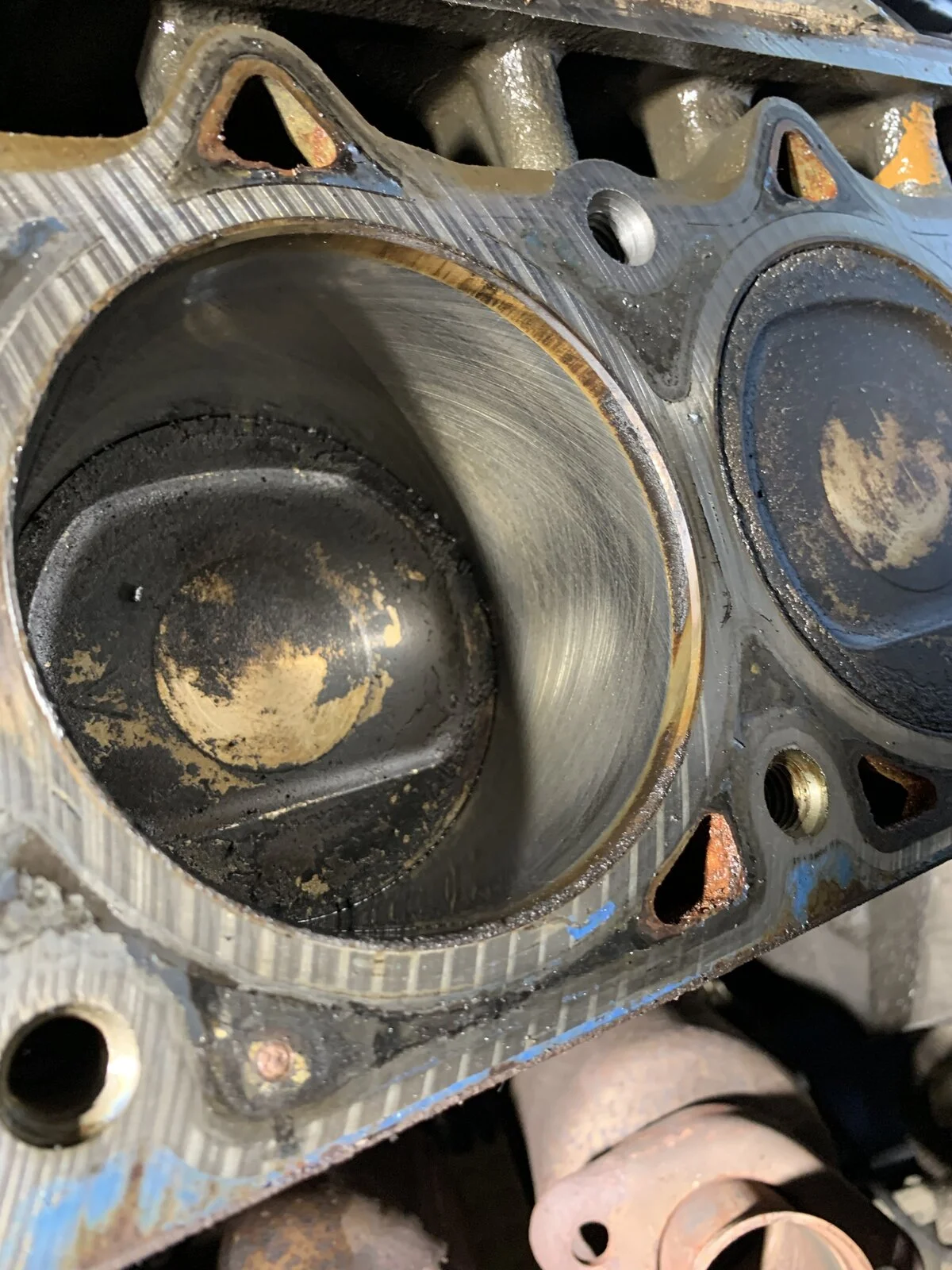

You guys scared me. We got the head off last night. Inside the engine (pistons, cylinders) looks impeccable - just a little carbon which we'll clean up. 142K and we can still see the cross hatching on the cylinder walls and virtually no wear ridge. We flip the head over and stare at the valves for a while and panic because they LOOKED fine. I pour acetone into the combustion chamber and around the valves, and boom... within a few seconds, it's dripping down the valve and out the exhaust port. Nothing horribly bad but definitely not sealing correctly. I think that explains why our compression test was OK but not the leak down. So, it looks like a leaky valve is the issue. Waiting on a new head from clearwater and we'll see for sure.

It always amazes me when I see the piston bores on the 4.0l. I've pulled 4.0ls engines apart at 200k+, where you could still see the factory cross hatching and there was no ring ridge. The most common issue is carbon deposit. I've also pulled them apart where I consistently used quality fuel system cleaners and the carbon build up was minimized. This doesn't look bad at all! Are you using new head bolts when you put it back together? Also, now's a good time to install new expansion (i.e. freeze) plugs, if you haven't already. Even the brass ones are cheap!
I've only torn apart a couple engines in my lifetime and was just floored to see the crosshatching. We've owned it since new and now it's my son's (he has the Jeep bug too). I've only used Mobile 1 and been faithful in our oil changes. We had the oil pan off and looked at a crank bearing and now the top end and everything looked great. I think after the new head goes on he'll essentially have a like new engine.
