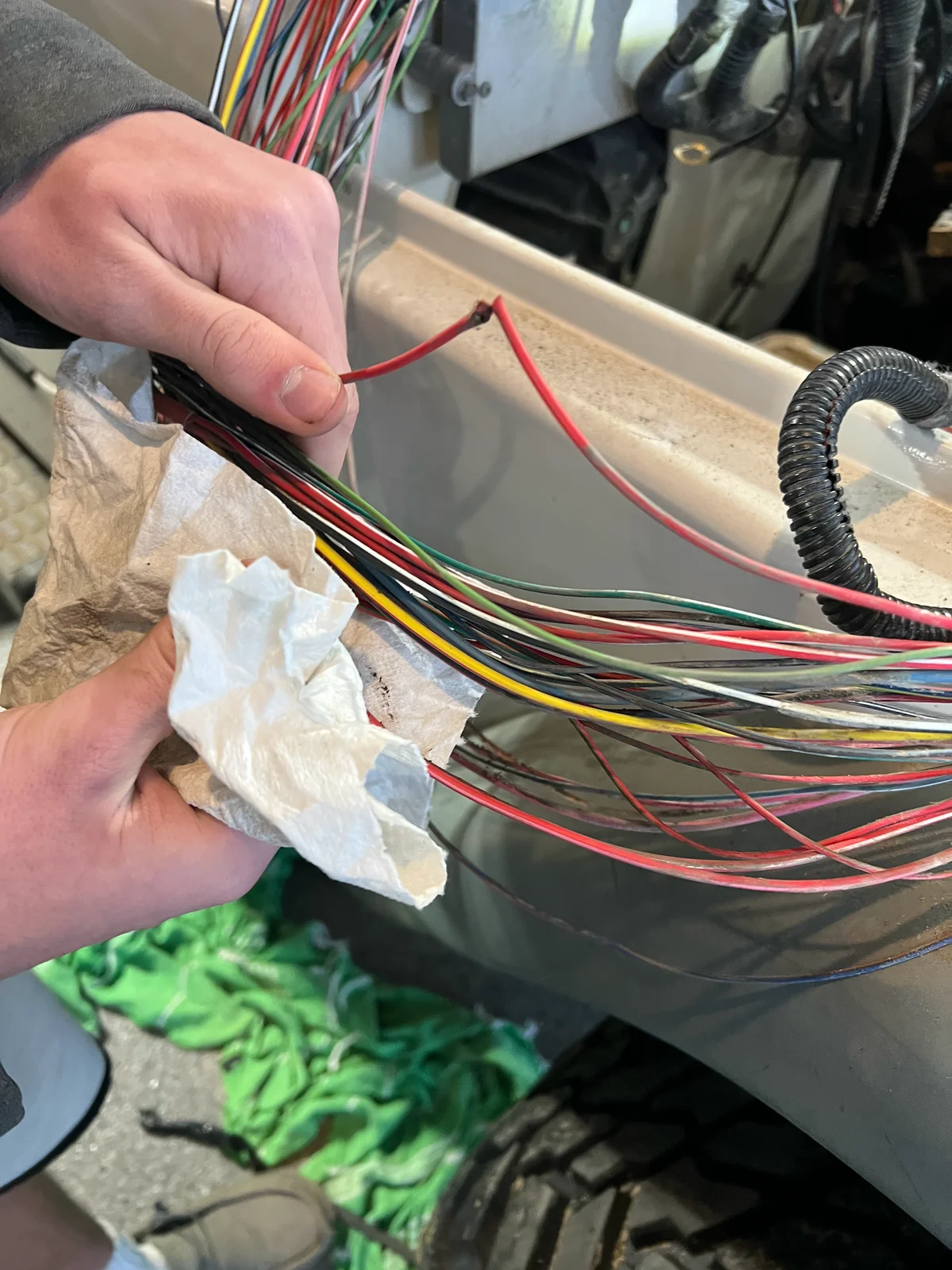

My son and I finally found the problem.
A red wire located in the wire harness behind the battery under the PCM. About 1 ft away from the distribution block. Everything is working 100% now.
Here's the above image in a non proprietary format that everyone can view:
