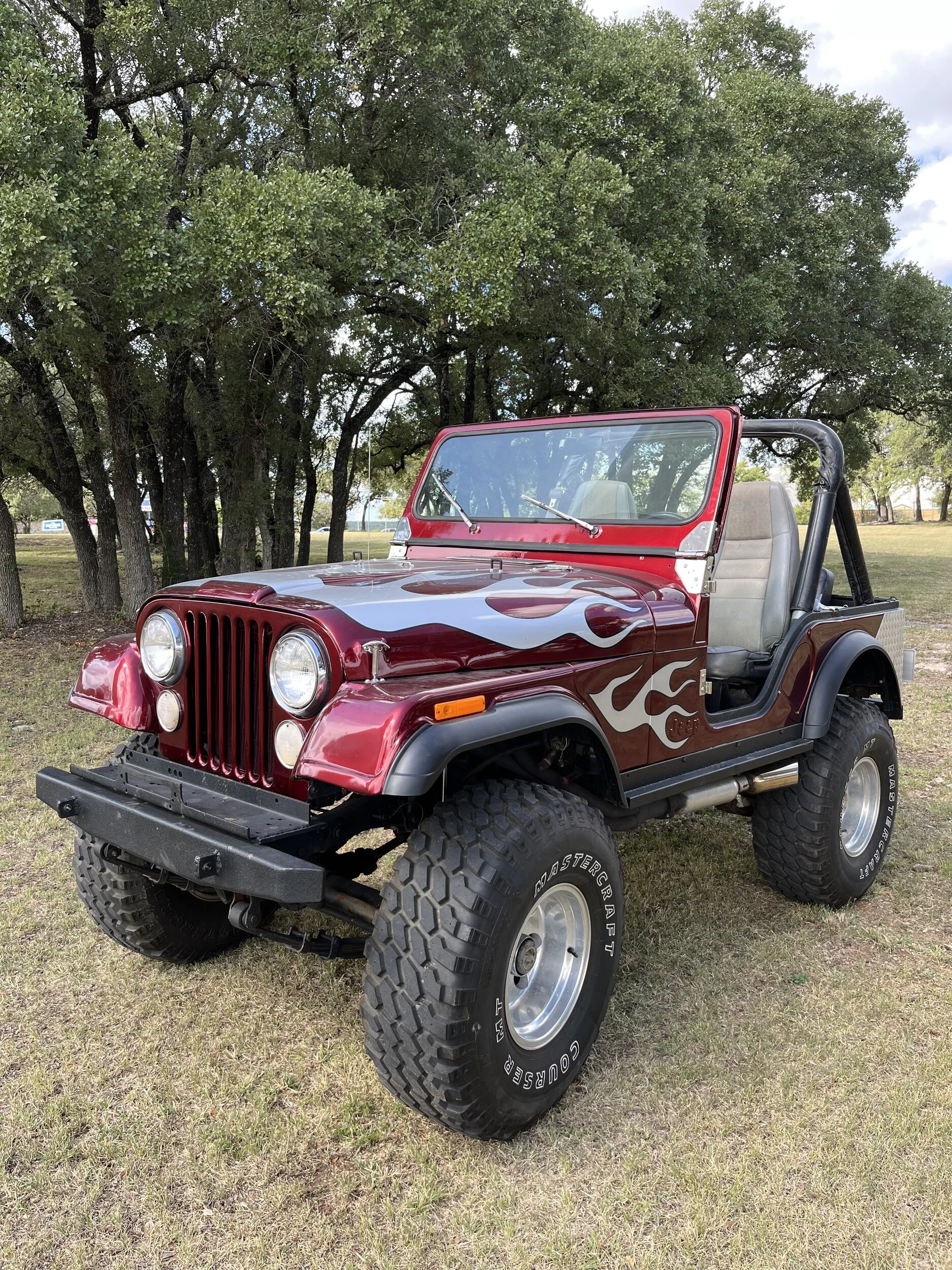

Just as an example, I have a CJ5 with 35’s and 6” lift I bought. Freaking Jeep was all over the road, drifting tracking badly, non stop work to stay in my lane. I added 6 degree shims to add Caster, and I drive it out doing 65 now no issues, tracks like $. You’re describing issues I’ve seen on 2 TJ’s a CJ and a JK that have been lifted, and adjusting the Caster was the biggest part of it.

My CJ5 isn’t on rails, ha, but it was crazy bad, and Caster fixed her up, I can roll 65 1 finger on the wheel ( I don’t drive like that, but I can)
