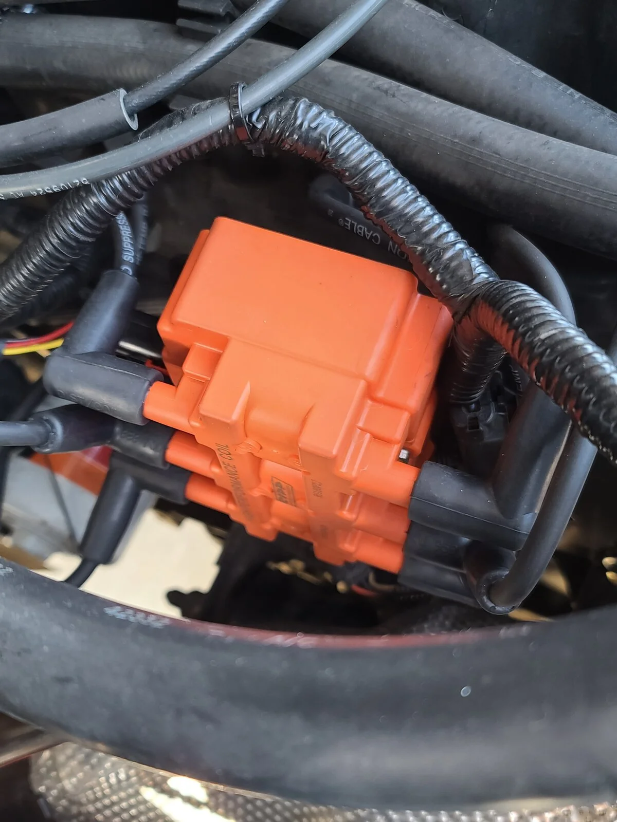

I installed a RIPP coil from K Suspension @ http://www.ksuspensionfab.com
Noticeable increased power and possible mpg improvement. Need a few more tanks to be sure on MPG. I'll do a post later.
I was able to fix all my issues ignition related. Smooth acceleration through 4500rpm. Great customer service. Couldn't recommend enough.
Oh and it look amazing. It's the orange thing.
