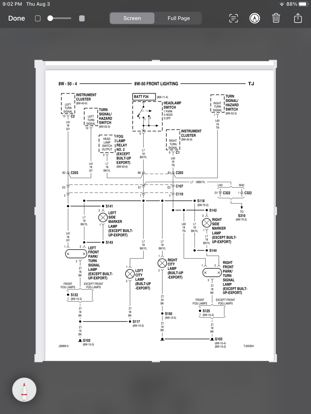

I got my 99 Sahara a few weeks ago and the right tail light and turn signal and 3rd brake light didn't work from the get go. I installed LED taillights and 3rd brake light and they still didn't work, so I used a self tapper and tapped a new ground on each side of the new tail lights and they worked fine. Here is the strange part. The turn signals work with the LED relay when the headlights are off, but when you turn the headlights on, none of the turn signals work at all. Does that mean I have a bad ground up front? Open to ideas on where to start my trace.

Sounds like you have an issue with the front lights. You may have to try a led in the turn signal up front. First I would cycle the hazard switch a couple times and retest. The front lamps there is a mod for the turn signal circuit if you search on line. The front marker bulb is a single filament and is wired one side to the turn signal and the other side to the parkIng lamps. When the running lamps are on 12v goes into the bulb then out into the turn signal circuit then down through the front lamp filament to ground. Then when the turn signal is turned on the 12v goes to the second filament in the front lamp to turn the front lamp on, at the same time 12v is on both sides of the side lamp causing it to go off. When the flasher turns off the front bulb turns off but the side marker turns back on due to the ground circuit going through the front bulb filament. This is why you see the front and side markers alternating when the head lamps are on. You can check the ground above the headlamps. Then I would look into a different flasher. I put leds in rear and just had to change the flasher to get rid of the fast flash.

Thanks, I have fought with it all weekend. Replaced the Headlights and the front Turn Signal and corner lights. When I was under it tracing those wires, I found where someone had cut off the factory fog light pig tails and left the wires hanging. I grounded each side to see if that solved the issues. Still haven't found the source of the headlight issues with the turn signals not working when they are on. They work every other time. Just not when the parking or headlight switch is engaged. My relay says LED on it. I double checked that, but Amazon has a disclaimer that says it is frequently returned, so that may be the issue. I thought it might be that the new one didn't screw into the steering column and complete a ground there, but it may be that the relay from Amazon isn't truly a LED EP26. I have ordered one from Extreme, since our local Auto Zone, Advance & O'Riley's don't seem to carry them at all.
