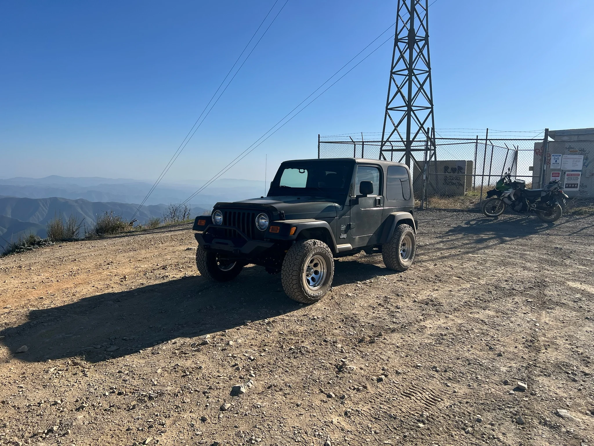

Finished the install on Friday and I gotta say, I love the way the front end looks! The downside…the back end sits about an inch lower than the rear and I didn’t even have the back seat in. I’m gonna have to do something about that, not sure if I’ll go for a spacer or a different spring would be better.
Drove it on a trail here in OC just to test out the new setup. I will say, even after airing down, I was getting rocked a bit! Back is sore but the views were spectacular.
