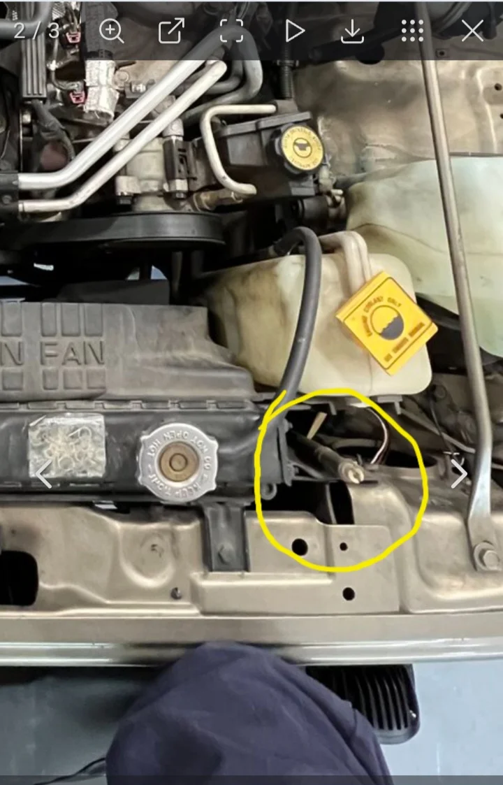

S salgarcia New Member Original poster Joined Sep 15, 2024 Messages 2 Location Denver, CO Oct 1, 2024 #1 Need your help! Does anyone know what this hose is called and where this hose needs to be connected to? Thanks everyone!
TurboTJ TJ Addict Supporting Member Joined Jan 5, 2019 Messages 1,208 Location Walnut Creek, CA Oct 1, 2024 #2 I believe it is the vent line for your front differential. Reactions: SPECWAR
JMT The Silver Fox 🦊 Supporting Member Ride of the Month Winner Joined Feb 27, 2017 Messages 27,641 Location 🌎 Oct 1, 2024 #3 salgarcia said: Need your help! Does anyone know what this hose is called and where this hose needs to be connected to? Thanks everyone!View attachment 562376 Click to expand... Breather hose. It’s doing what it needs to do right there. Reactions: Gilaguy23
Duck Doctor TJ Enthusiast Supporting Member Joined Sep 3, 2020 Messages 707 Location Ventura County Oct 1, 2024 #4 Differential breather hose. Connects to the top of your front differential.
MountaineerTom LJ Enthusiast, Retired USAF Weapons Loader Supporting Member Ride of the Month Winner Joined Sep 25, 2018 Messages 6,257 Location Sumter, SC Oct 1, 2024 #5 Make sure it is actually connected to the front diff. Reactions: macleanflood
macleanflood I break sh!t Supporting Member Ride of the Month Winner Joined Jul 24, 2021 Messages 11,920 Location Fall Creek, OR Oct 1, 2024 #6 MountaineerTom said: Make sure it is actually connected to the front diff. Click to expand... And not cracked, checked or broken. 20 year old hose just crumbles. -Mac Reactions: MountaineerTom
JKP TJ Expert Supporting Member Joined Aug 20, 2020 Messages 3,091 Location Warner Robins GA Oct 1, 2024 #7 And it's missing the dust cap that should be on the end.
