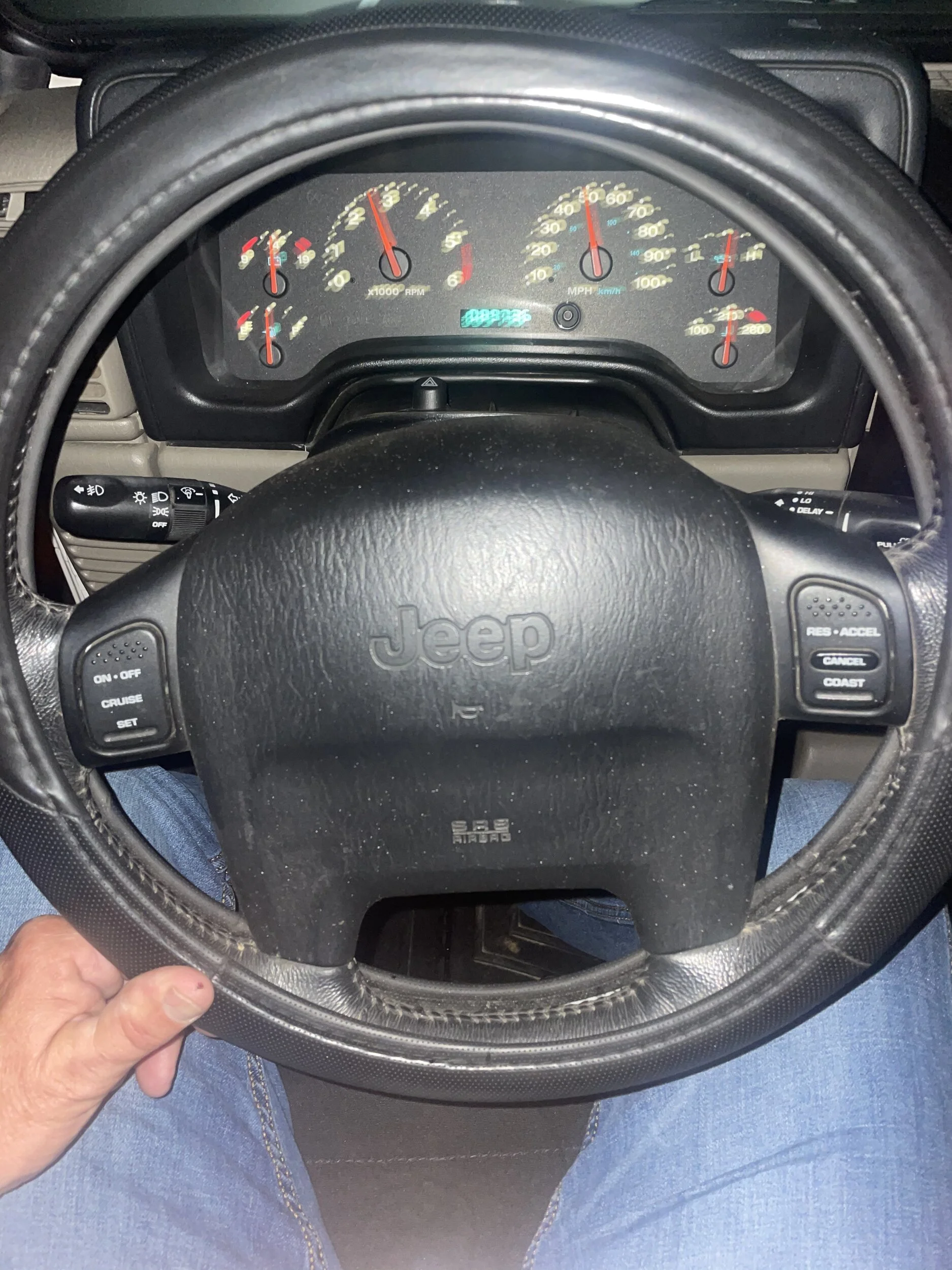

This is the Clayton rig, it was late and I was alone on the road for the pic in motion.
