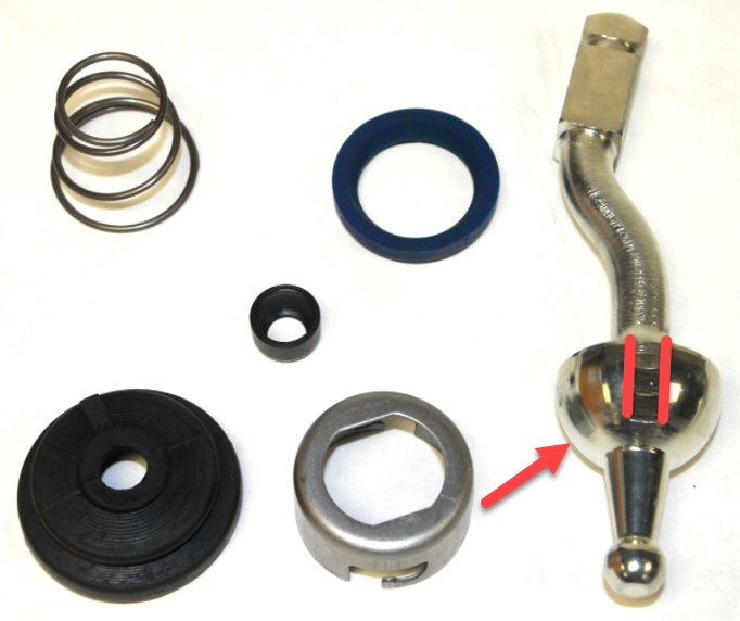

Once you get the inner shifter boot removed and prior to installing the new boot; check the tightness of the (4) shifter bolts. When I replaced the boot on my '01; I found the (4) bolts quite loose. After tightening the bolts; I found the shifter slop was gone....
Reactions: DWR
THIS, I had a similar sloppyness issue, and this fixed it as well.
If the shifter bolts are tight, the spring is fresh, the oil seal is new, the bushing on top is not notched/worn and finally the ball is smooth and the slots are straight like the photo below; then you should have a very firm shifter.

I was actually planning on buying this kit https://www.allstategear.com/Jeep-AX15-Shift-Lever-Kit-5252042-p/5252042.htm which looks like is the same as your first picture, I just wanted to inspect everything prior to ordering to make sure it’s what wrong/needed.
