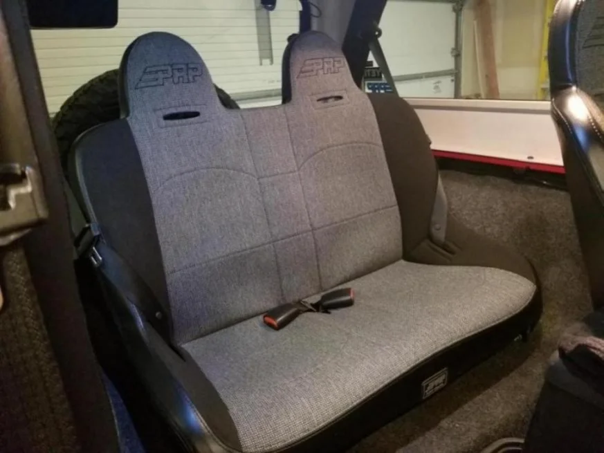

I have two kids under 5 and need to make the back seat safe enough for them. Currently they are in car seats that hook in, but the oldest is close to a booster. I’ve noticed two things that seem to matter:
1. The seatbelts don’t lock when jarred
2. There’s no headrests
I’m okay accepting some risk, but would like to make it more safe. What options are there? I’ve seen both the bestop rear seat and PRP that have headrests, what else is out there?
Those are the only 2 that have headrests that I know of. The seatbelts not engaging when a sudden motion happens is something you need to fix. A new seatbelt pair for the rear isn't a ton of money and would be an easy fix to give you some additional safety.

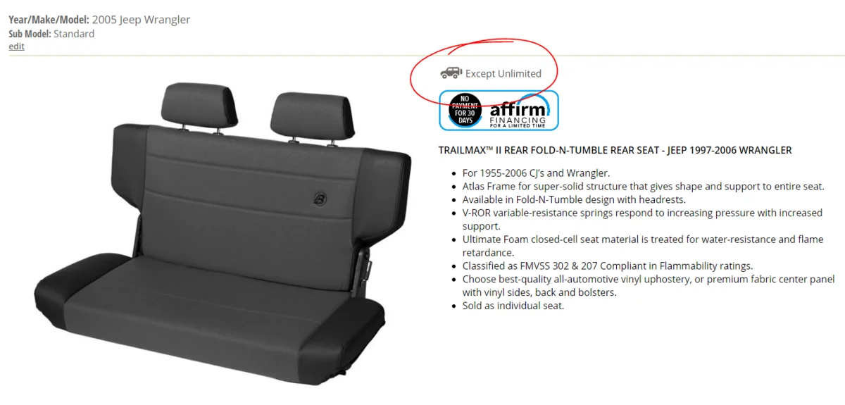

I looked at that before but then noticed fine print... Not certain why it does not fit LJs and did not investigate further

I know there’s a DIY headrest thread on here somewhere...
Also Prp will add a headrest.

I overlooked that, glad I didn’t buy one yet. Though I thought the brackets were the same - I may need to email/call bestop to find out.
Found this in the Q&A on Amazon:
Question:
can anyone tell me why this wont fit the unlimited model?
Answer:
Its the way that it mounts in the LJ, the floor mounting brackets nor the striker plate fit correctly, like they do in the TJ. We've tried to install this seat in an LJ and were unsuccessful. Anything can be modified, sure, we wouldn't be able to assist with that, however I can say that you'll be doing some drilling if you want this seat in your LJ.
A manufacturer
Manufacturer · April 10, 2019
