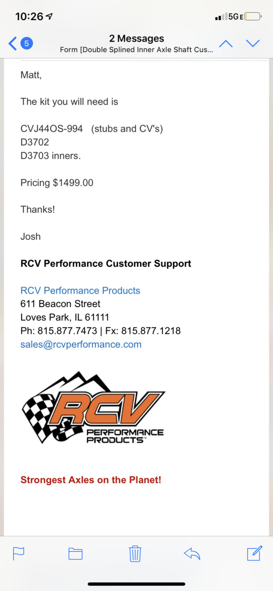

I'll likely end up doing that. I'm just hoping someone here has RCV axles and manual locking hubs so they might be able to give me first hand info.
Otherwise yes, I will just call RCV.
The Yukon manual hub kits require new outer axle shafts due dimensional changes required by the elimination of the unit bearings and changeover to tapered bearings and races. I'm certain that you will need new outer axles from RCV because you are not using conventional u-joints. I'm just as certain that RCV will have experience supplying the correct outer axle for the Yukon hub conversion and can tell you exactly what you need.

Those are the part numbers I was provided when I called inquiring about the rcv axles for the 5x5.5 Yukon kit. It’s my understanding the stubs are the 9.94 GM stubs.

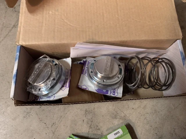

If anyone is looking for a set of spares of the Yukon locking hubs for the 5x5.5 kit I have a brand new set in the box, + complete sets of bearings for both sides, and two sets of seals for both sides. I had these as spares when I did the conversion on my Lj and I sold the Jeep. $300.00 plus shipping.
