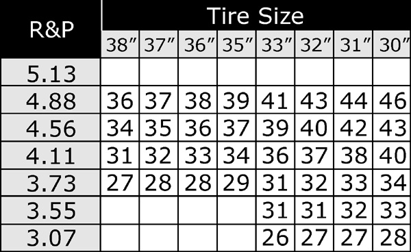

Speedo is way off after gear change, reads 80 at 65 via GPS. It currently has a 36 tooth gear installed. So...,
80 x .19 = 15.2
80 - 15.2 = 64.8, close enough
36 x .19 = 6.84
36 + 6.84 = 42.84, round up to 43
So I need a 43 tooth speedo gear
Sound correct? If way off I won't be offended, I am no mathematician :confused:
All we need to know is what size tires and axle ratio you're running to give you the right speedometer gear tooth count to recalibrate your speedometer. :)
31 and 4.88
Based on that you need a 44 tooth speedometer gear. This chart is known accurate and has been GPS verified. Don't pay attention if you see a chart on Quadratec that disagrees, they've had not 100% accurate chart on their site for many years now.

I can get a 43 so that should be close enough.
