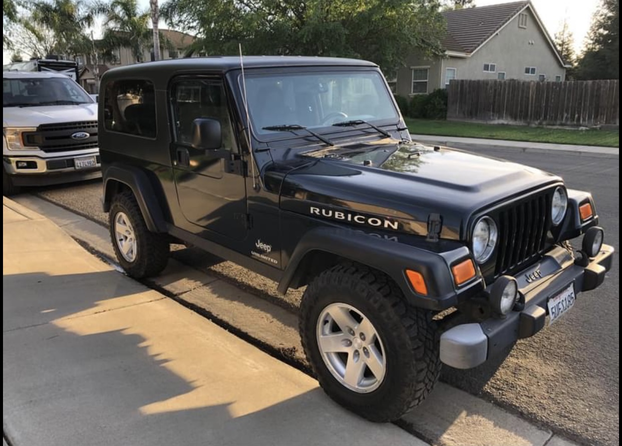

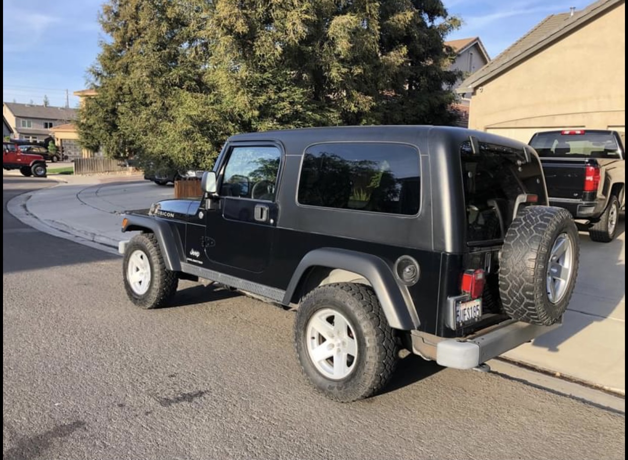

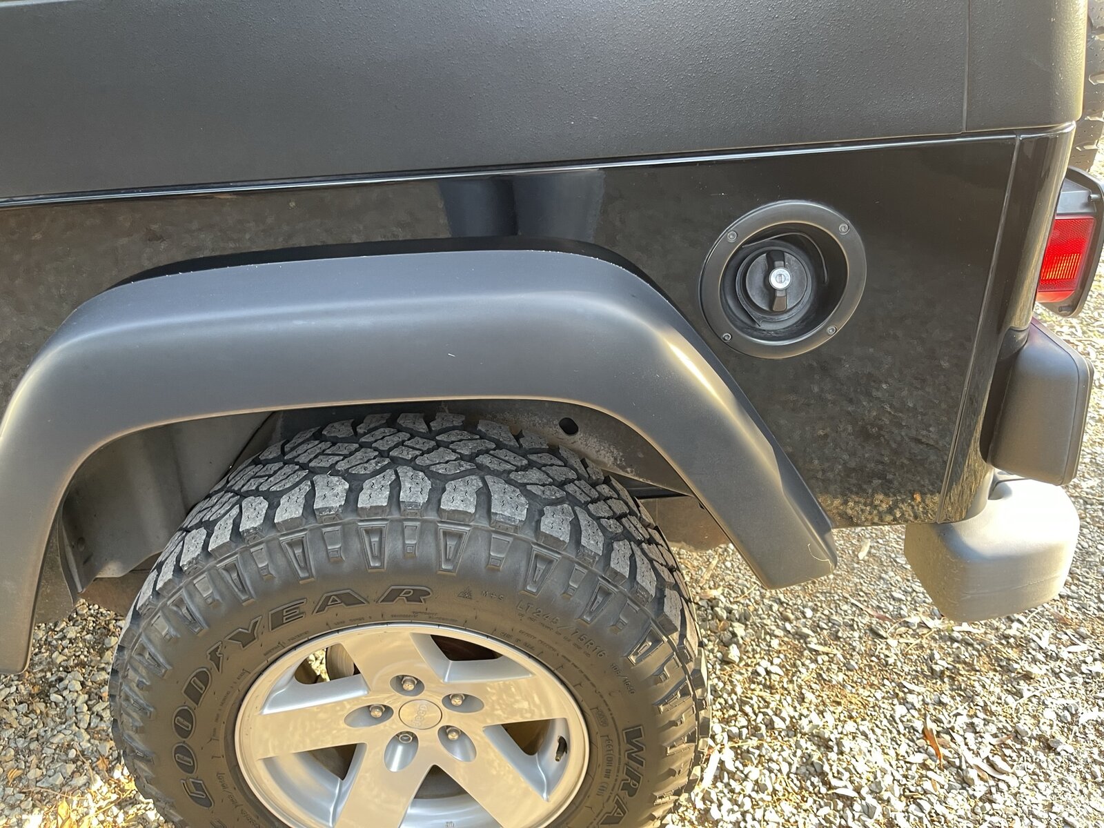

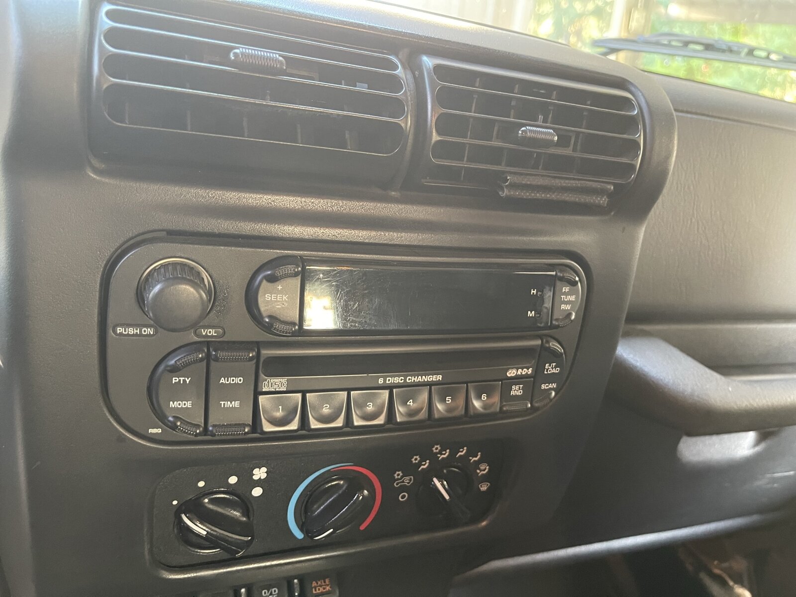

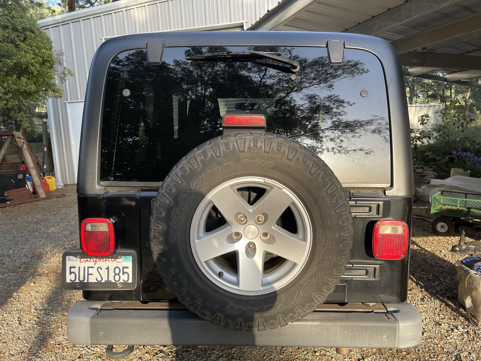

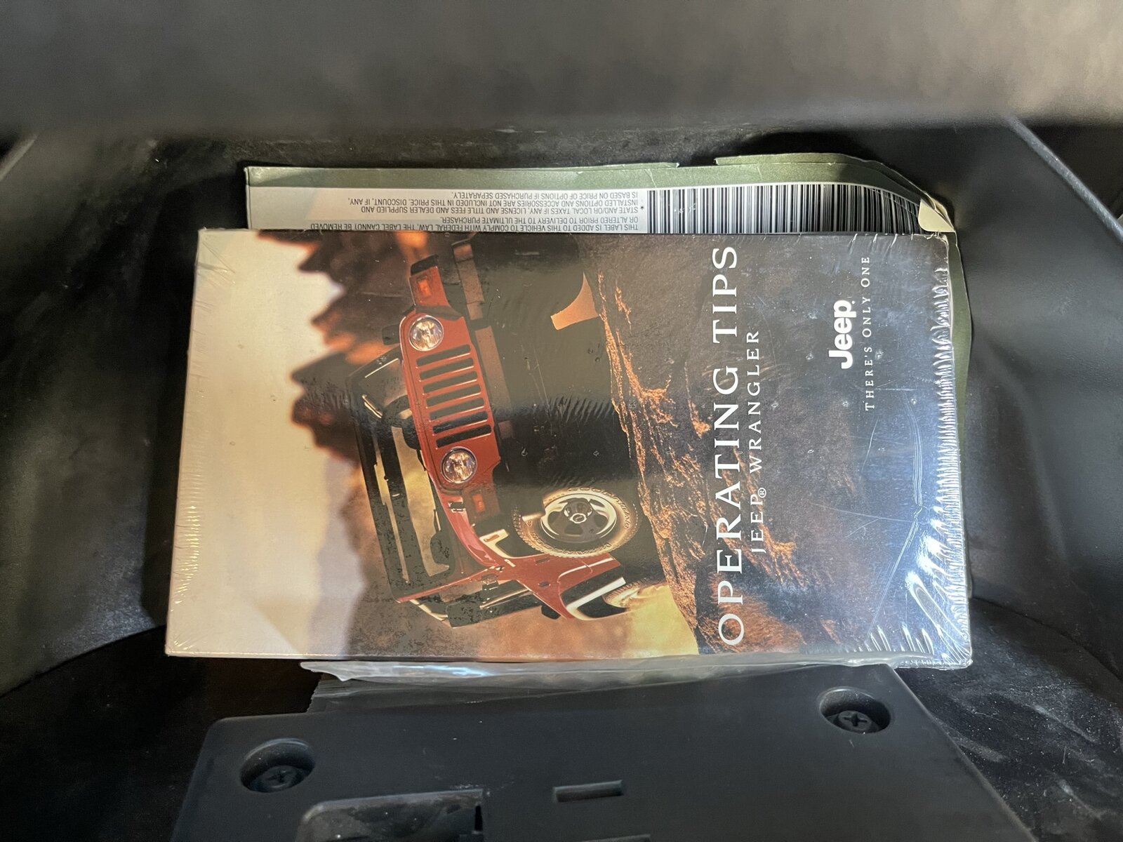

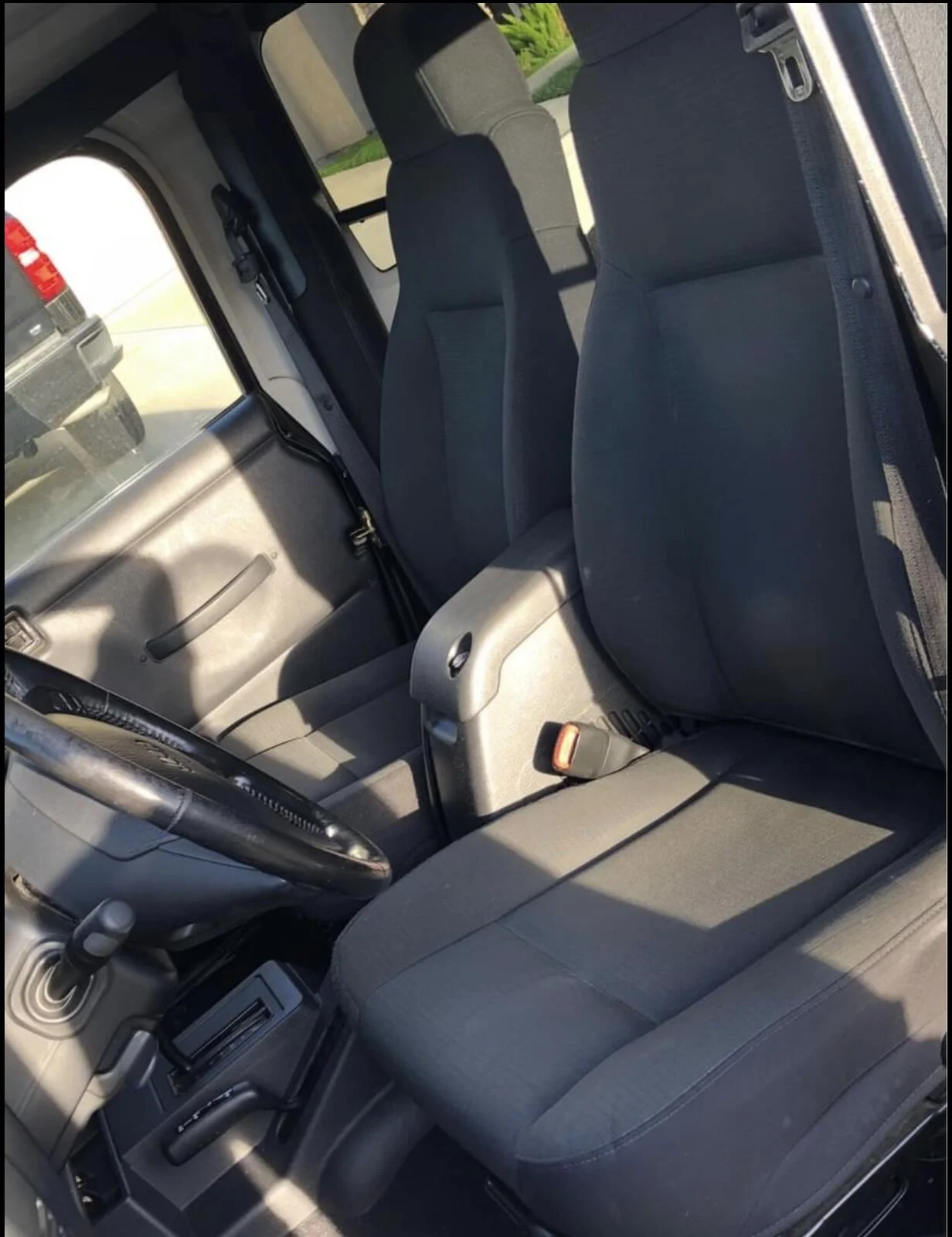

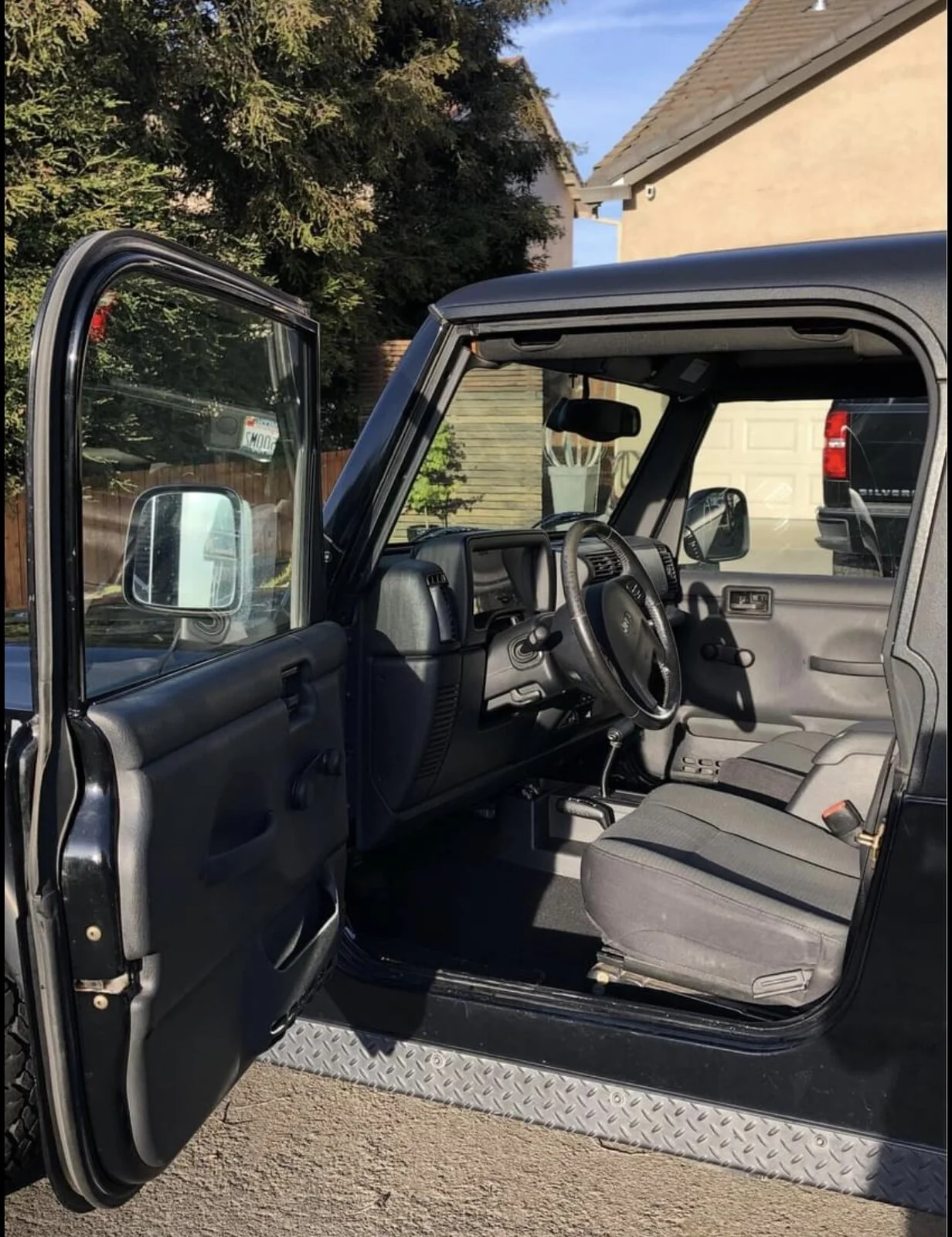

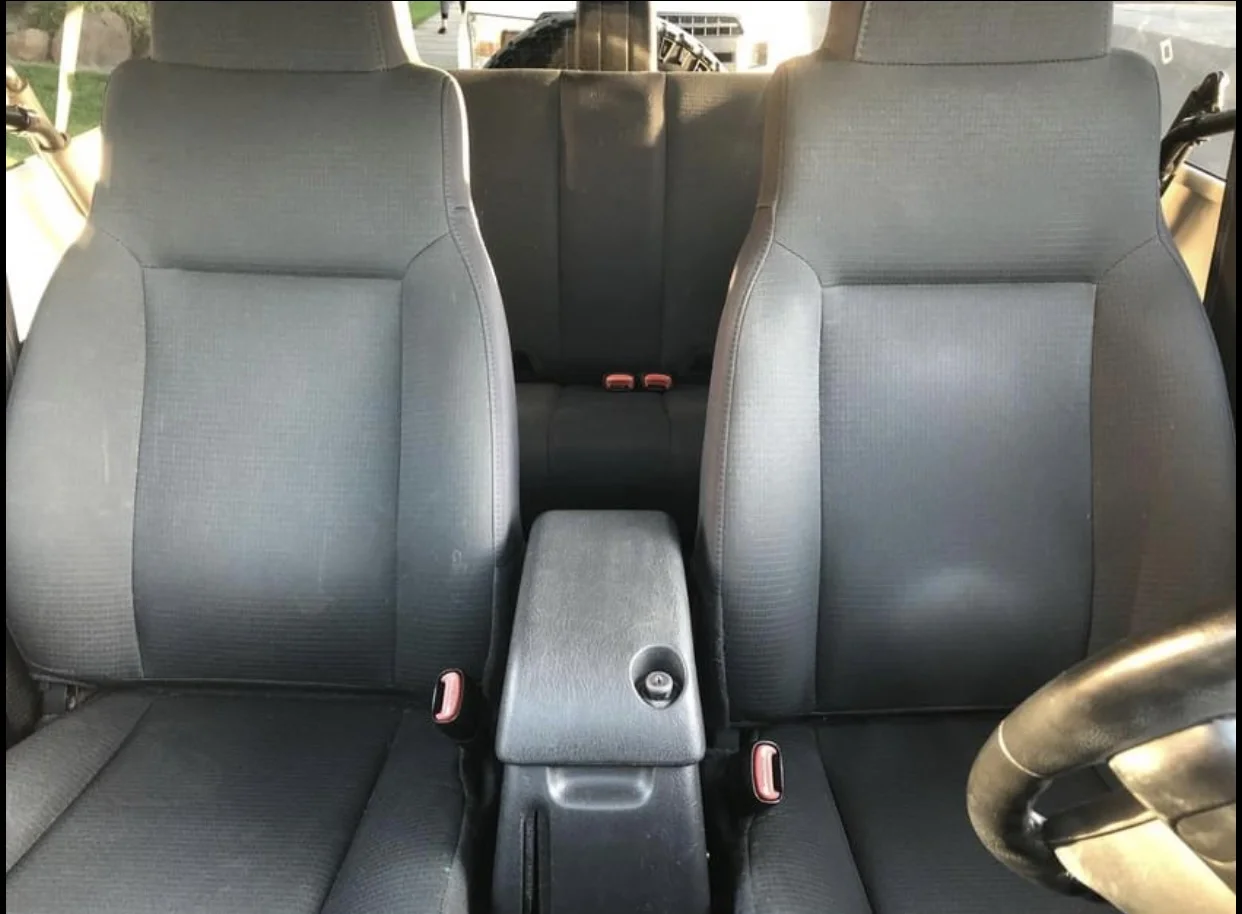

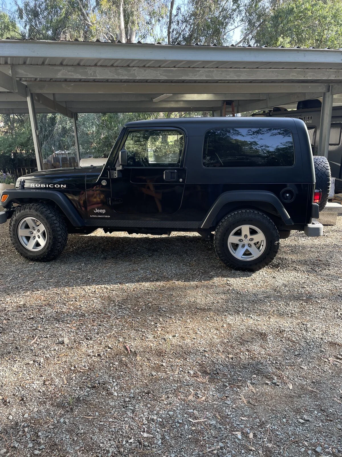

So there’s another Jeep in my life. It was just picked up about an hour from my parents house yesterday.
I blame most of this on @Irun I saw his Jeep for sale and it kept nagging at me. “Ya know that would be great for my parents” I kept thinking. We have been looking for another vehicle to keep at their second house near us in Utah. They want something they can drive around when they fly in, and something they can hit some trails with us and explore with. Also the wife and I have been wanting another Jeep so we can have two vehicles to go out with when nobody else wants to. We tried to find a way to buy @Irun jeep but the shipping was just way too expensive for that to make since.
So I did the dangerous thing and text @Alex01 and me and him started searching for a Jeep, he found what seemed to be a nice 2006 LJR Automatic in Black near my parents house in California.
It was the ladies first car she has had it for 17 years. It has never been in 4WD or in the snow. What is crazy is the factory soft top is still in the back and has been back there the WHOLE TIME! She has never even removed the hard top and been stacking her groceries around the soft top all these years. Garage kept about 16 years of life and never been on a dirt road.
She had it listed for $22,500 + $1000 for the soft top. They were able to get it with the soft top for $20,000.

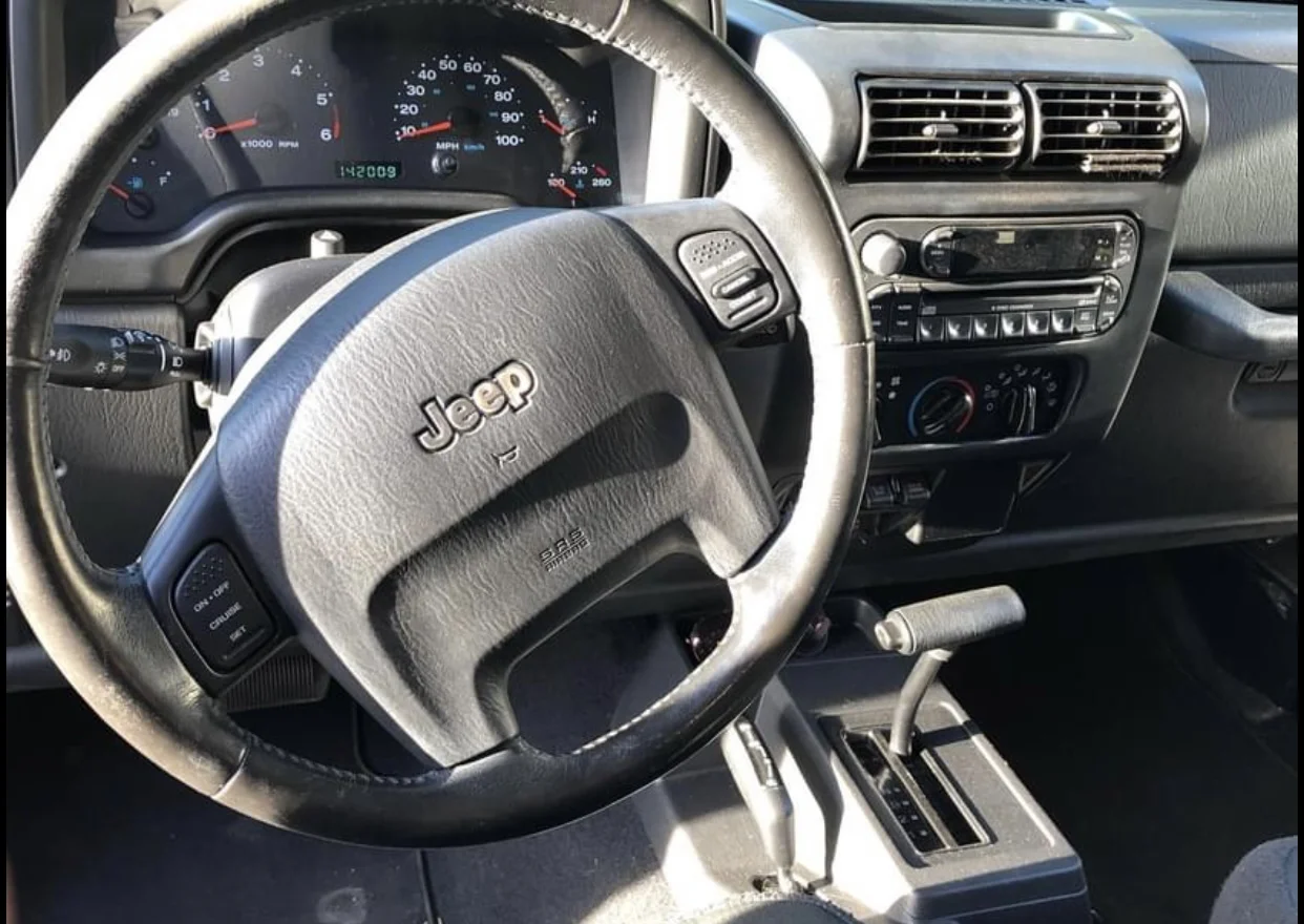

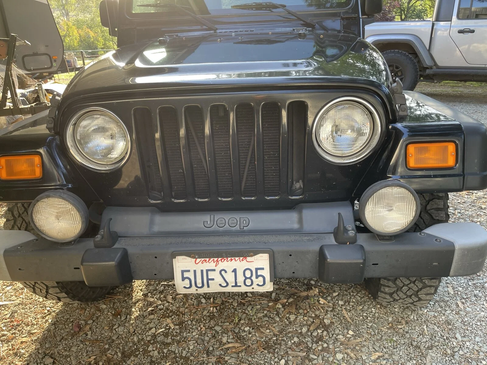

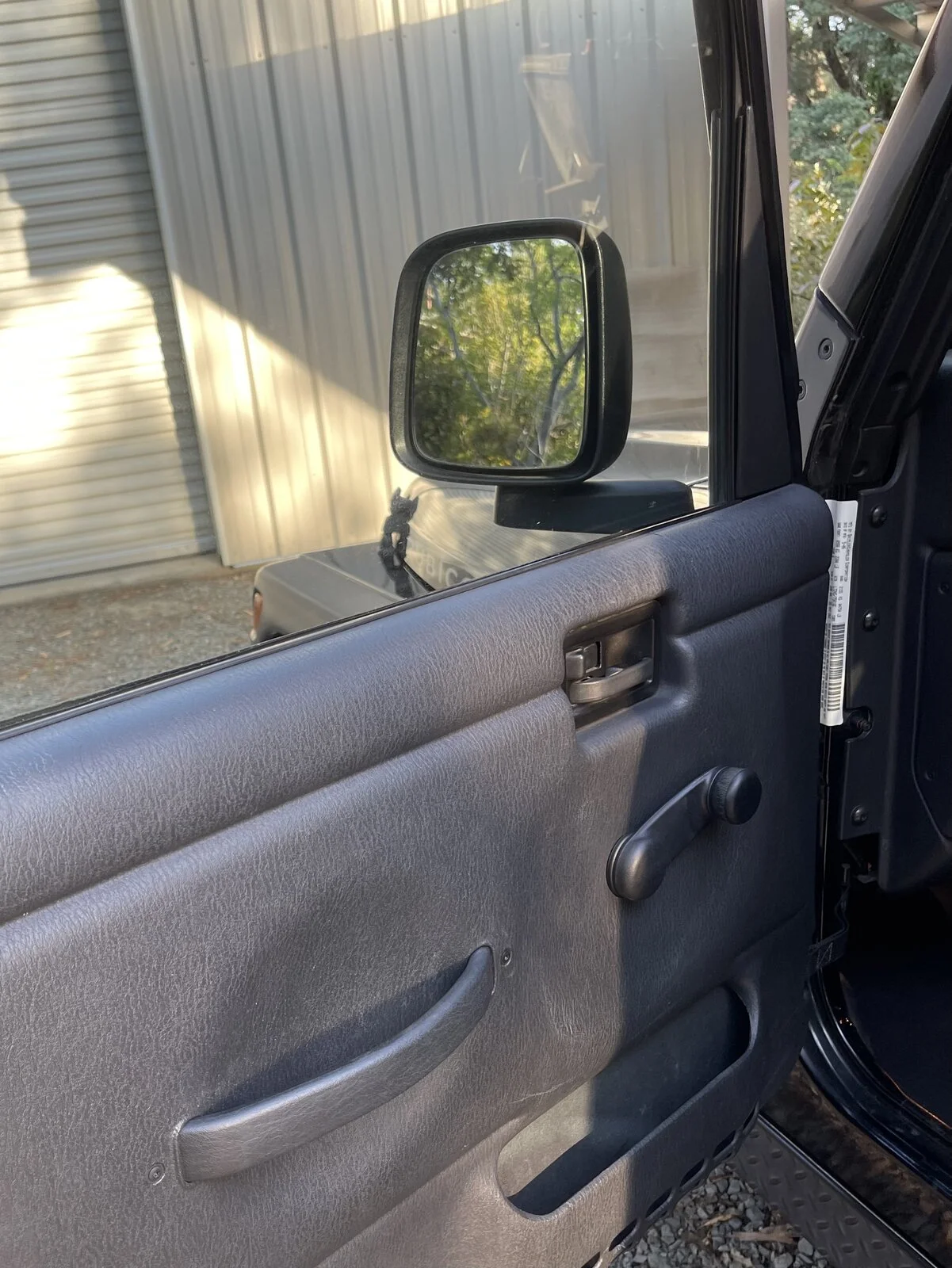

It’s an automatic with 142,000 miles and has a hard 1-2 shift before it’s warmed up and a few cosmetic problems. Little

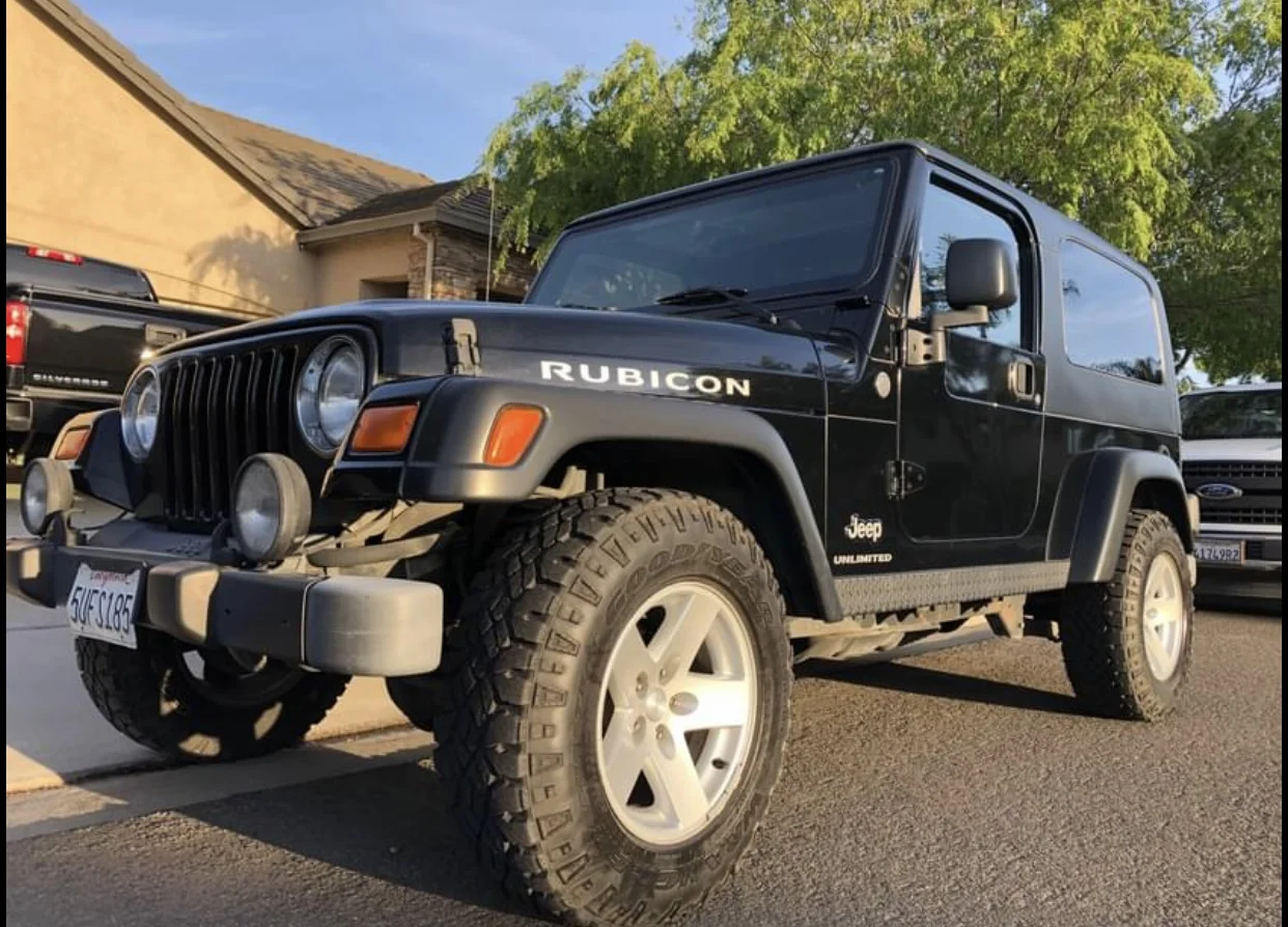

Rust on one of the door handles, cracked fog lights and footman loop, dad said couple of cracks in the door panels as well from sun damage.
Overall we are happy with the price we got it for in the current market. The lady has done some regular maintenance like oil changes etc. But we are a bit concerned about everything else. She kept it very clean, and always got oil changes done etc “and whatever else” the dealer told her but didn’t know much about it. So it could have been really well maintained or maybe the diff and transfer case fluid is all original. We don’t really know, very sweet lady but not very mechanically inclined. I will say it’s probably better than the other kind of owner that thinks they are an expert. She said she had the transmission service about 10k miles ago and the guy stripped one of the skid plate bolts. I am sure he was an impact gun monkey.
My dad drove it home 80mph on the freeway said it drove great, straight no shimmy etc.
It pretty much feels like an old barn find you hear about with all the pros and cons of that.

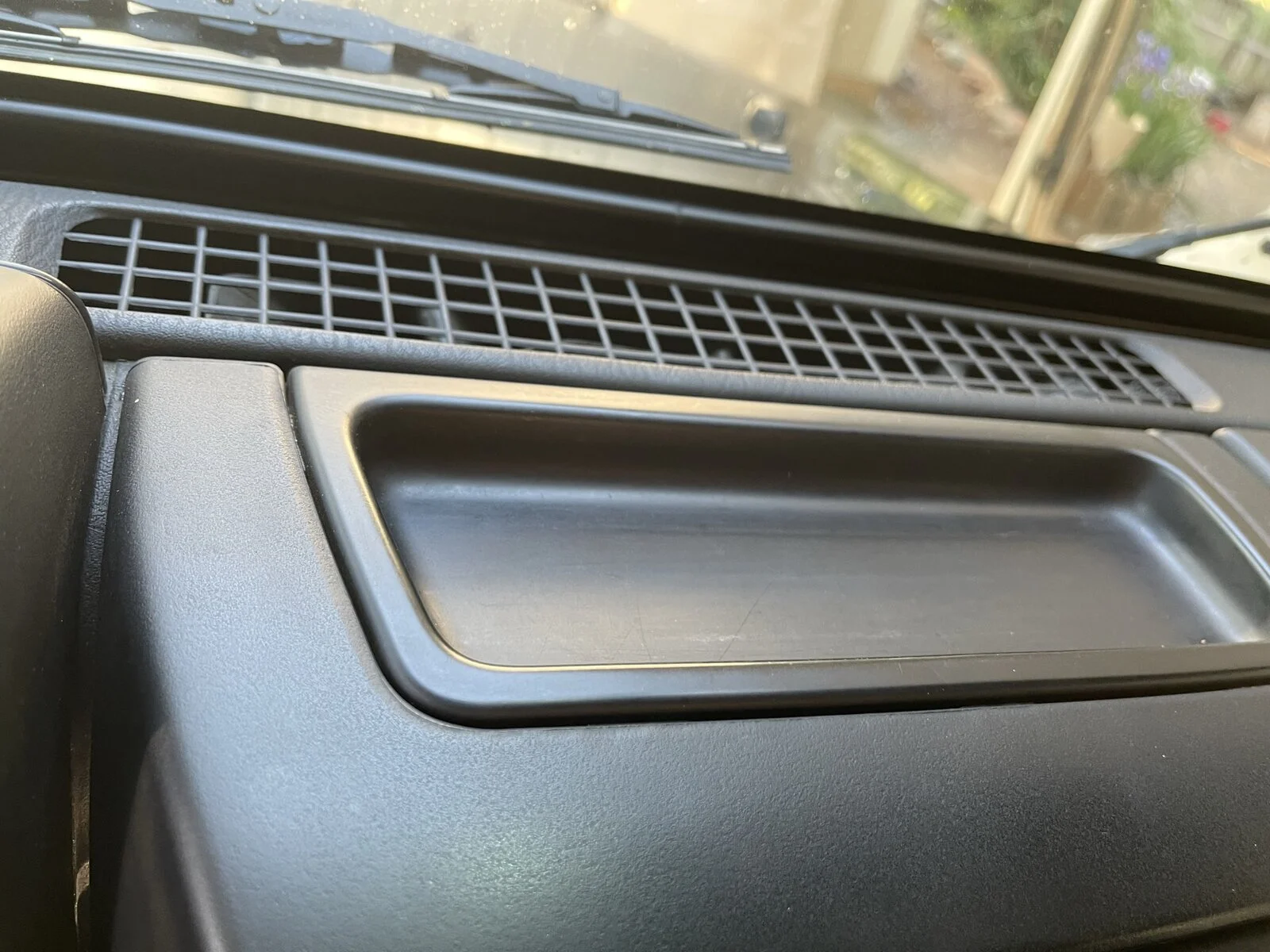

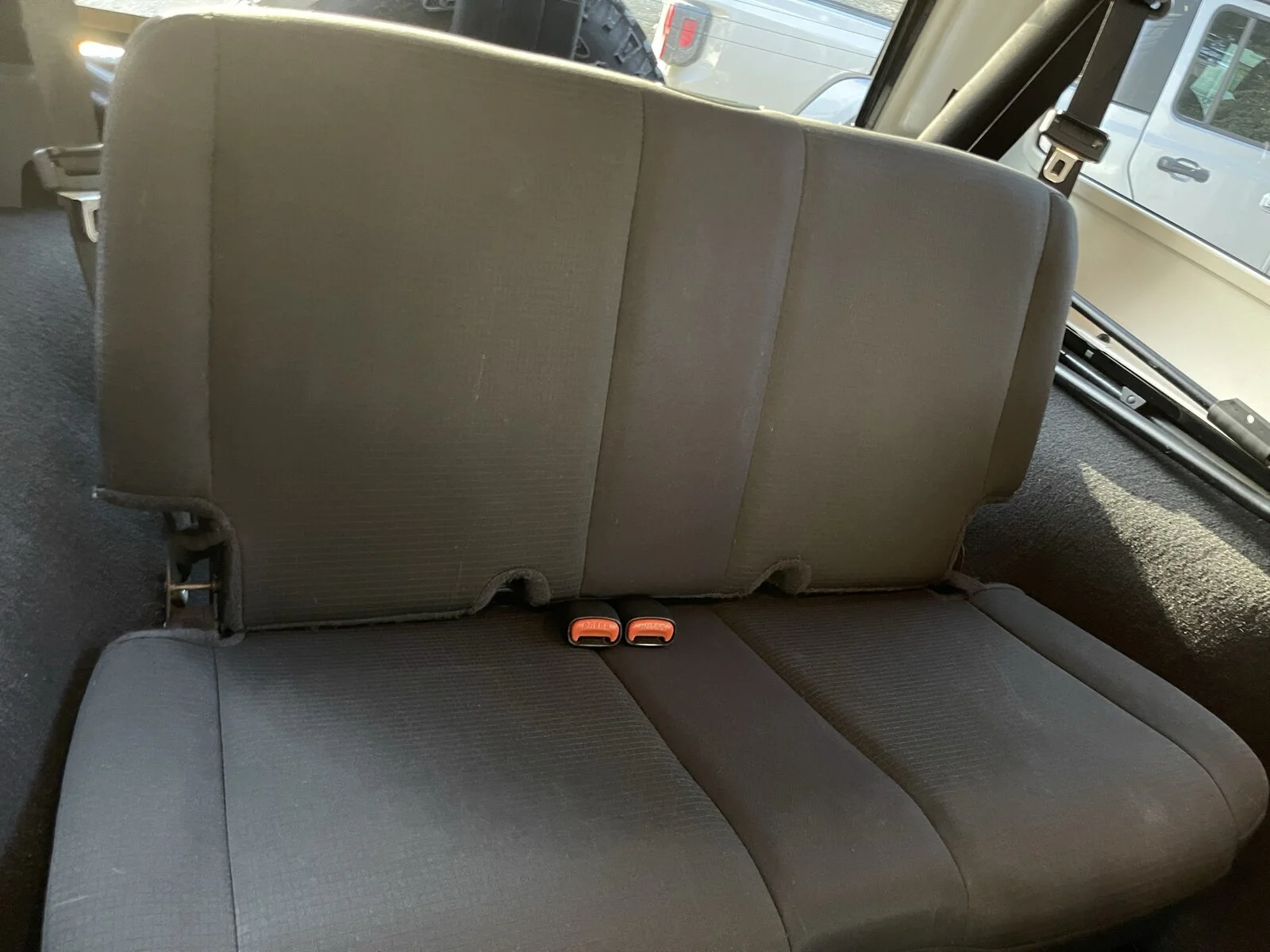

Photos below, still has all the factory manuals etc. my mom is not the best photographer around so many are a little crooked lol.
She had it listed for $22,500 + $1000 for the soft top. We were able to get it with the soft top for $20,000.

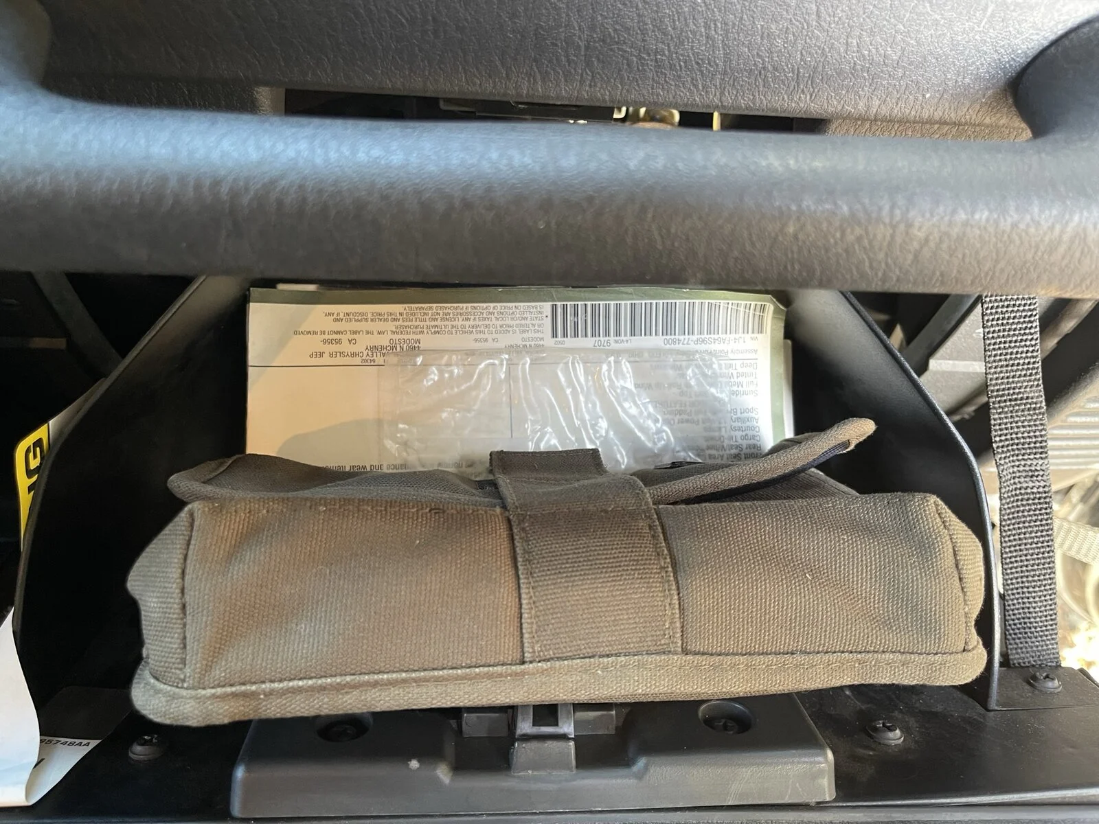

View attachment 325278View attachment 325279View attachment 325280View attachment 325281View attachment 325282View attachment 325283View attachment 325284View attachment 325285View attachment 325286View attachment 325287View attachment 325288View attachment 325289View attachment 325290View attachment 325291View attachment 325292View attachment 325293View attachment 325294View attachment 325295View attachment 325296
