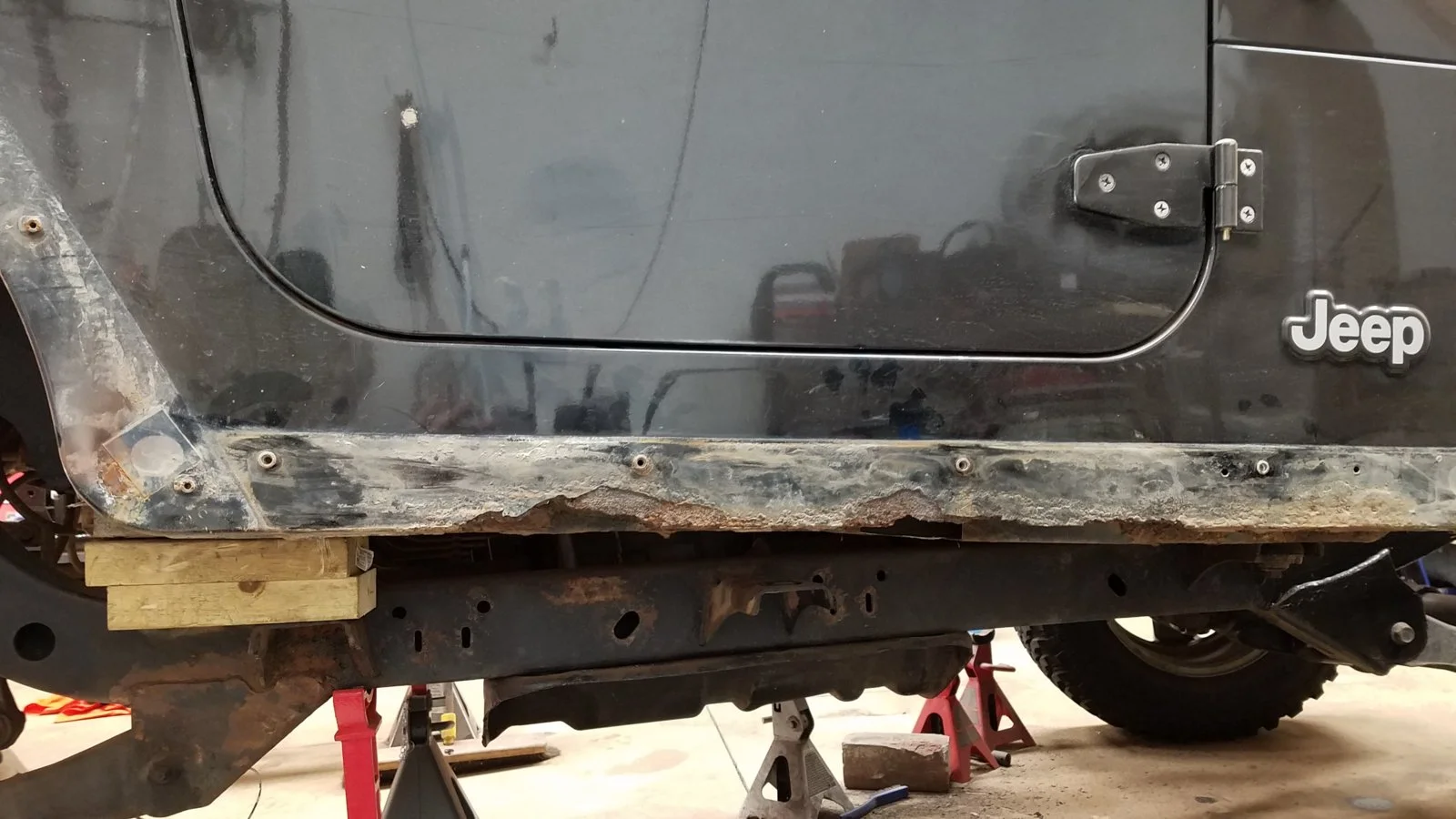

Thought I'd tackle the sheet metal work that needed fixing...refresher pic
I basically had to cut it back to where the floor changes height between the front and rear seat. Here is a pic of all the nasty metal cut out.

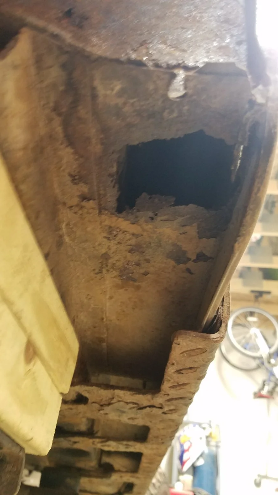

So, I had to pull my rocker guard...this is what caused my grief...

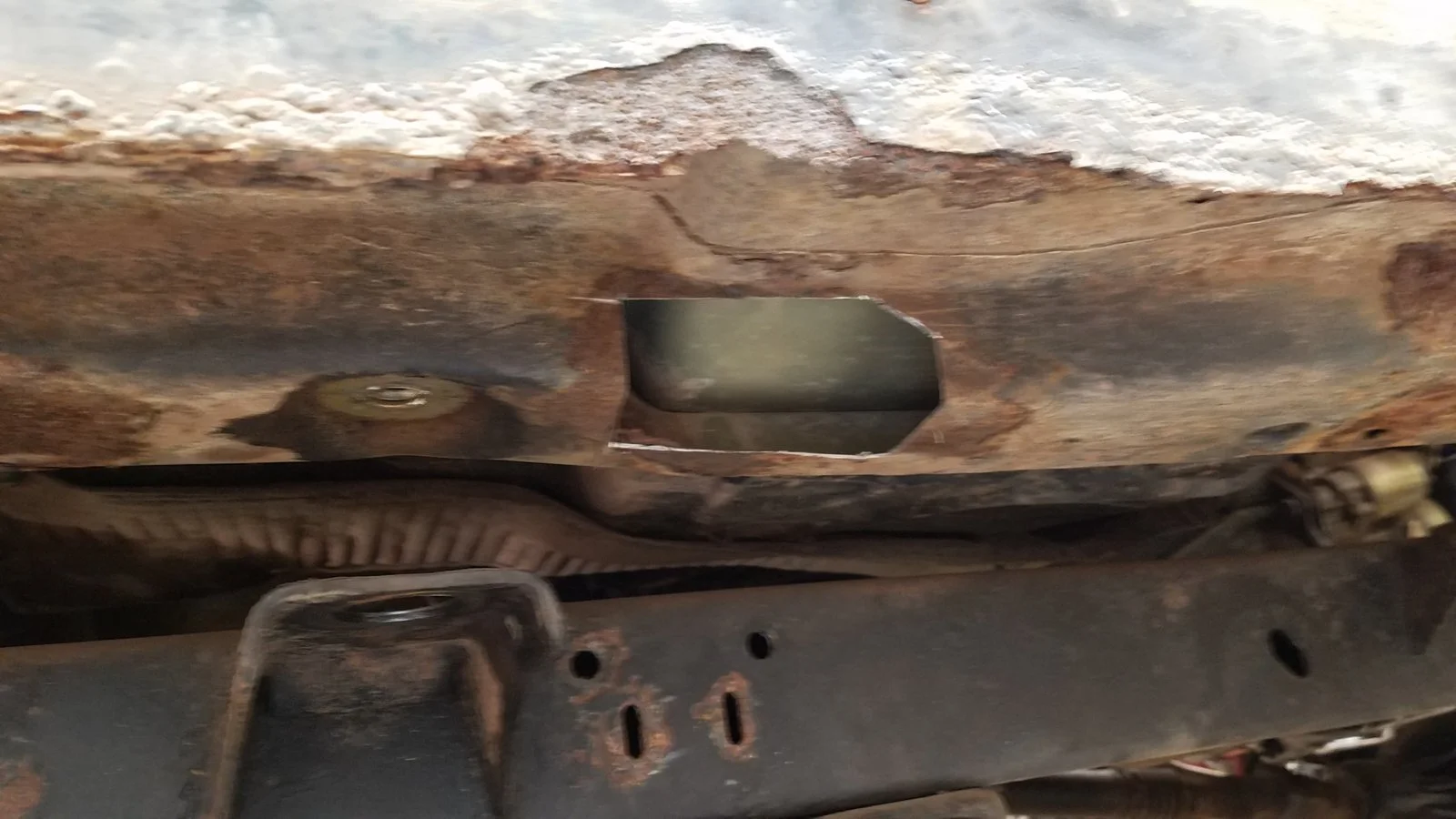

And even better...big hole in the torque box...here it is cut out.
The body mounts are still solid, and most of the box is solid. Floors are still good too, so it's fixable...but it's a bummer. I thought my jeep was better than this.

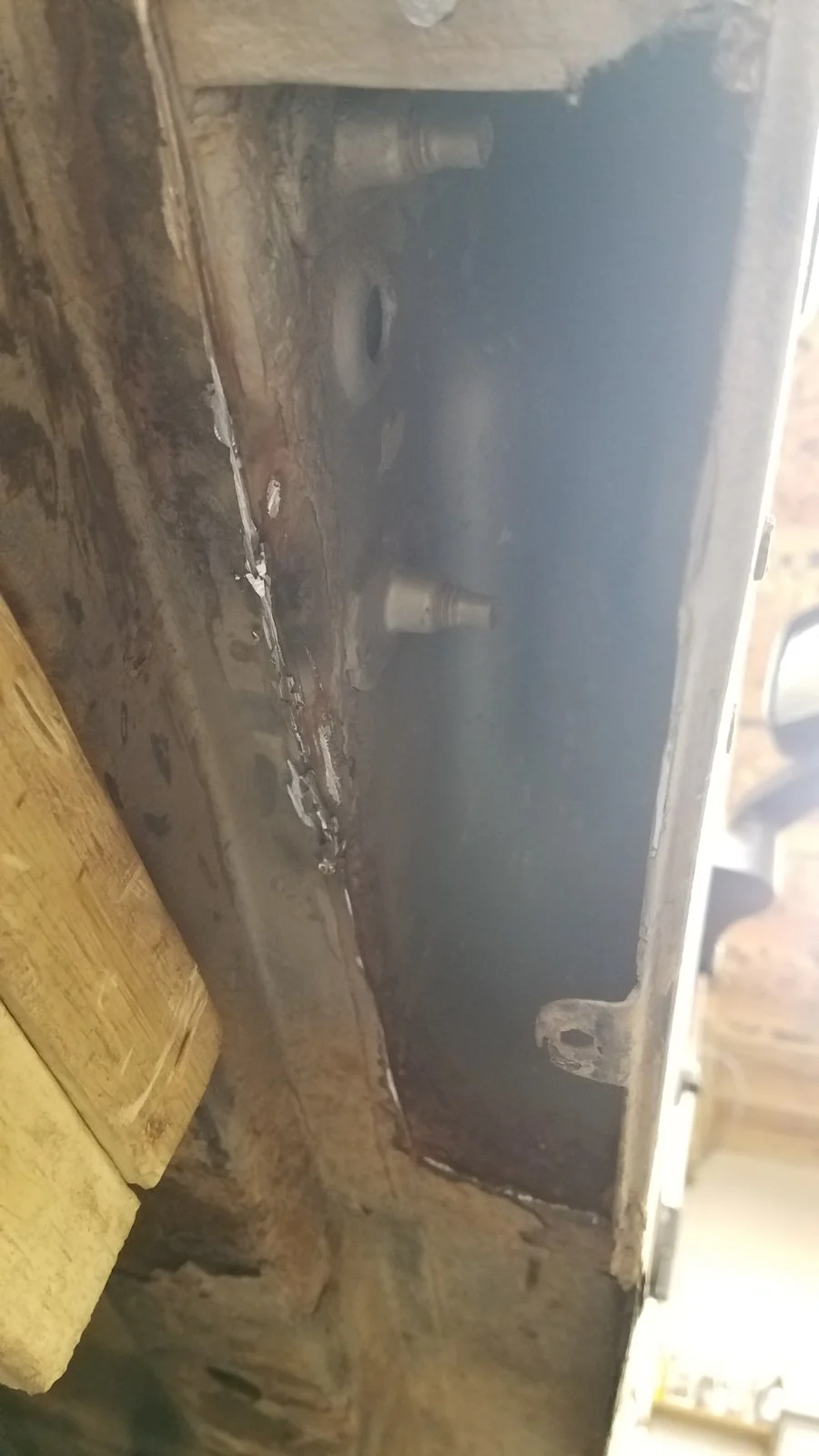

I also got one of my torque box patches tacked in tonight. I'll just keep picking away at this until its done.
