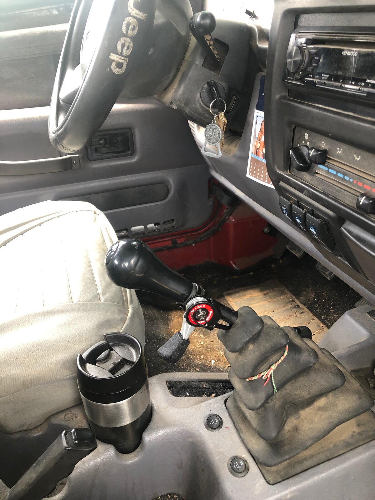

Please tell me more about the hand throttle. Why is it helpful? Is it easy to do?
Details please.
Crawling in the rocks and being in a precarious position might lead you to needing the clutch, brake, and throttle simultaneously. A hand throttle allows your feet to operate the brake and clutch, no need for a third foot. Simple as attaching a cable to your throttle body with a lever in the cab you can operate.
Details please.
Couple things I like about it are on steep hills i can start in the middle if I have to stop for some reason and use it while using the clutch and break
its also nice to bring up the rpms and hold them steady while winching

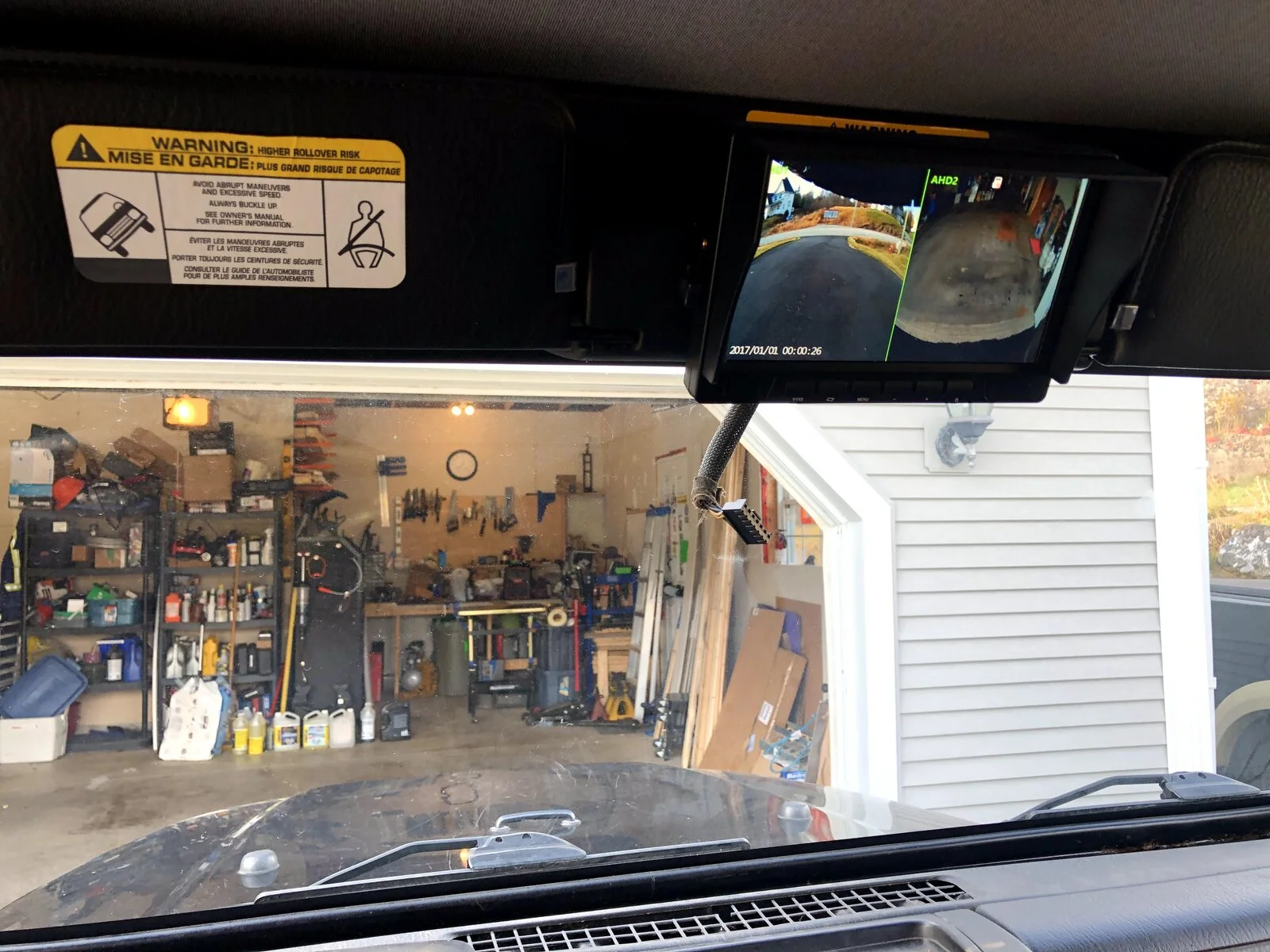

Hard wired back up camera...I really enjoy the instant on, the clarity and factory look of the one I got at Best Buy . Compares to my F 250 back up camera in the mirror.
I've been looking for a good backup camera rear view mirror that fits a 98 TJ. Is that what you installed? If so, what kind? Thanks.
Best Buy sells it ... I can’t remember the name ..it’s about 200 bucks and comparable to a ford in the mirror type ...it looks factory. The key is to get one that is hardwired.

My front camera is something I'm surprised how much I like it.. It's useful in a few situations I've found. Often on the trail I have only it displayed.
1. When all your are looking at is the sky
2. When you reposition on the trail to see where the rocks now are
3. When you are getting back in the jeep after being stopped for a while. Lets you see those annoying rocks that you couldn't see from the driver seat or if the jeep in front of you was too close.
4. Not running over the kid's bikes
Downsides
1. Depth is impossible to tell. A 6-inch rock and a 2-foot rock look the same.
2. You don't want to be looking at it while driving it throws off your planning. I only look at it once stopped. I find even a glance up throws off my tire placements. The expectation would be when I can't see anything from the driver seat.
