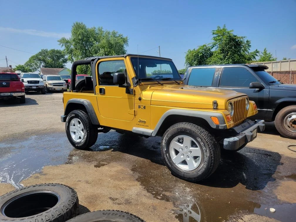

Regarding the color. some people either love it hate it. haha. it looked like a turd when i got it but it's nice now. darkened fenders and new shoes gave it a fresh look.

Need photos.
