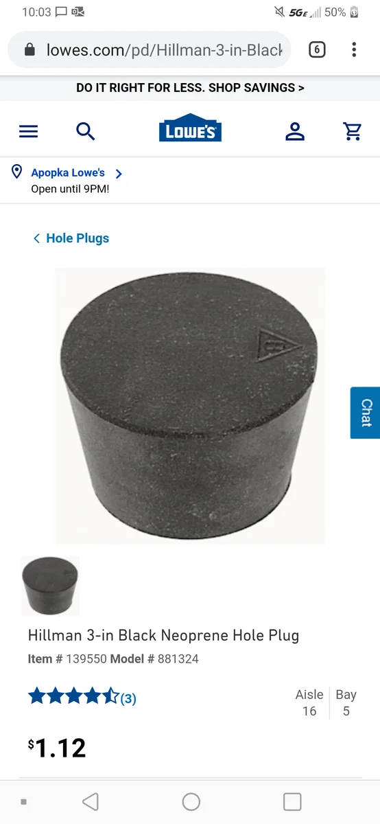

Hockey pucks are a little large for this application. It looks like the snub spacers are 1.5” diameter tops.
Your local hardware store has hard rubber stopper plugs in a diameter that will be close to what you need. I got some and they are ideal for the application.
