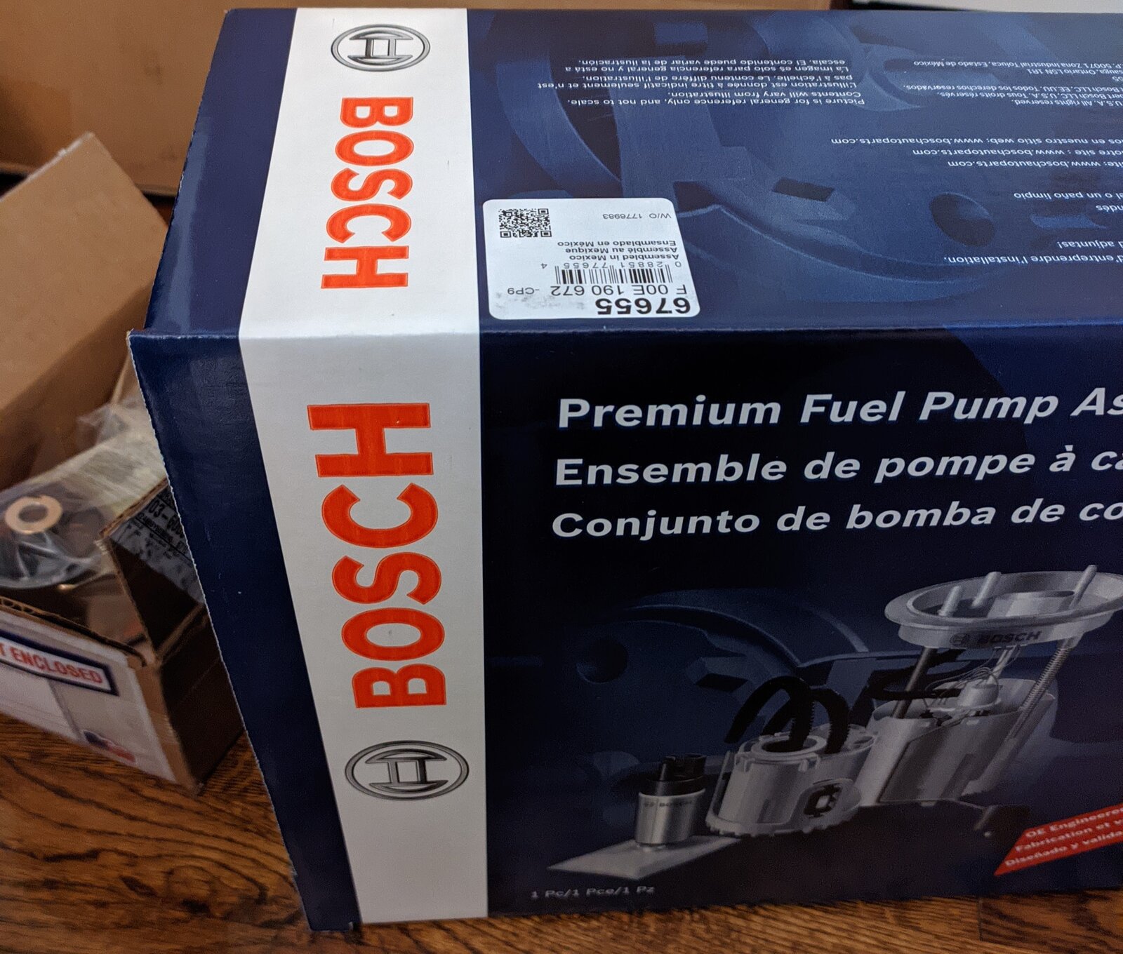

I just picked up the BOSCH 67655 assembly from Rock Auto. It arrived today!
It's pricy, but it has the best reputation of the pumps currently available.
Thanks for everybody's advice, and so fast too. This is the best community. I just ordered the Bosh from Rock Auto. it is an expensive bugger, but hopefully superior quality. This is solved thanks again for everybody's quick input.
