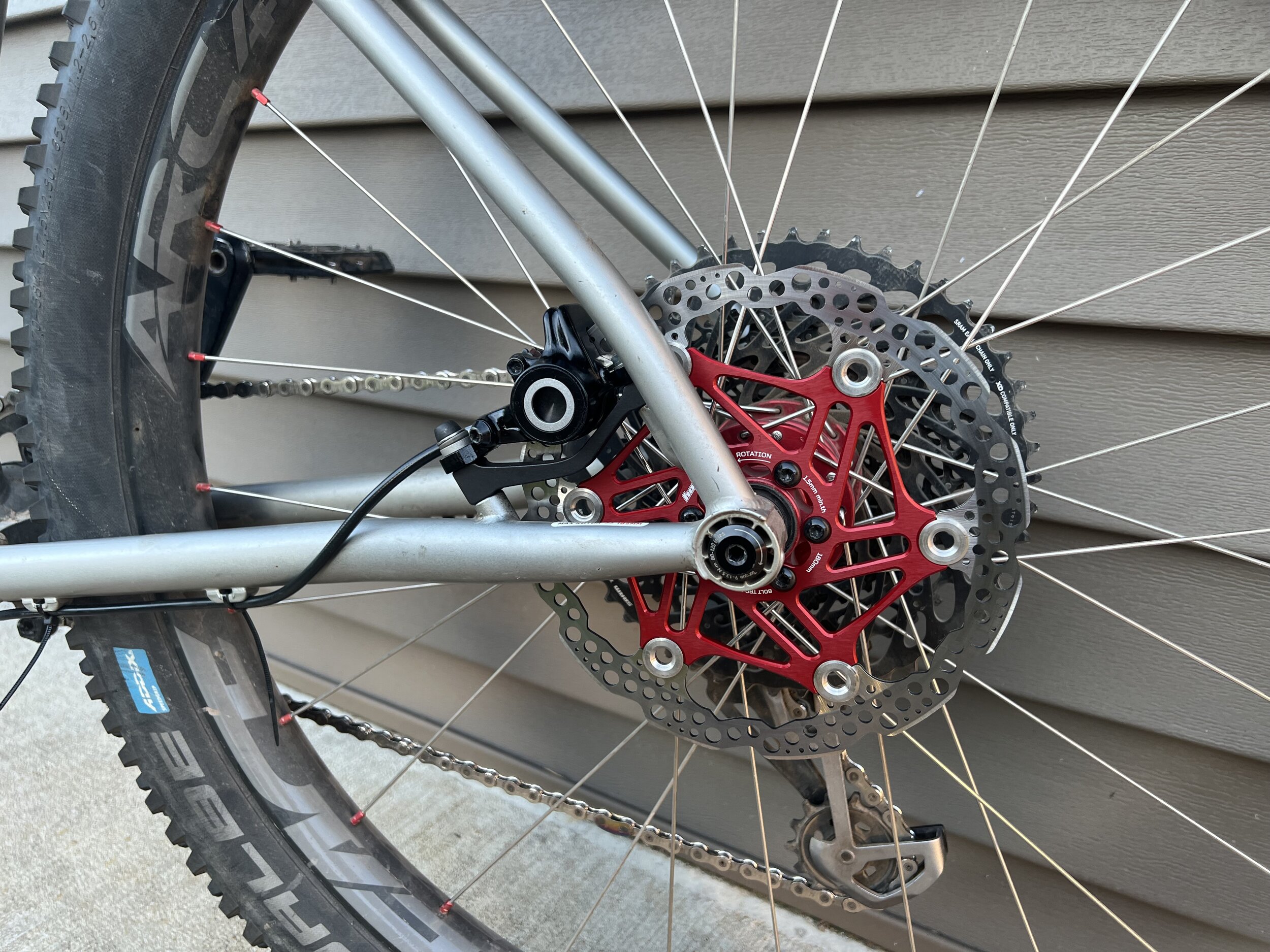

Time to do some maintenance to my main bike (a Niner ROS9 I built about 3 years ago). Noticed on a ride yesterday that I was getting some weird motion out of my 2-piece brake rotor in the rear. When I hold the brake and rock the bike fore and aft, there is motion in the rivets where the braking surface joins with the hub. My current setup is I have magura MT trail brakes with the two piece rotors. I have a 4 pot front caliper and 2 pot rear. Stopping power is good, but I can't lock up the rear. I'm running 4 pot front and 2 pot rear brakes, 180mm discs. I will be honest and say I "experimented' with some knock-off Hopes and I am probably paying the price. Curious if it might have something to do with the rotors?
Are the Hope rotors worth 70 bucks? Should I be running a one piece rotor? Is the little bit of "rock" that happens on the rivets of a two piece rotor normal? I've never noticed it before...so I think the rotor is ready to be replaced, but maybe not?
What is your favorite rotor and why?

I suspect I should be able to lock up the tires, and have done many bleeds. Not sure why mtb brake are such a pain in the ass to bleed, but I struggle.

Hope two piece rotors…they are 6-hole. Aluminum center section and a SS friction area. I guess technically, I should be calling them floating rotors, because there are far more than 2 pieces in the assembly.

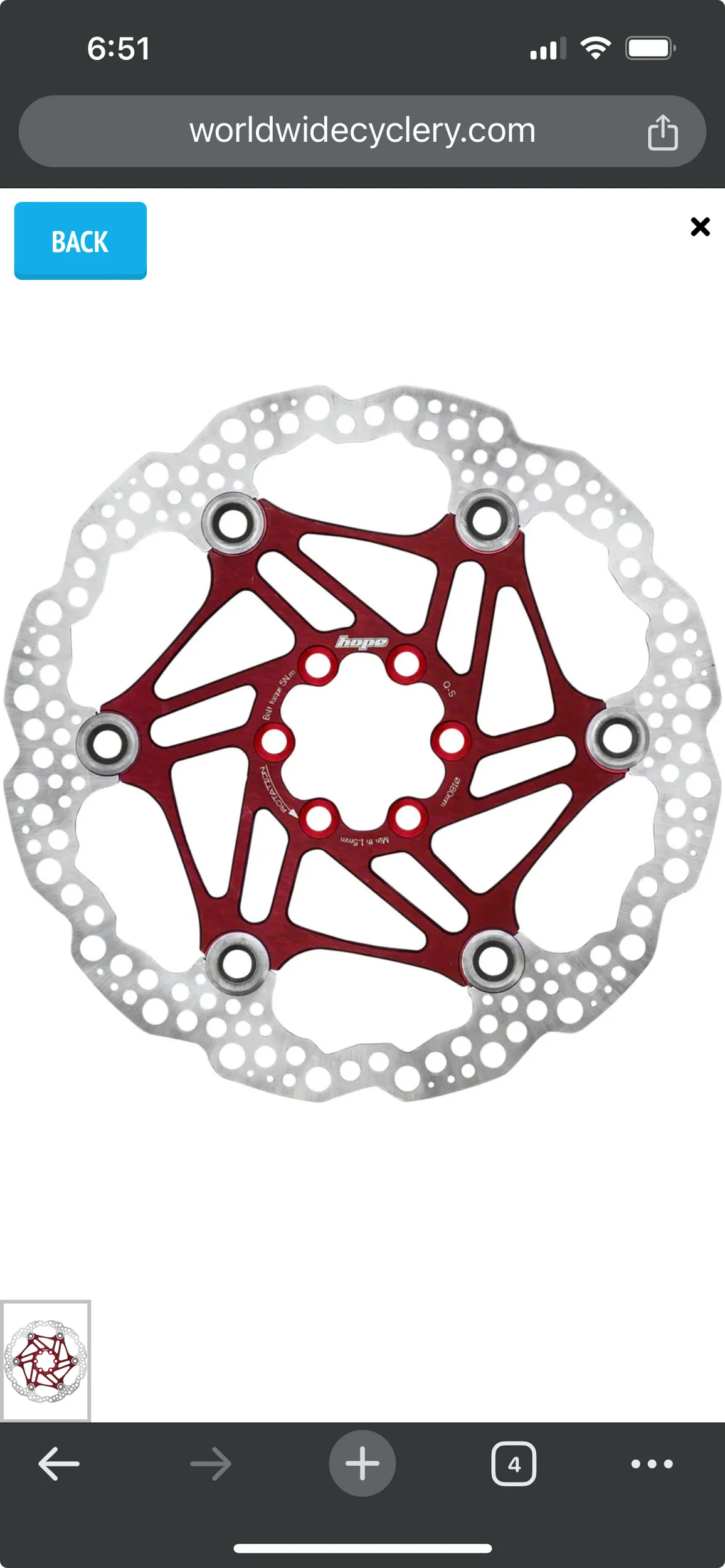

FWIW, I made a bit of an impulse purchase last night and I have two new, authentic, hope rotors (@Woodrow 200/180 :) ) on the way. My vanity sometimes gets the best of me, and I like the bling of the two piece. I really think my issues are more related to bleed and contamination after doing a bit more research. So I also paid for the mfg recommended fluid vs the aftermarket stuff I use in everything else (that the lbs recommended). I’ll clean the pads with some sandpaper and alcohol too.
I decided to replace the rotors knowing that I can’t fix the ones I have, and they aren’t going to get better. Would hate to have a full separation on the trail.
👍You won’t be disappointed. Definitely a win on the bling factor (so many color choices😀). I’ve probably had half a dozen sets of Hope rotors in the past. They are well made and beautiful and you will like the extra power of the larger front.

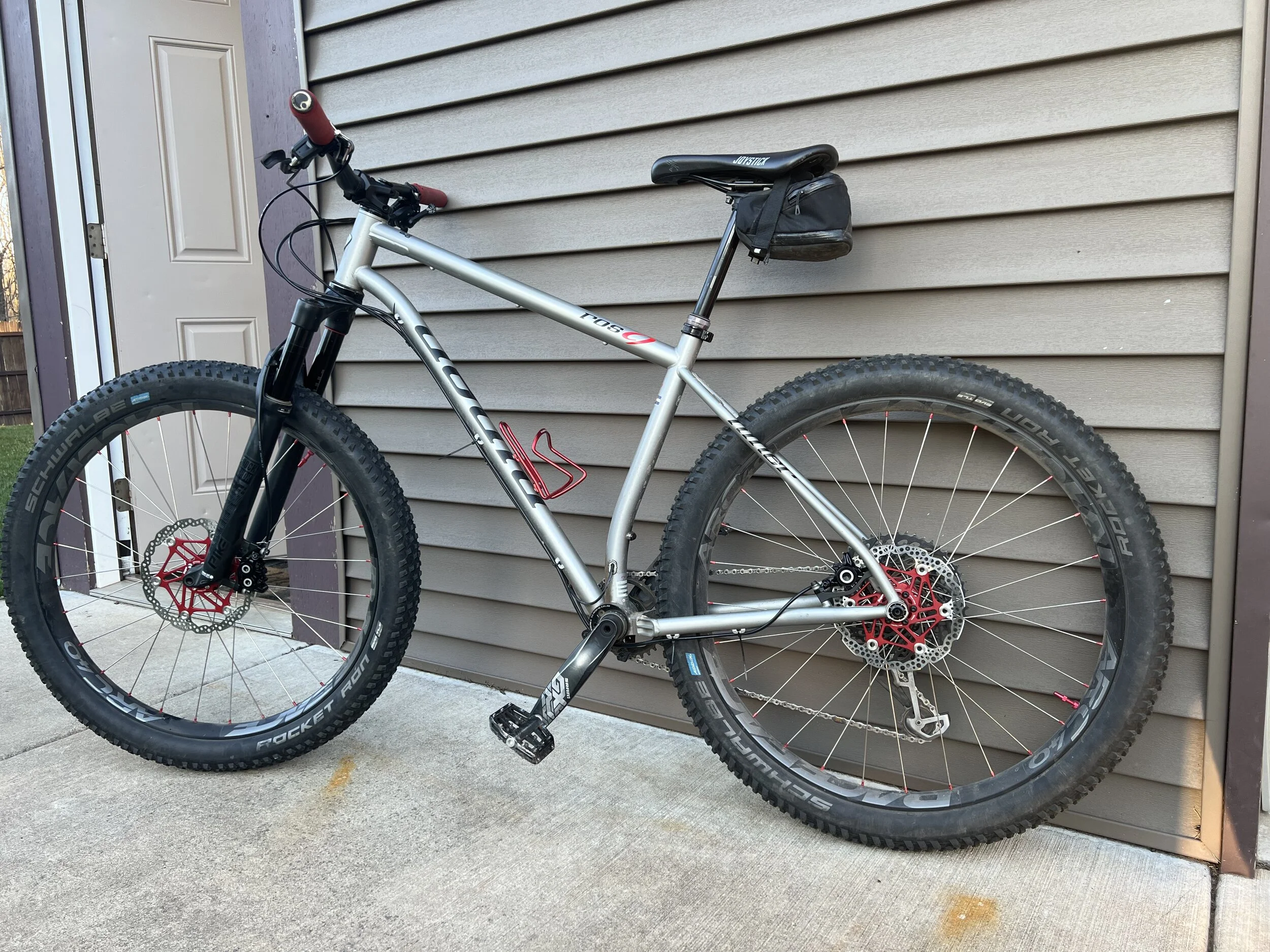

I have brakes again! They need to be fully bedded in, but I can already tell they are so much better. I did not have a good bleed in the rear, for sure. That coupled with the extra rotor size means I should not have any further trouble with the woah! It was a good upgrade too, as one of the last times I rode I almost ran over a buddy that went OTB in front of me. Got her stopped, but not quickly enough for my comfort. That’s what kicked this whole thing off.
  • Love
Reactions: Woodrow
Who cares how they work, the bling man, the bling!:love:
Seriously, nice looking bike and you'll love the performance.
