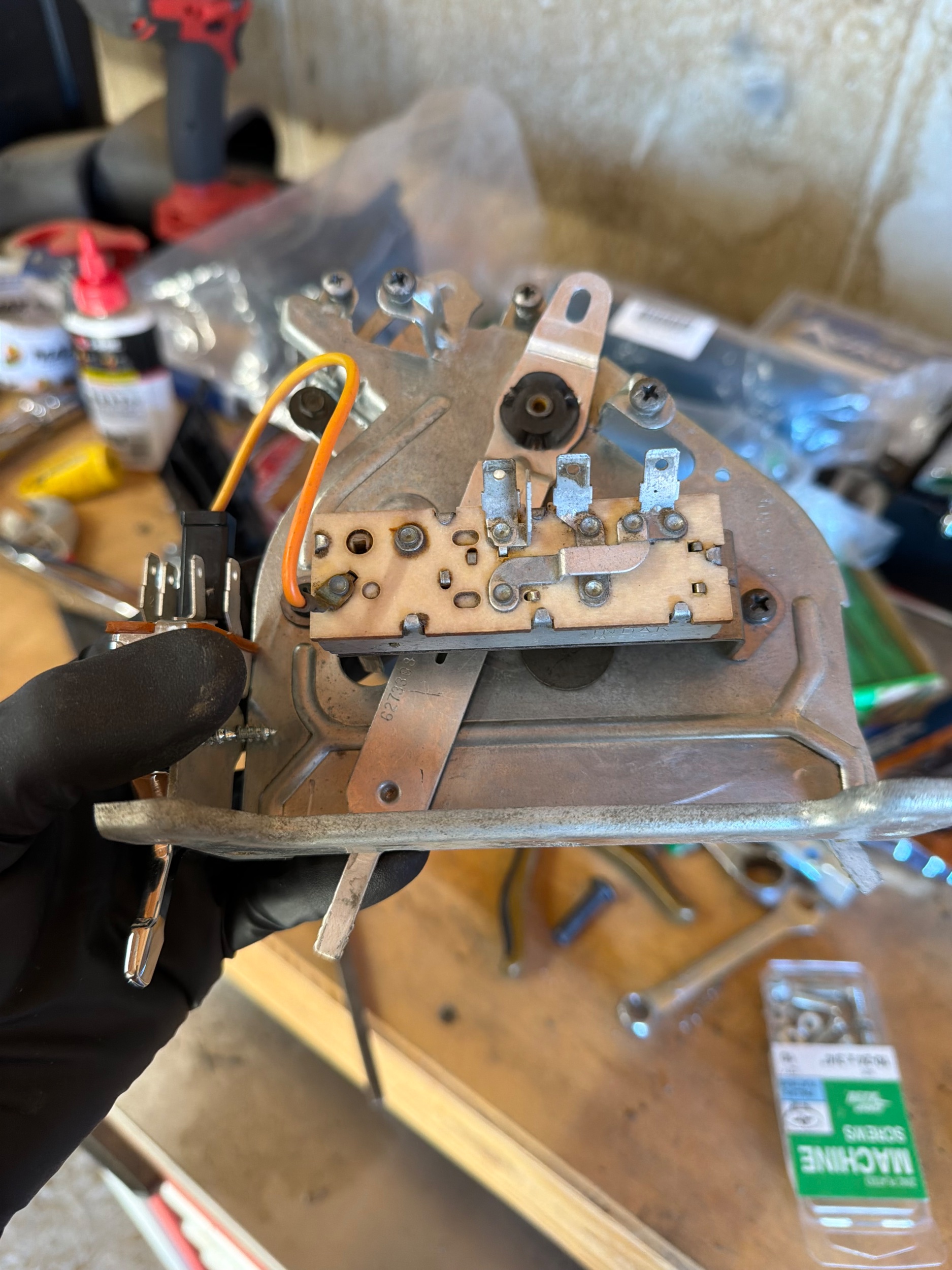

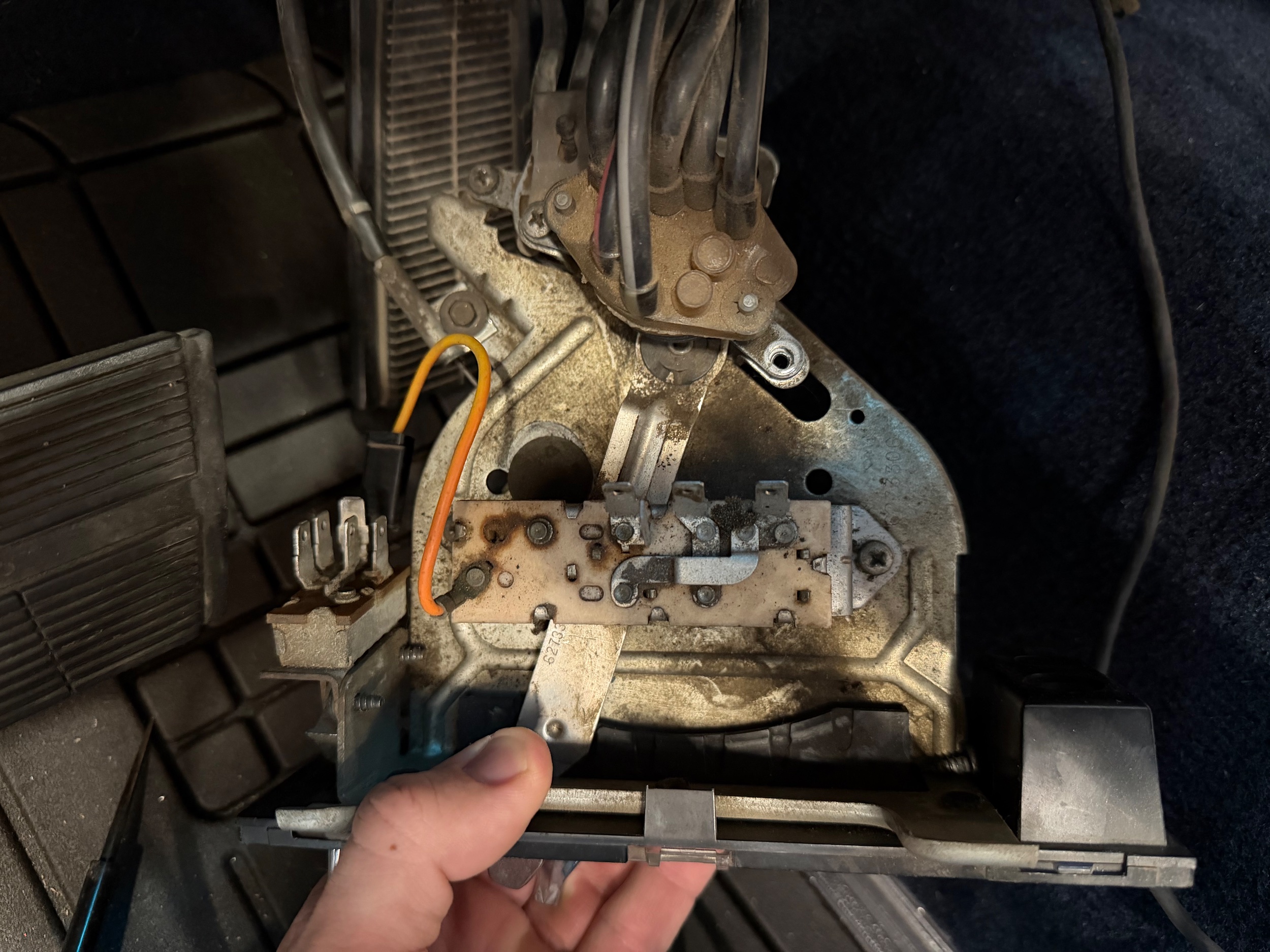

Spent today doing more wiring and cleaning up my HVAC unit. This thing was absolutely filthy! I ended up cleaning all the electrical connections and everything as well.

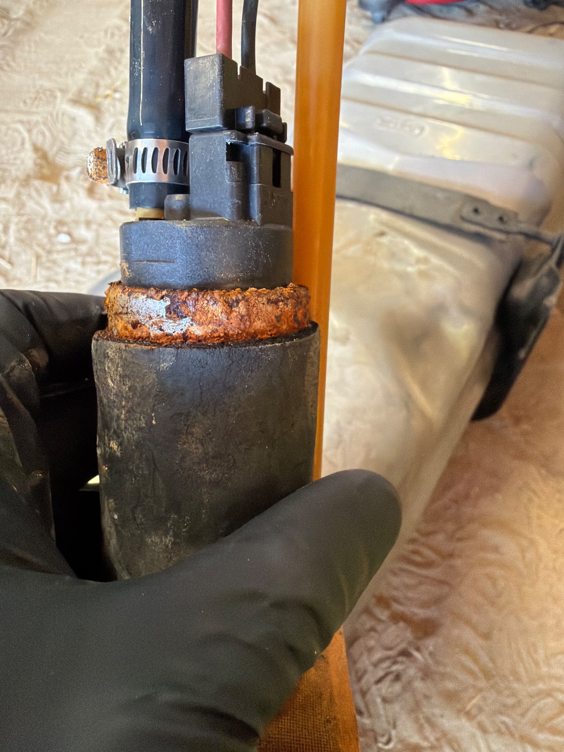

And here’s my rusted fuel pump. The entire inside of the tank looked like this! Thank goodness for fuel filters!
Finished everything regarding the fuel tanks today. Got fuel in it, fired it up, and confirmed that both the main and aux tanks work. The Dakota Digital gauge cluster is in place and I've finally got a working fuel gauge.

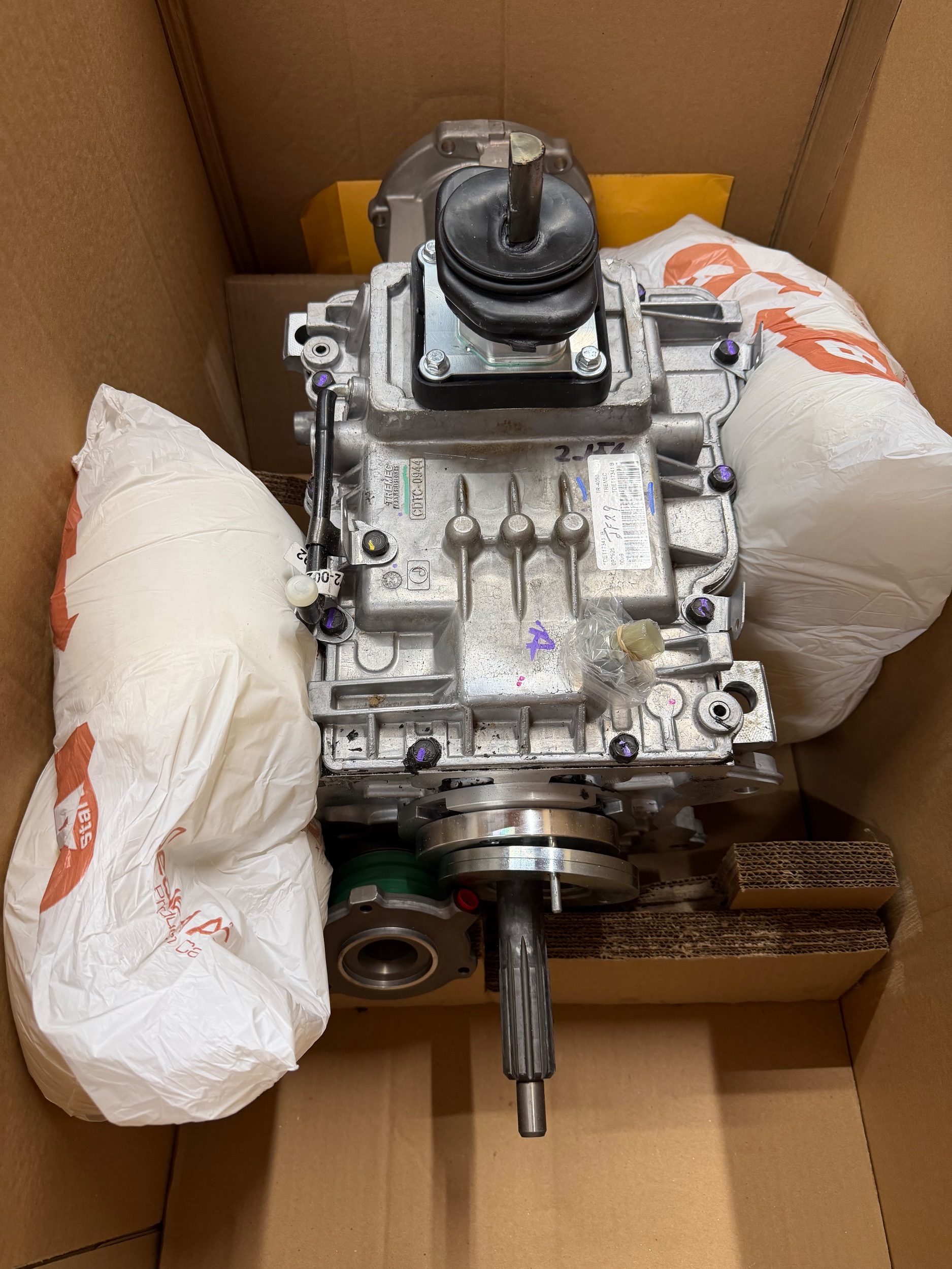

This took me a while but I was really pacing myself. I'm happy I've got a functional dual saddle fuel tank setup. Next up is painting the metal portion of the dashboard and then I'm going to get started on the manual transmission swap.

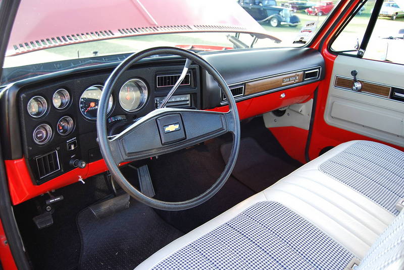

Really? I thought that since it was two tone exterior the lower half of the dash would be white and the dash pad would be blue (to match the exterior).
Here's an example:
Here's an example:
The main body color and the inside of the cab were the same color , it didn't matter if the truck was solid color or with the white side accent.

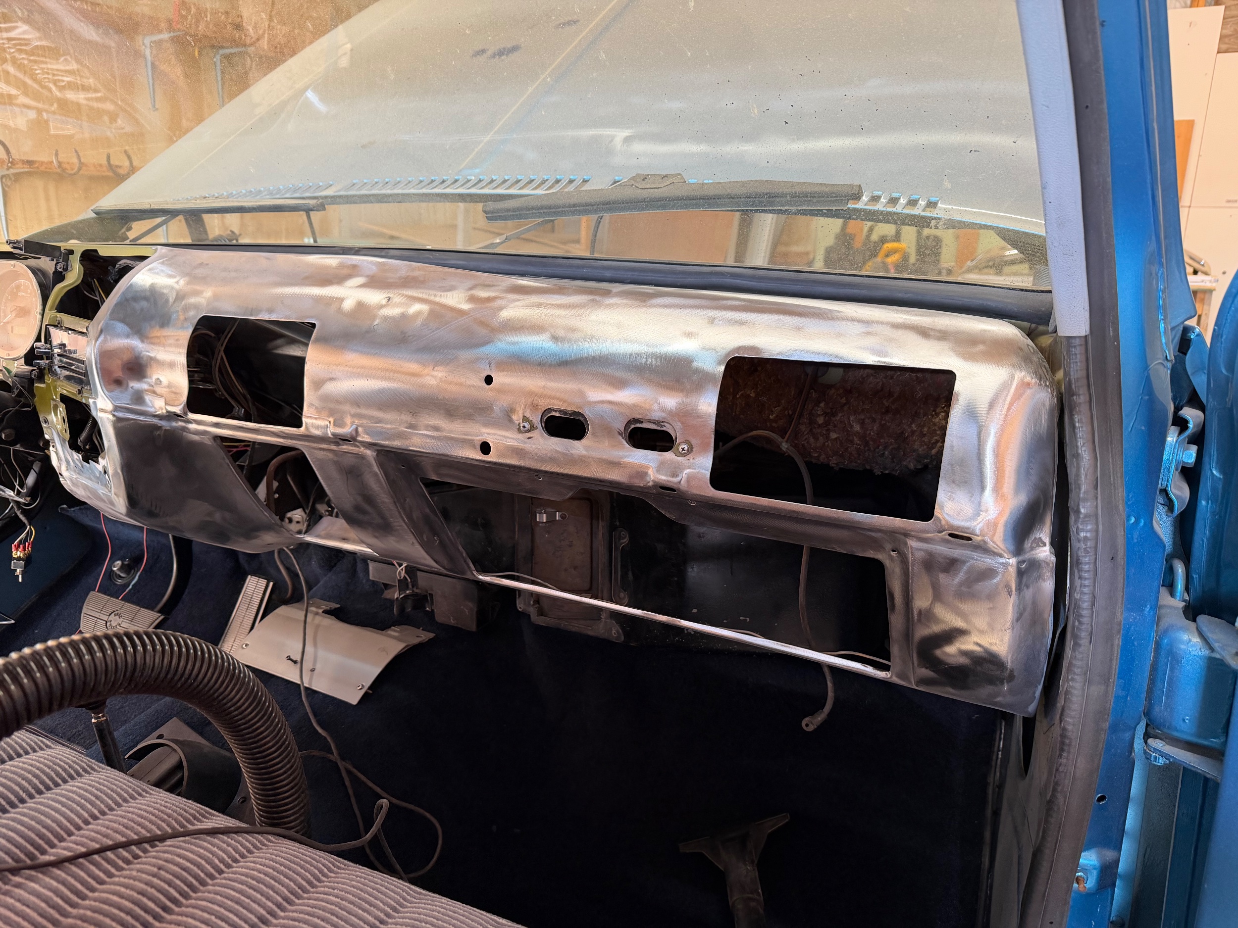

I'm hoping I can find someone with a paint gun, mask off the interior, prep it, and then paint it. I don't think it should be too difficult since it's a fairly small surface area. Half the dash is covered by the dash pad anyways.

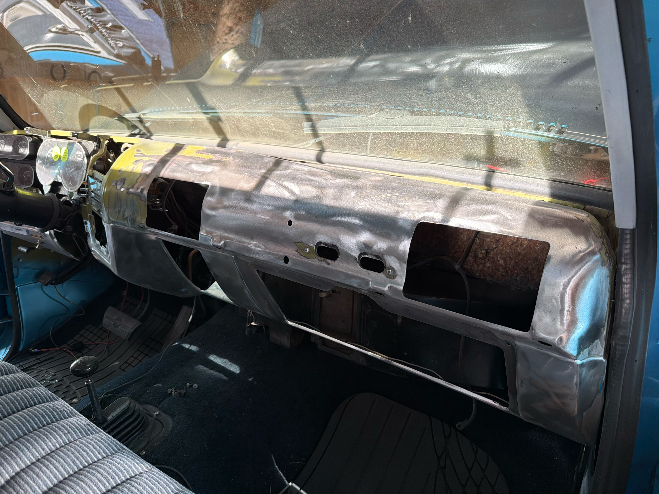

Prep work has begun on the dash. Taking it down to bare metal and then spraying it in Marina Blue followed by clear coat. After that I'll put the new dash pad on, new door panels, and then the interior will look brand new. After that it's transmission swap time!

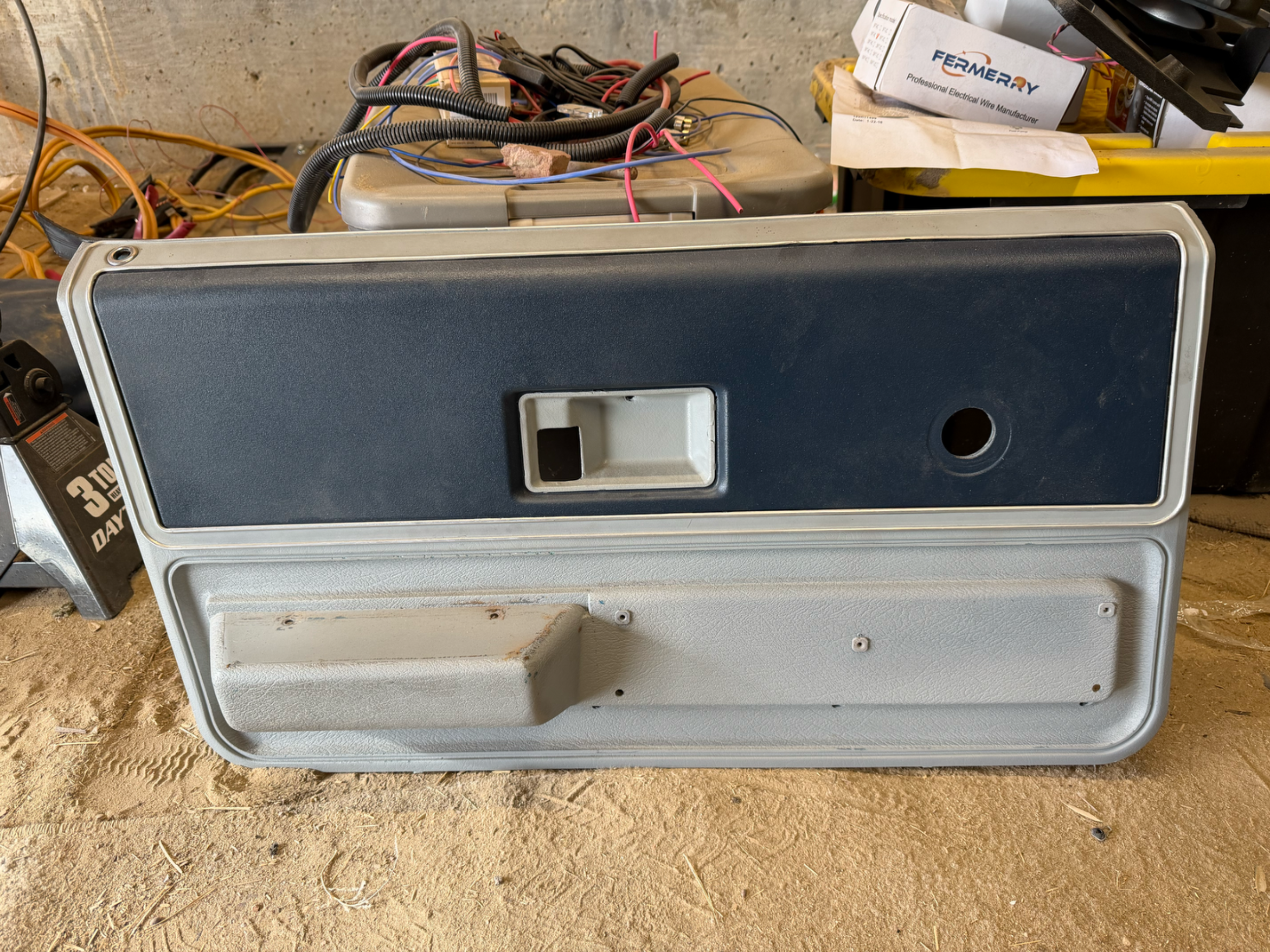

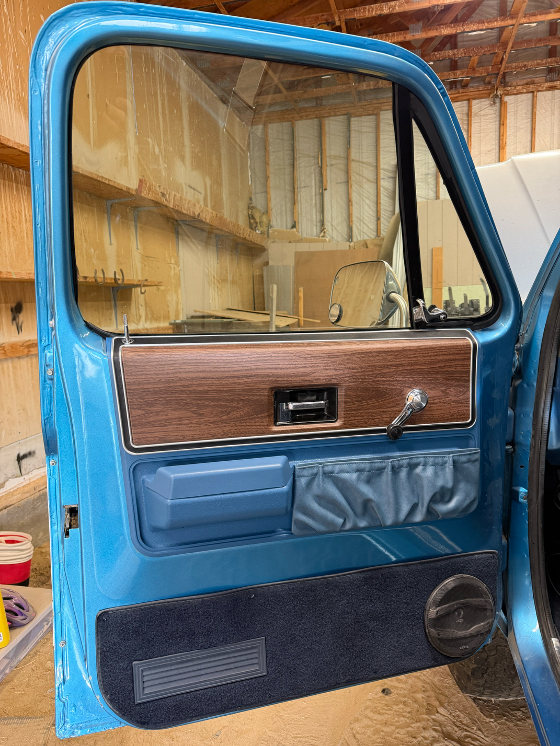

The first image is the factory door panels which the previous owner decided to spray paint gray among various other interior parts (which I'm in the process of switching back to the factory blue).
The bottom photo is the new door panels from USA1 which look absolutely fantastic and fit just like factory (made in the USA too!).
Tomorrow I'm going to install the new dash pad and get her all buttoned up, then it's on to the manual transmission swap!
After that I'm going to get her ready for summer.
