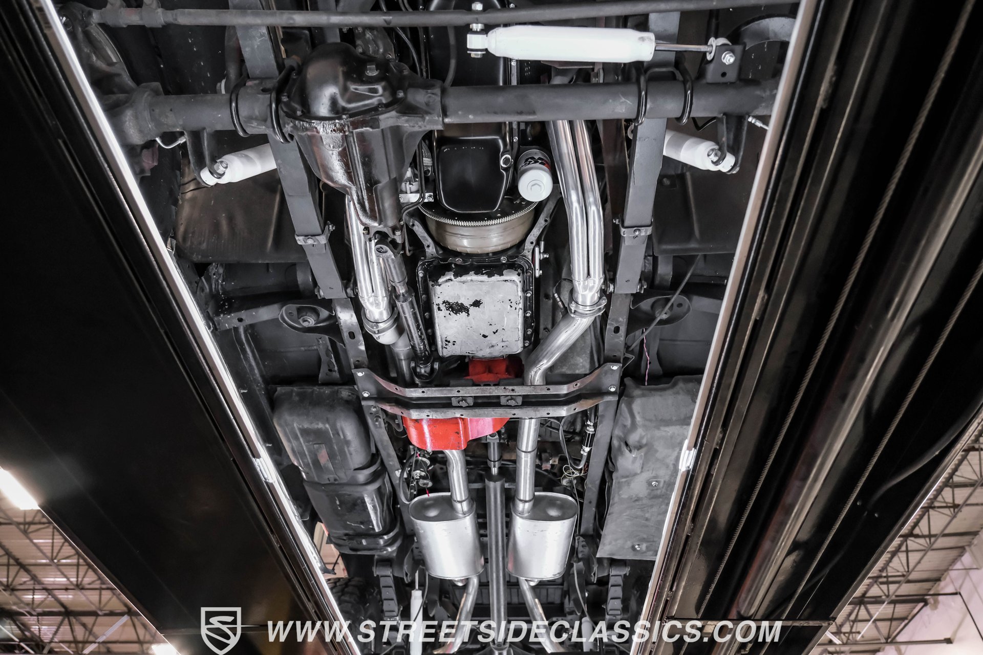

Crossover pipe or separated duals? Sounds good!
Separated duals:
  • Love
Reactions: Rickyd and ColoJeep
In my world , I've given up the few h.p. at the top end using a crossover pipe . The sound of true separate dual exhaust is worth it ! It's a pickup , not a F-1 car .
Your truck sounds good Chris !
I agree
It's not like I'm going to be going much faster than 100 MPH in this thing. Even that is a bit of a stretch. I think the fastest I've had it is 80 MPH and that's fine with me.
It really does sound excellent with the exhaust setup. My neighbor loves it every time I fire it up. He's an old school Chevy guy so when I brought it home he was elated!
  • Love
I set up my 70 that way with the 6.0l. Love the alternating blat,blat from the tips at idle!
Yep, my Mustang had the crossover X-pipe and it gave it more of a throaty race car sound. For this old thing I think the separated exhausts sound better.

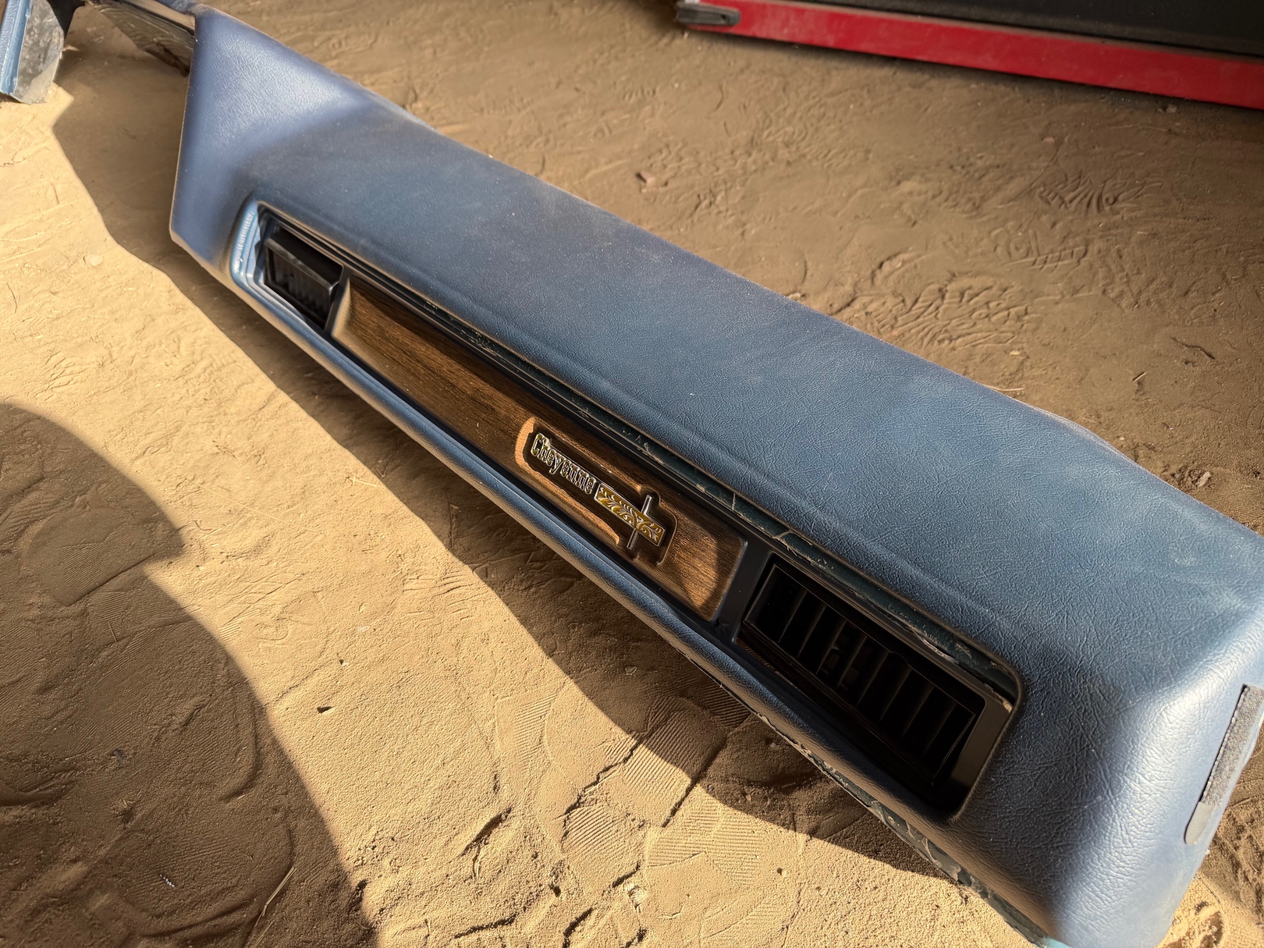

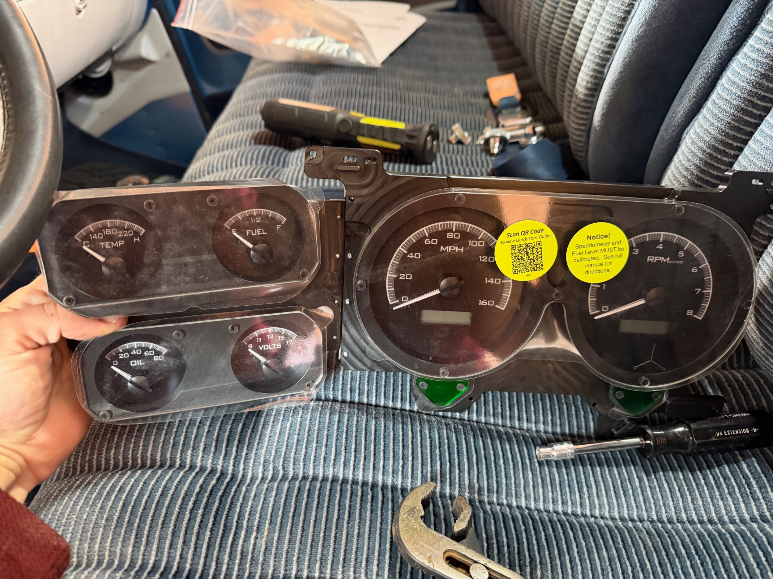

Today I started on the latest project which is installing the Dakota Digital VHX gauge cluster, new dash pad, and new HVAC vents. After I'm done here I'm going to put the new fuel tanks in and wire them up so the dual fuel tanks work with the factory dash switch.
Here's the old dash pad I removed which was some sort of cheap low quality reproduction from LMC. Look at how warped and awful it looks!
Upon removing it I found out that this truck used to be a different color!
Here's the new Dakota Digital VHX gauge cluster that will be going in:

Whoever repainted it did a great job of covering it up. I can't find a single trace of it anywhere on the entire body, even in the seams and underside.
Well your truck was built from at least two , maybe more trucks . It's cool it has great paint .
