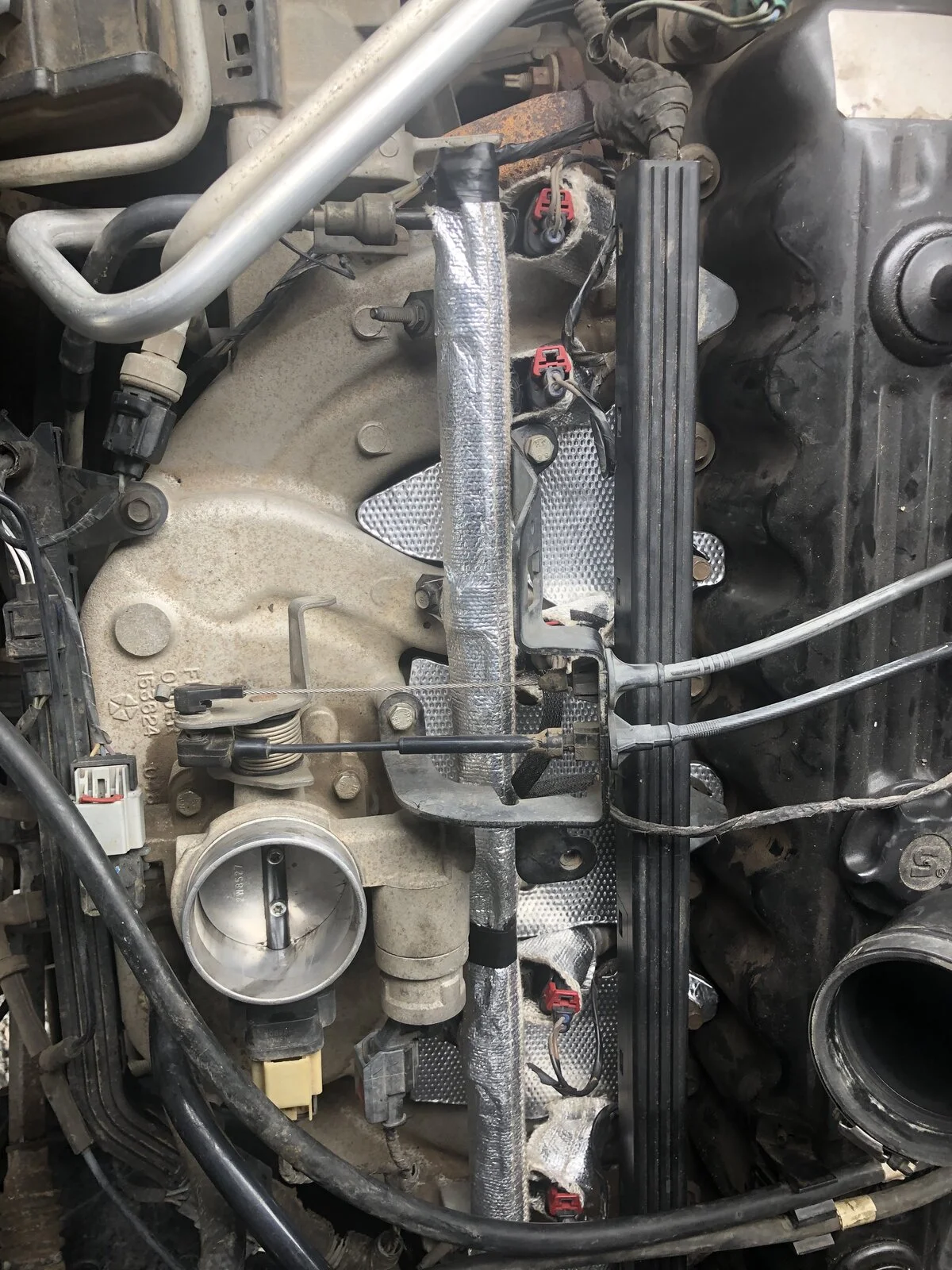

History: After buying my TJ in early 21 with 112k I decided to do some preventive maintenance which included a set of Autolite APP985s. Everything was good for a year or so and then the dreaded P0303 code appeared. As you all know, that there can be a myriad of reasons for this code. It would only throw the code after the engine heated up. After much research on this forum I figured that since the plugs were relatively new and the correct type it must be caused by heat sinking or failure of the injectors. So I bought new 4 hole injectors and a heat shield kit from K Suspensions. The kit included manifold, fuel rail and injector shielding. The code still persisted. Thinking now that it was the coil pack I tested it to see if there was spark on all the plugs (per Youtube) and checked to make sure the contacts were correctly aligned. All checked OK. Next I did a compression check. Again all within spec. When I pulled the plugs #3 was discolored (see pic below). I turned the engine over and found that fuel was entering the #3 cylinder and again compression was within specs. I painstakingly inspected all the wiring for breaks or chaffing. Again no issues found. I decided to swap the #3 and #4 plugs. I ran it and after the engine warmed up it threw the P0304 code this time. This was my aha moment. I bought a new plug and installed it. Very long story short that $7 purchase seems to have fixed the issue. The plug that failed only had around 100 miles on it.
