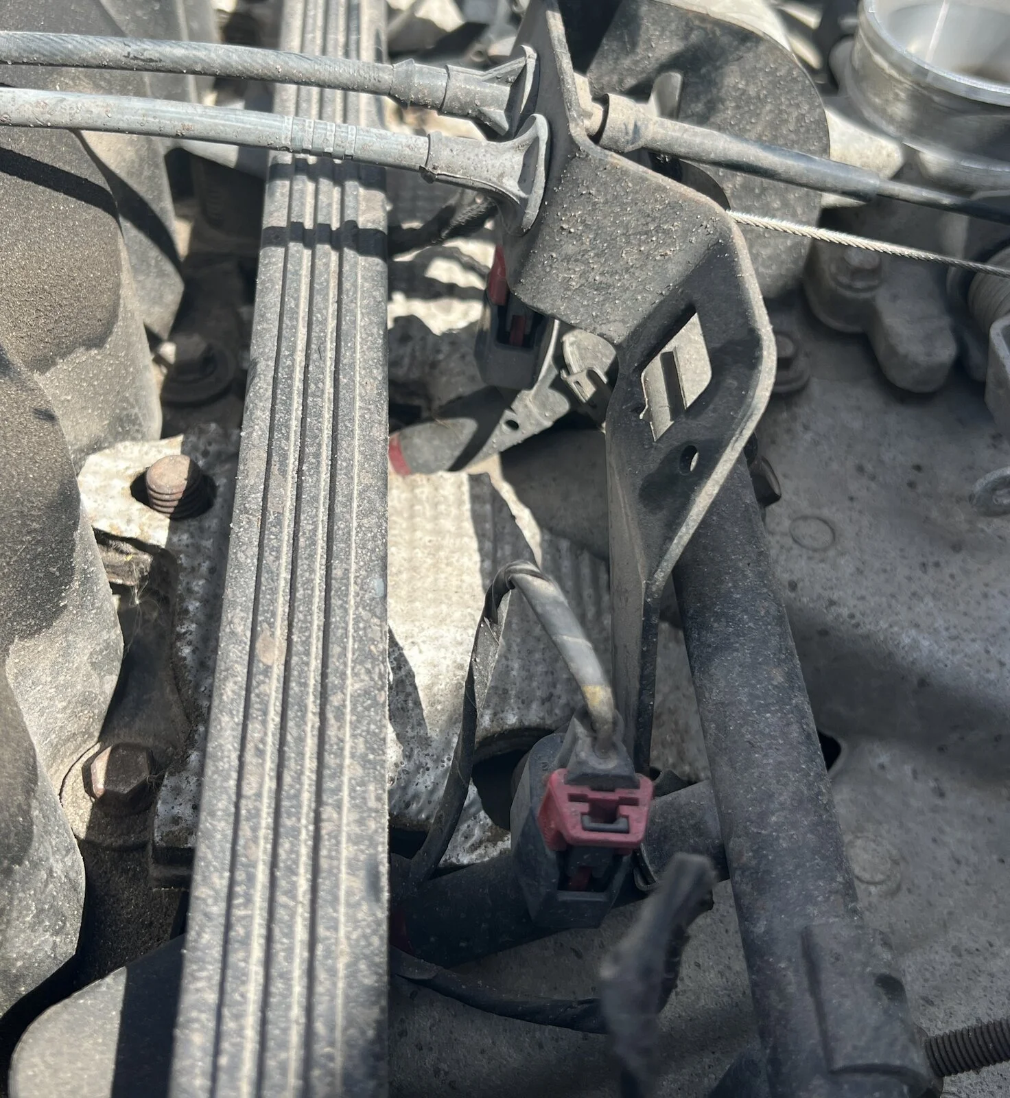

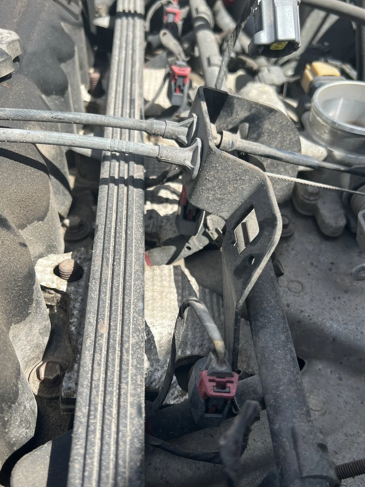

I found this info: Check for a wiring rub through to the number three injector at the bracket for the throttle cable, if the injector connector is not turned towards the rear of the motor (2 o'clock position) and is facing up the wiring can chafe on this bracket causing the injector to not spray fuel at times or constantly.
I moved all mine back to basically 12 o’clock and number 3 to 2 o’clock.

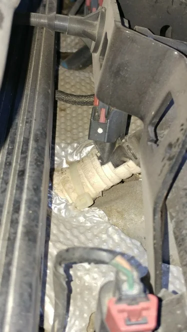

Yep, that misfire is most likely from the fuel vaporizing inside the #3 injector caused by heat from the exhaust header collecting in that area. The fix for that is to wrap a piece of insulation around the #3 injector and zip tie it into place which fixed my #3 misfire.
This is the product called for in the Mopar TSB that fixes that problem... https://www.amazon.com/gp/product/B007O3QHDK/?tag=wranglerorg-20

If your '06 doesn't have the #3 injector wrapped with insulation it makes good sense that doing so would cure that #3 heat soak issue. Just buy the below insulation Jeep specified for that fix and zip tie it into place around the #3 injector and my bet is it'll be cured. https://www.amazon.com/gp/product/B007O3QHDK/?tag=wranglerorg-20
This is my #3 injector and I have no heat soak or misfires.
It looks to me that the later models had more insulation on each injector. This certainly looks thicker than what I have seen in pics of earlier models. I dont think those insulators will go over what I have.
I did find the wiring connection twisted almost to the 3-4 o clock position and pretty much touching the heat shield. I wonder if that was the problem. I rotated up to 1-2 o'clock like recommended.
