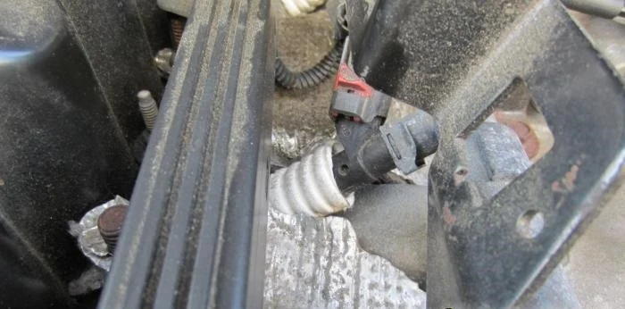

But your #3 misfire is more than likely caused by the issue mentioned by TJDave above. The #3 fuel injector can vaporize its fuel inside from engine heat and cause a misfire. The TSB he provided information on is basically wrapping that insulator sleeve around the #3 fuel injector to prevent that from happening. I also had a #3 misfire that was cured by that insulator.
Reactions: Ian
For those who like pictures... ;)

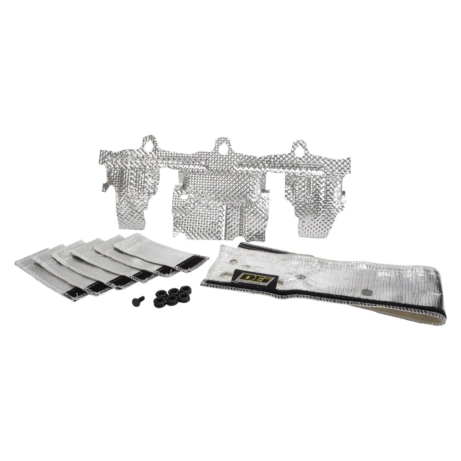

In addition to the injector wrap that was mentioned, I'd be sure to check the foil insulation blanket that sits on top of the Intake manifold. It may look ok, but deteriorate and lose effectiveness. Mine looked outwardly just fine, but when I moved it around, it just came apart in pieces. I actually stacked two new blankets together.

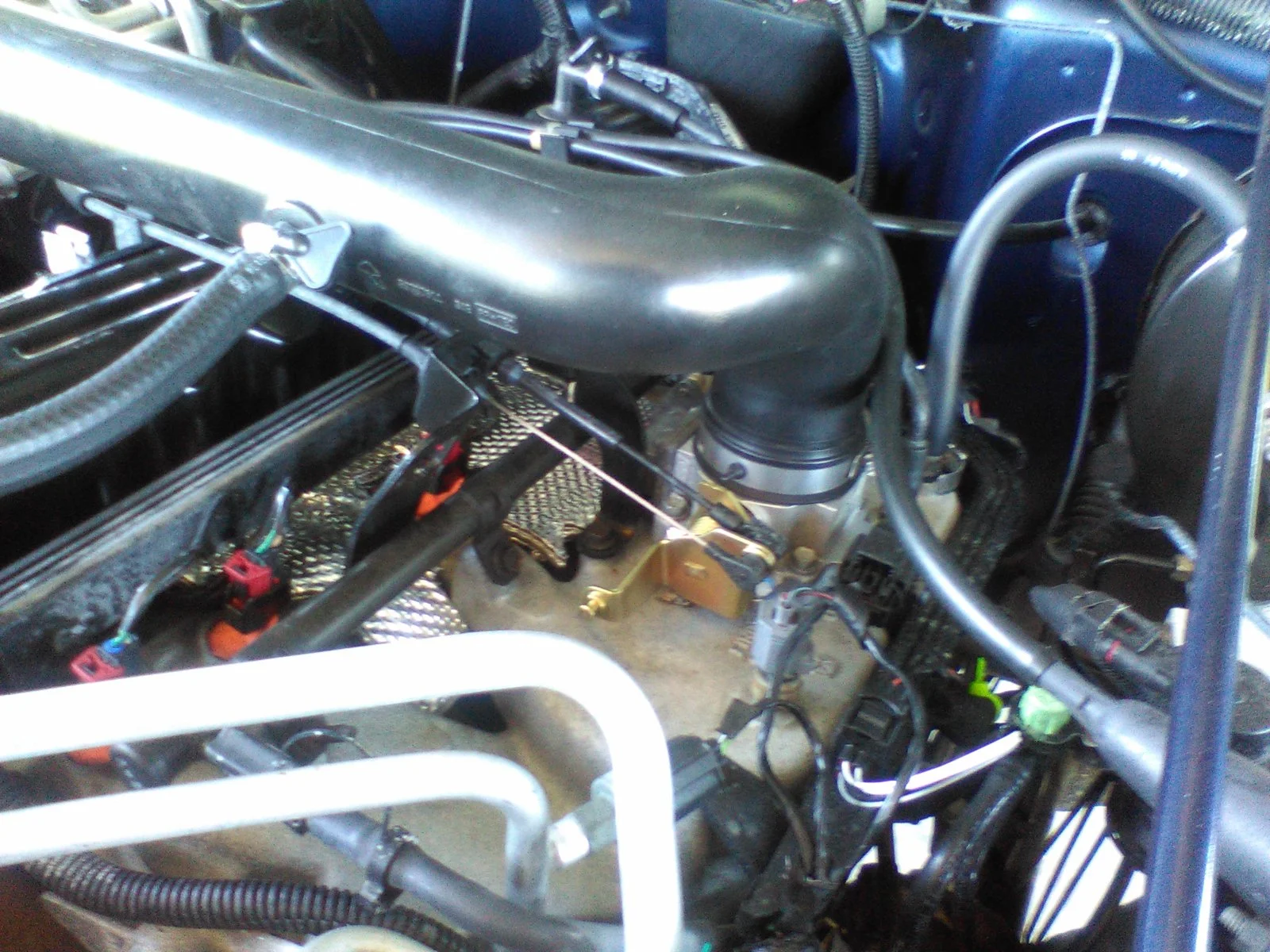

@Jerry Bransford knows for sure, but I believe it goes around the injector:
Here's Jerry's thread on it:

Just realized this article is for 2000-2004 and I have a 2005. And I have reset the code and started my jeep cold and the code popped back up in less than 30 seconds. This makes me think it has nothing to do with heat but I am still going to put the heat shields on it because it won't hurt. Also didn't get a chance to test my coil pack and I won't be home until tuesday.
