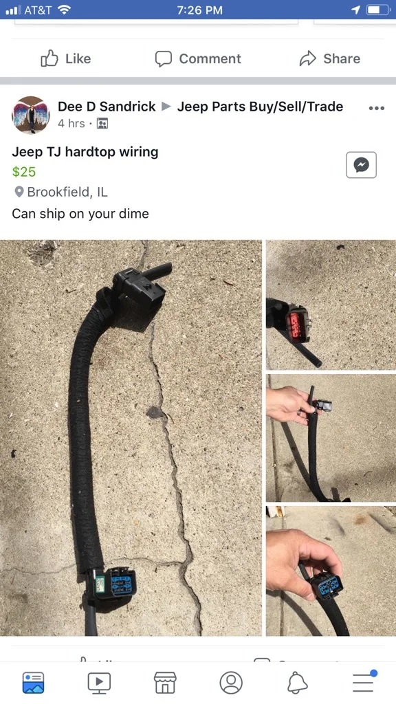

Then I immediately see this posted on FB:
Reactions: Tony Ownbey
Wow! There's hope. I've spent way too much time looking for parts. I should have just asked the question earlier. I'll check this out. I have steel cable so that's a few more lbs. on the front end. Maybe I have an excuse to get synthetic line? I'll have to allow time for my wife to absorb that I have two Jeeps before I buy much more. I would like to get the wiper-defrost working though. I'll post some pics tomorrow. The new one is white with that $3,000 dollar Rubicon sticker on the hood. Worth it! Thanks for the help.
Reactions: JeepZilla380
Yea, no sooner had I read your post I saw that on FB. Never know what you’ll find on that marketplace. For winch line I used winchline.com when I upgraded my steel to synth. Not a cheap purchase but much lighter.
