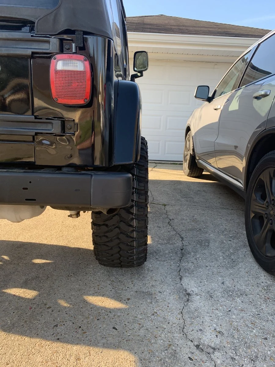

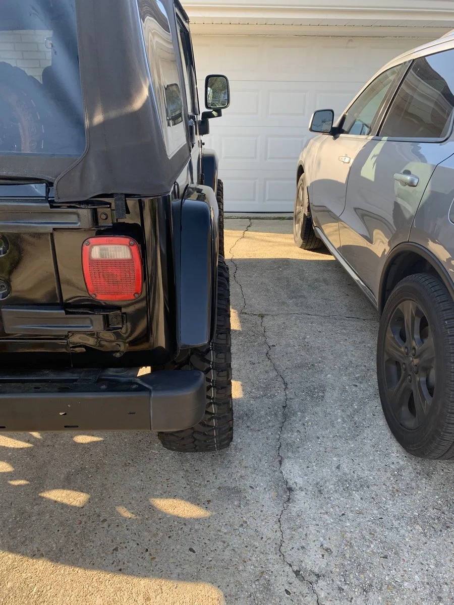

My son got hit directly on the passenger side rear wheel. Looks like the rear driveshaft was knocked over towards the drivers side and even now the spare tire and rim I put on is wobbleing bad . I saw somewhere y’all we talking about how not to get low balled by the insurance company in case of a total . Thanks for y’all time on this Sunday .

if it took a hit in the rear to the wheel it'll have bent that wheel flange all up and likely shoved the axle over too.
any pics of the damage? the frame and drive line are what matters.

yea , bought Jeep with all upgrades so no receipts . Pics don’t do any justice . Zero body damage but axel is definitely knocked over and steering wheel is out of whack also . Got a really good and trustworthy mechanic, I hope the let me take it to

the tubs wrinkled and the axle does seem pushed (looks about a 1/2" from the pics).
the steering off because it's dog tracking now and probably fine.
finding out if the frames been bent is the big deal, the wheel does look to tilt a tiny bit to me and would indicate the axle shaft is bent.
post pics if the underside if they put it onto a lift.
