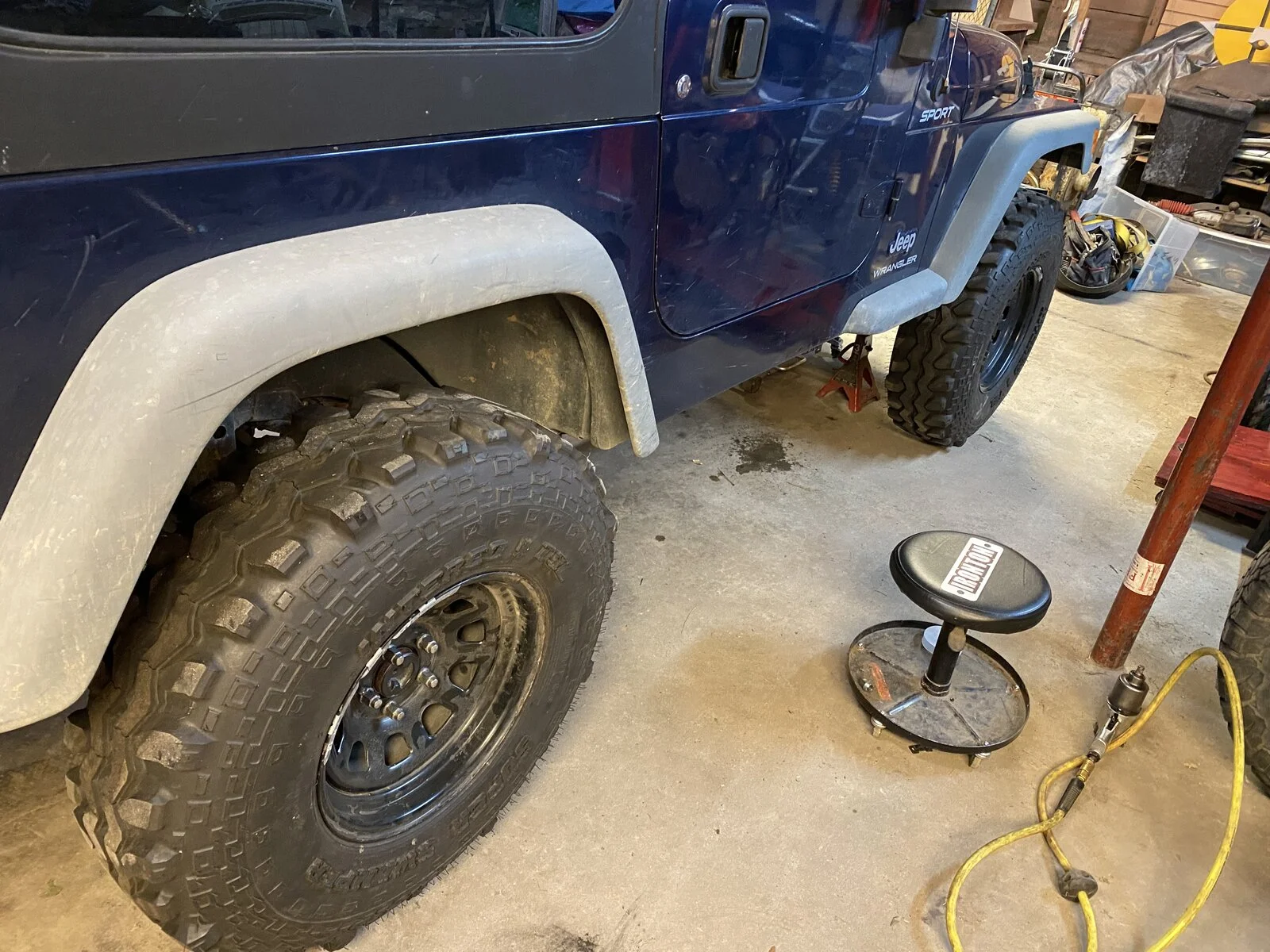

I am currently running 12.5" wide tires on 15" tall x 8" wide rims, 3.625" backspacing. I want to run a narrower tire either 10.5" or 11.5" . Looking to tuck the tire under the jeep a little more. what backspacing should I be looking at for this ?

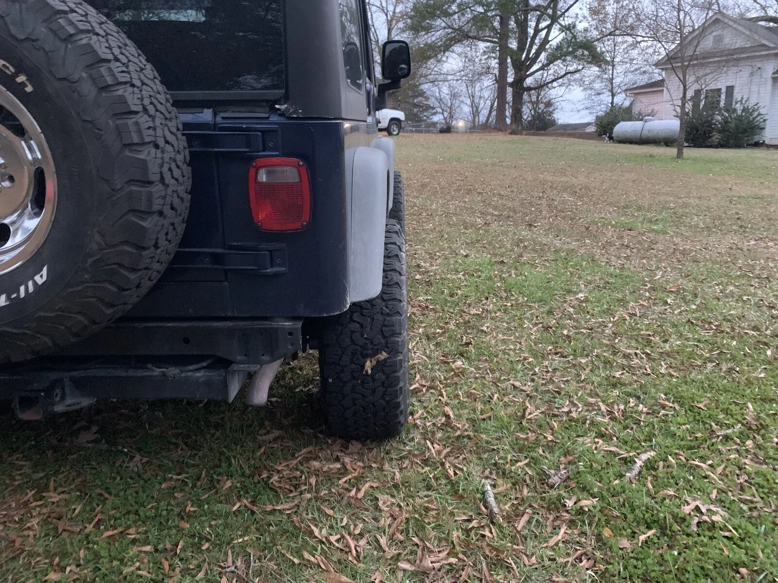

I have 33 10.5 tsl on 4.5 back space and they don’t rub anything

I've run 33x10.50 KM2 tires on stock Ravine wheels. They rubbed at full lock. I would have expected those Swampers, with the big lugs, to have rubbed!

I ran 35x12.50 Goodyear MT/R tires with 4.5" of backspacing. The front tires barely touched the control arms at full turn lock but a washer under the steering stop bolts to adjust it fixed that.
