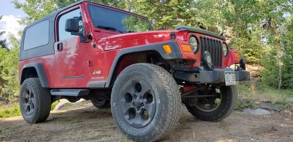

Yeah, look into plasti-dip. My buddy did his rims on his old Bronco, that stuff held up for a couple of years.

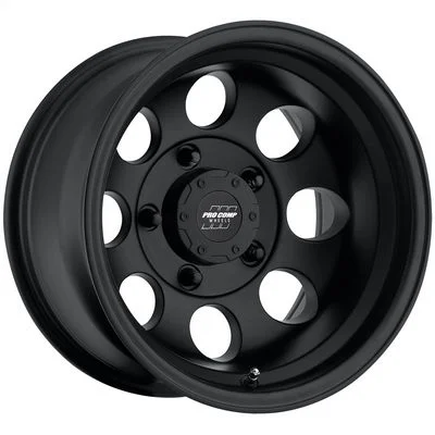

2nd the Procomp wheels. Good price good wheels.

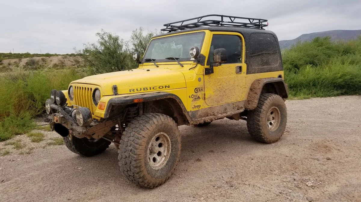

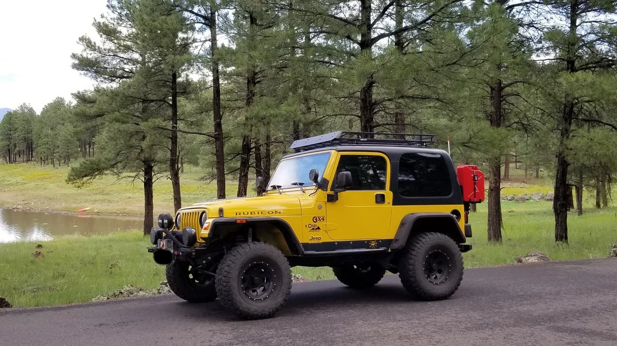

I offroad and use the manual car wash all the time. A couple of mine need redone after 3 years. They all have some rock rash, but paint wouldn't have held up any better in that area and it hasn't started peeling from those spots.
At the car wash, I just don't let the nozzle get any closer than about 6" from the surface and it's done fine. Early on I opened up a spot or two by getting too close trying to move particularly stubborn clumps of dried mud, but since then I've been more careful and haven't had any more of those.
Machined and painted aluminum seem to hold it pretty well. My biggest problem area has been the center caps which are chrome-look plastic. I've never had luck getting anything to stick to chrome long term, but plastidip seems to do better than paint.

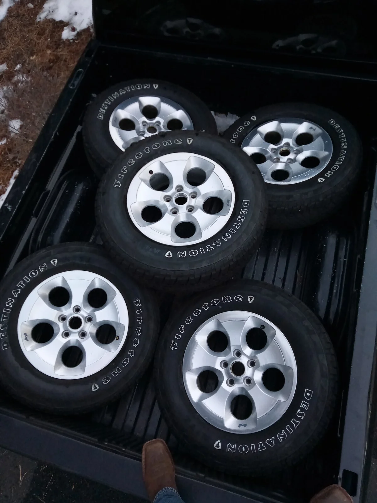

To strip them I just took them to the carwash, put it on High Pressure Rinse and held the nozzle about 1/2" from the surface near the rim/bead until it opened up. From there you can back off and the pressure will get under and peel it off. The car wash got it 80% there, then I went home and peeled most of the rest of it by hand in about 5 minutes. The last bits were in the lug nut wells and were sprayed too thin to peel very well but after spraying it with WD40 and waiting about 5 minutes it wiped right out with a shop towel.
The photo I posted were wheels that were on my LJ when I bought it and I'm selling them. I also did the wheels on my TJ in 2017, which are now on my LJ and a couple are about ready to be redone, but since I'm going to 35's later this year and they don't have the right backspacing, I'm just gonna strip them instead of redoing the plastidip.
