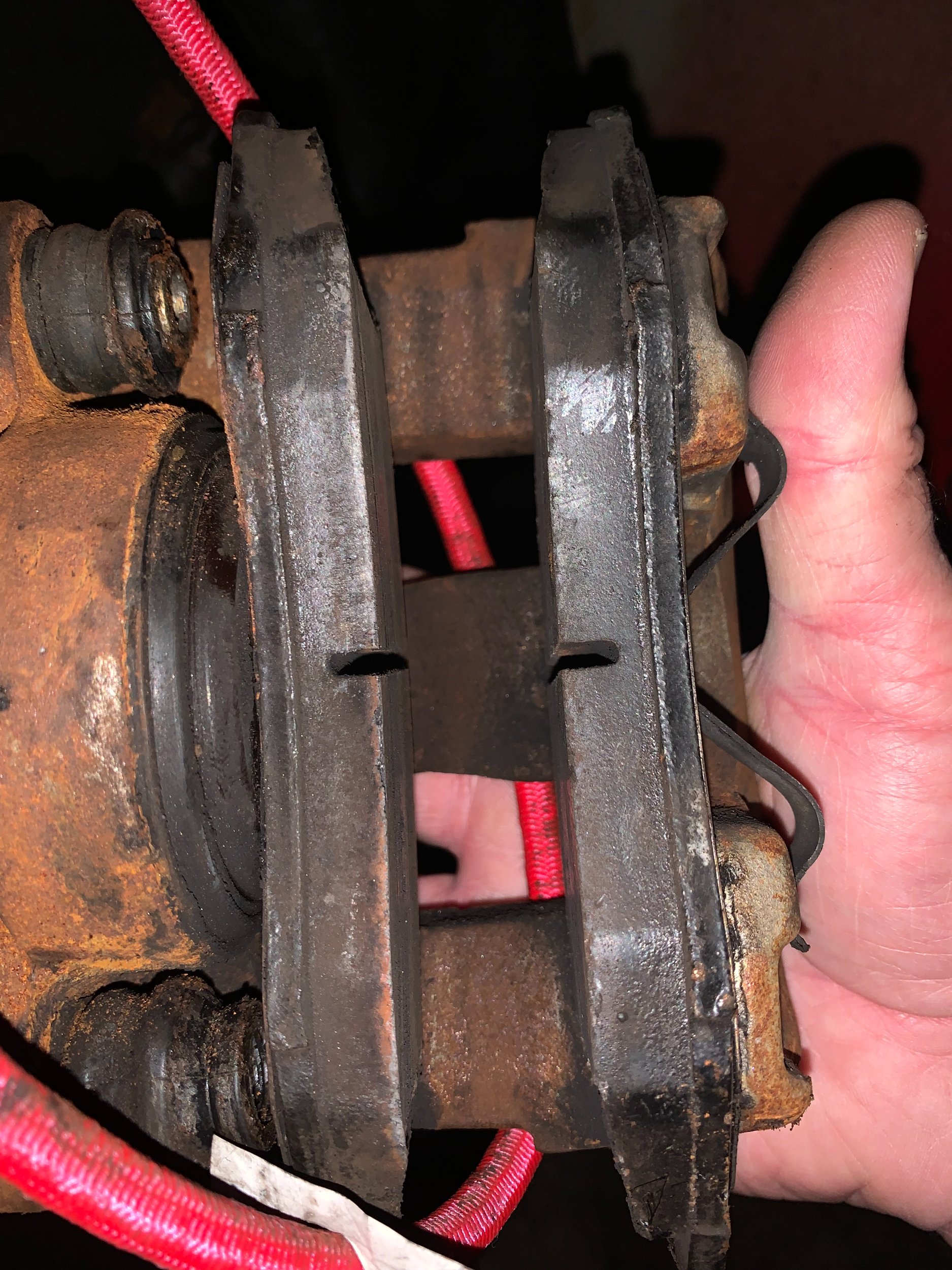

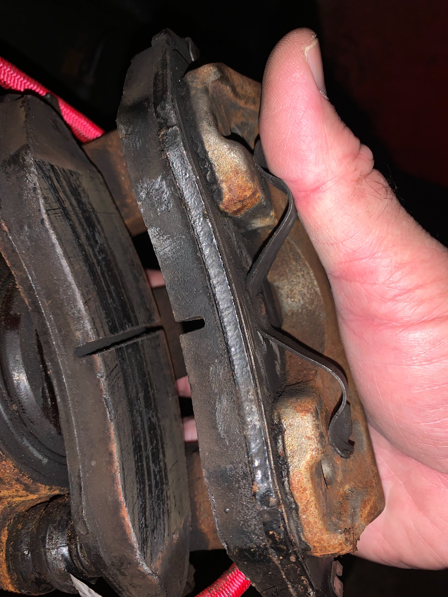

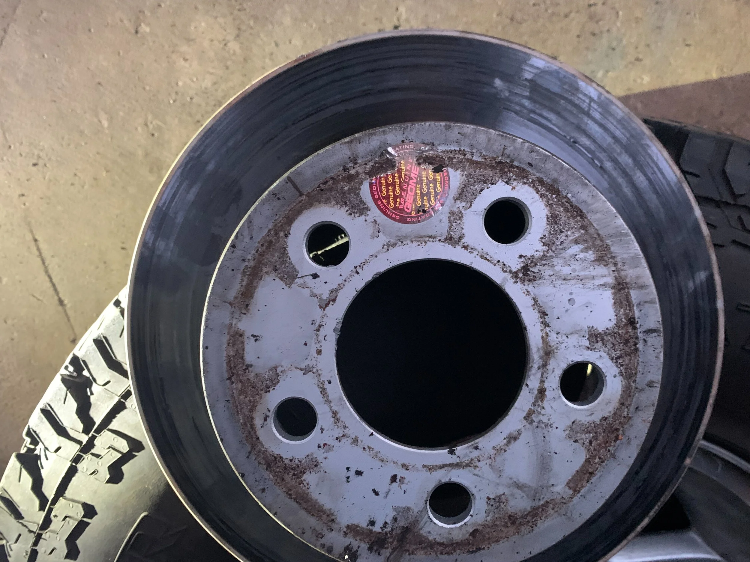

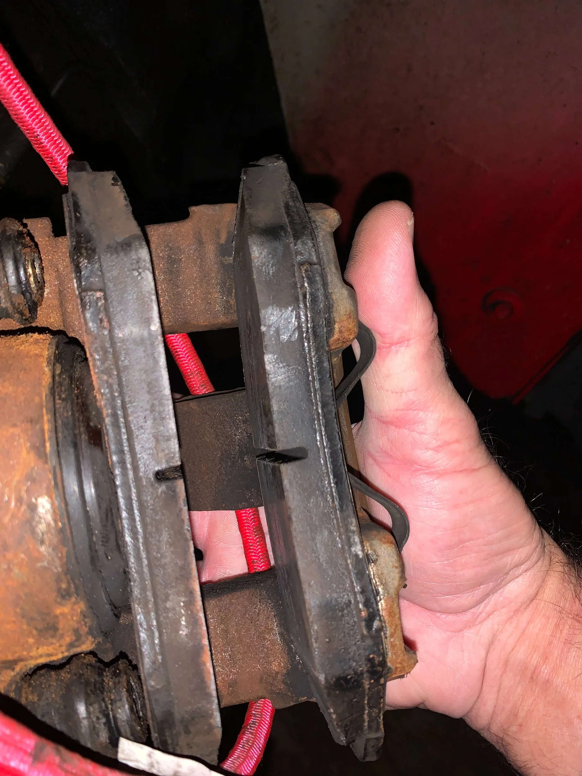

This is what the rotor and pads looked like.

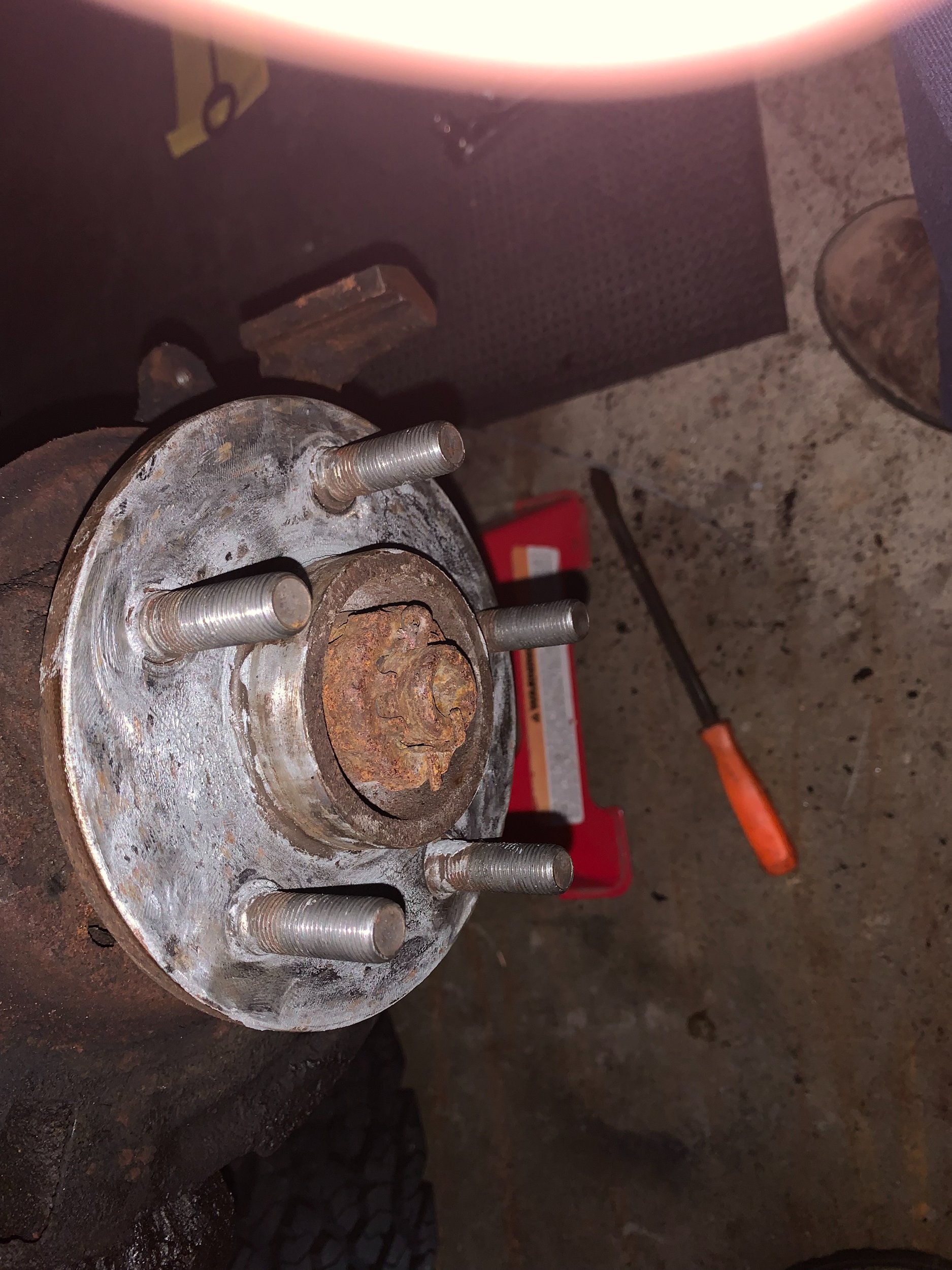

Another thing I noticed when I moved the hub slowly back and forth it feels like the bearing is rough.

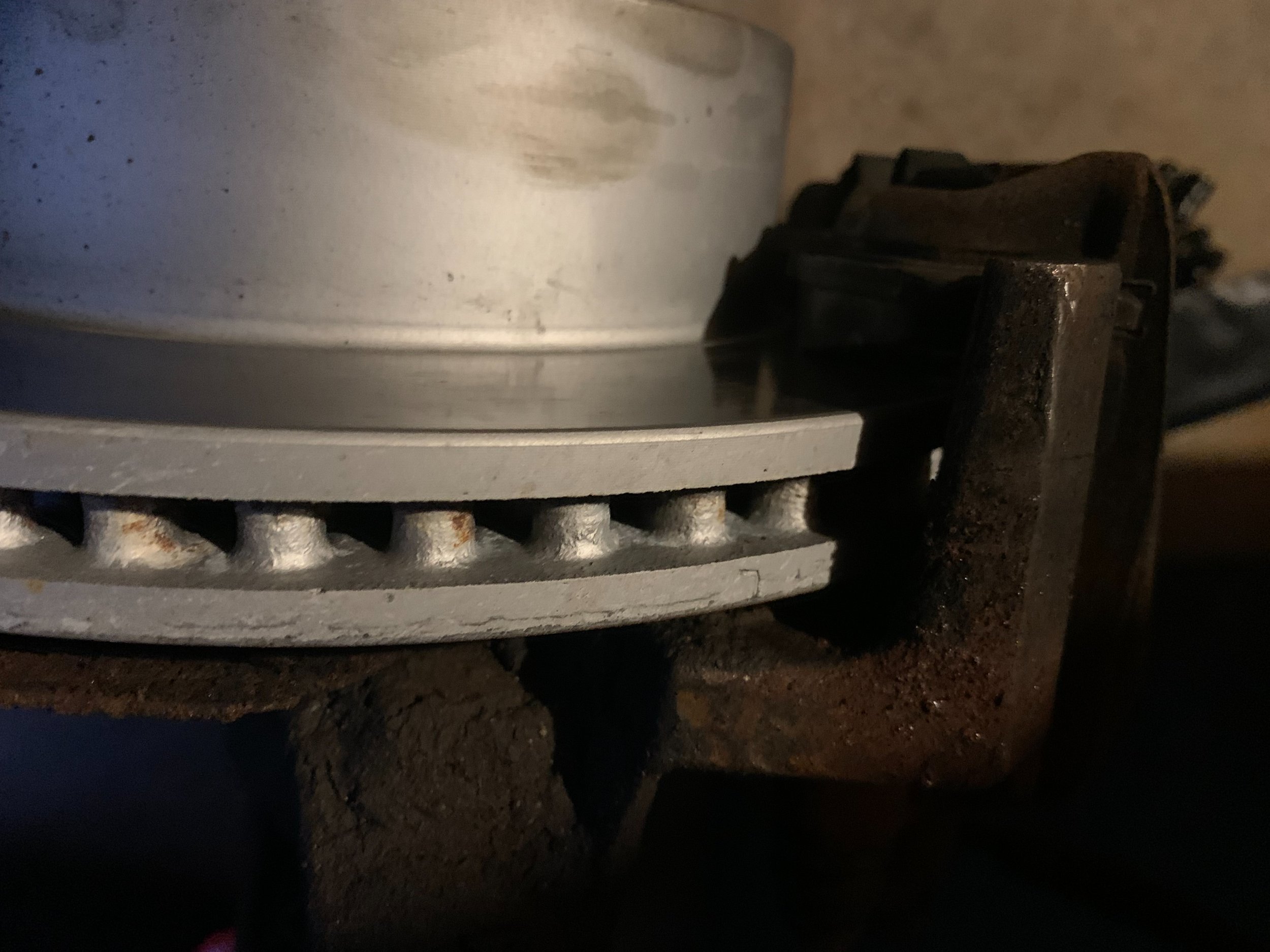

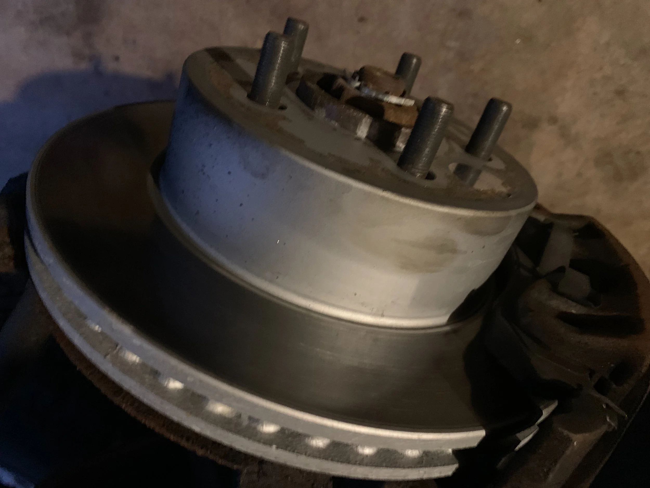

I pulled the passenger side wheel to look at the rotors and pads and rotate the hub back and forth, but did not have time to take the caliber off to allow me to move the hub the same as the drivers side.

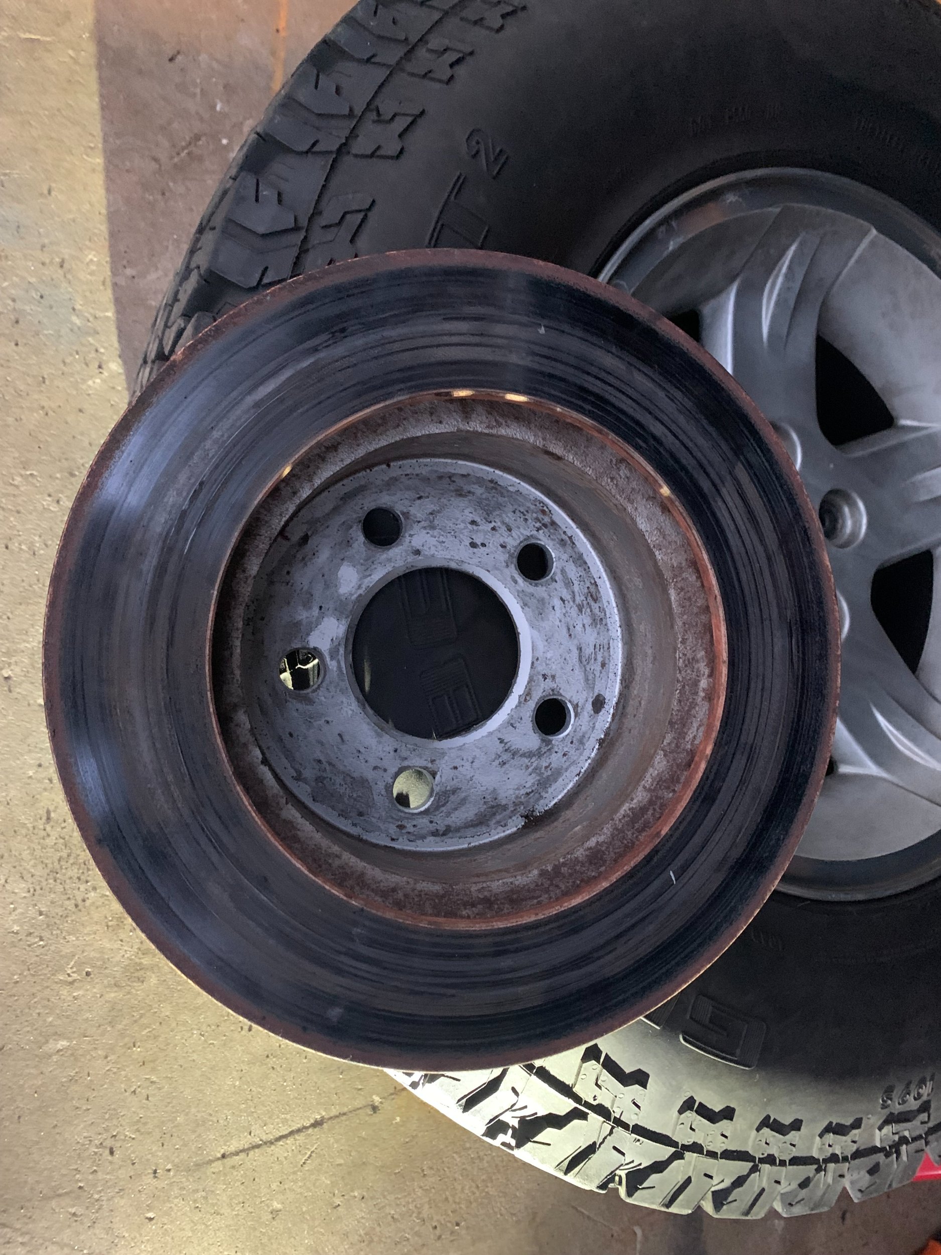

Passenger side rotors.
Both side were replaced 2 years ago and have a little over 2k miles on them.

1. Do I have a frozen caliper? If so can it be rebuilt or just replace?
2. Is the rotor junk and need to be replaced?
3. Are the pads junk and need to be replaced?
4. Is the feeling I have slowly rotating the hub need to be looked at?

Rhythmic grinding in a turn is a a sign of a bad wheel bearing. If it’s grinding when you rotate it by hand it’s toast.
If you can wait a day or two, check rockauto for pricing.
If you’ve gotten this far, you are certainly capable, but I have a feeling that axle nut is going to be a bitch. Hit it with PB Blaster while you wait for the part. I’d be ready with an impact and heat.
Sucks that the pads have so much meat, but I’d swap them while you are at it. You can price check a new rotor vs having Oreillys turn it (if yours still will).
If the caliper is stuck, you can rebuild, but it may not be worth the effort compared to new.
@GATORB8, Thank you for responding. I just came in from removing the passenger side caliper to see how the hub feels on that side. It does seem to rotate better than the other side. So I think I'm going to replace the hub. I sprayed some Kroil on the nut and bolts and will do it again tomorrow hoping removal will not be a pain in the ass, but will be prepared.

What is bothering me is the passenger side rotor still has the crosshatch marks on it and the pads look brand new. I would think with a little over 2k miles the crosshatching would have started to go away.
So l'm wondering if that caliper is frozen also? Possibly from contamination in the fluid? Do I get (2) new calipers, (1) new rotor, (1) new set of pads and new lines and then flush the system per Blaine's instructions I see posted? I really don't want to shot the parts cannon at this.
