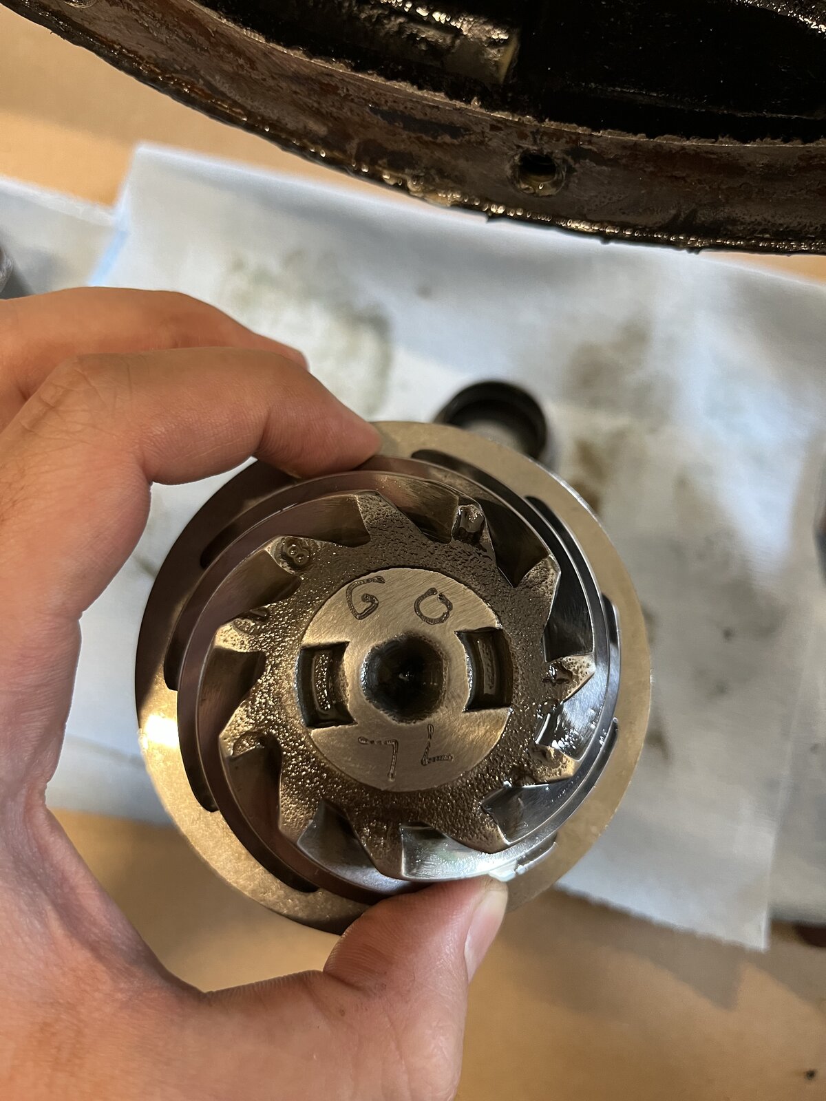

HornedToad TJ Enthusiast Supporting Member Joined Aug 12, 2020 Messages 577 Location Sacramento Jun 16, 2023 #1 I was hoping for a + or - a few thousands to calculate the starting pinion shims but all it has is “7L” ??? Does this mean anything or am I just going to have to do it the long way?

kameronkales TJ Enthusiast Supporting Member Joined Jun 19, 2021 Messages 469 Location Charlotte Jun 16, 2023 #2 Doesn’t mean anything worth caring about. Long way it is!
hosejockey61 FAFO Supporting Member Ride of the Month Winner Joined Apr 9, 2020 Messages 2,780 Location Parker, CO Jun 16, 2023 #3 What you had in there is the best starting point. Reactions: HornedToad
OP HornedToad TJ Enthusiast Supporting Member Joined Aug 12, 2020 Messages 577 Location Sacramento Jun 16, 2023 #4 hosejockey61 said: What you had in there is the best starting point. Click to expand... Thanks. That’s what I used and it was close

Blackjack Evil Winch Doctor Supporting Member Joined Dec 16, 2018 Messages 3,973 Location Kenai Jun 16, 2023 #5 You actually have a goose egg there. Easiest one to work from.
