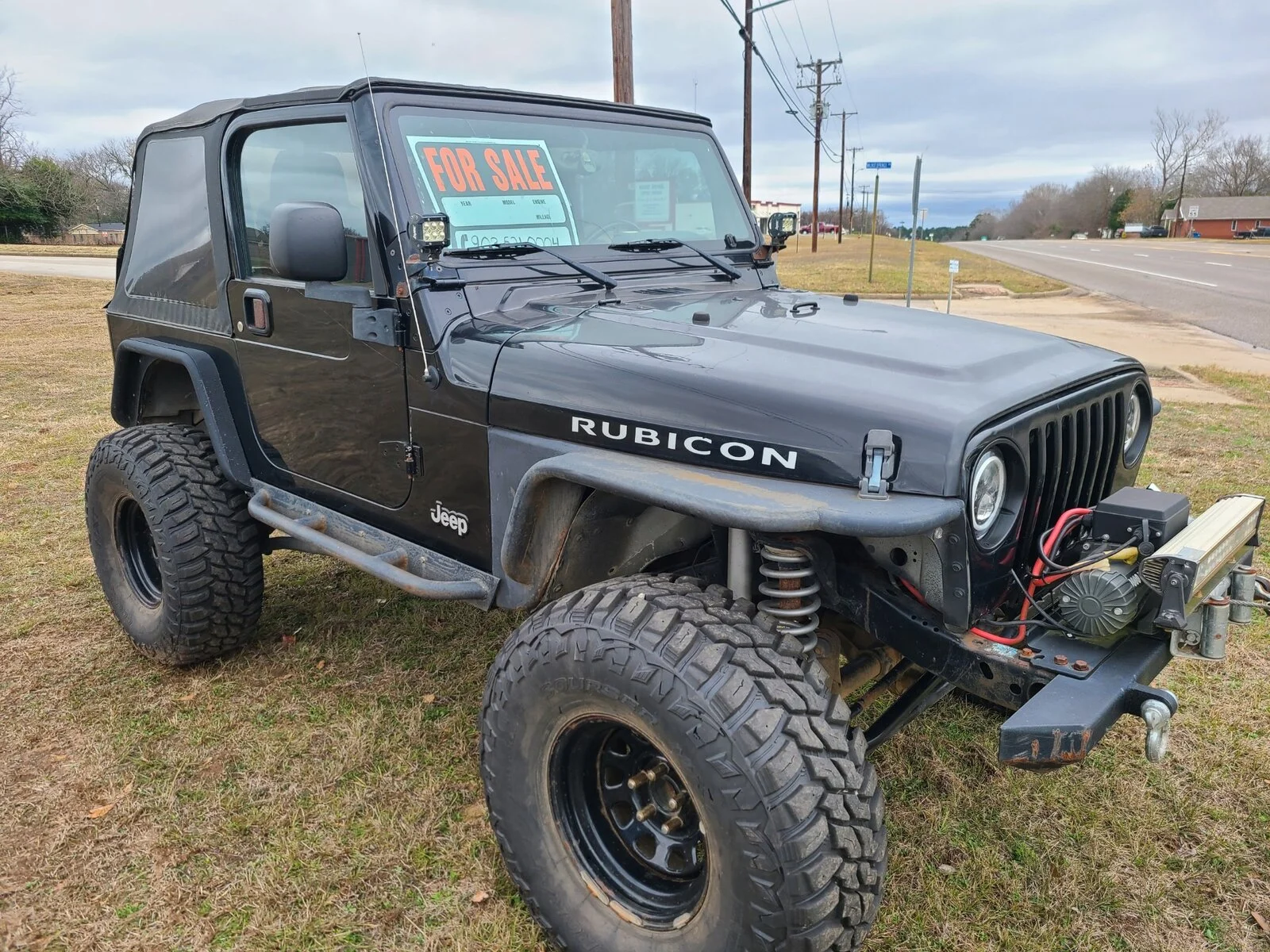

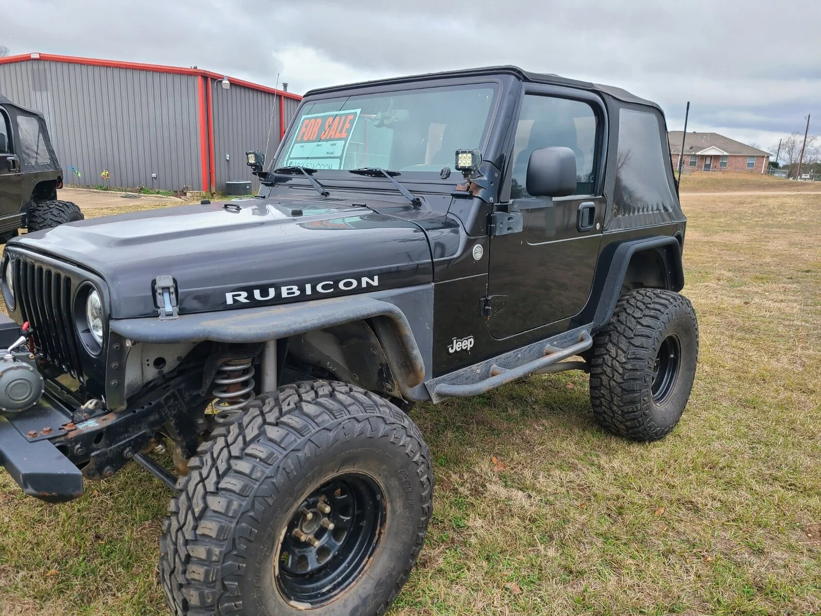

So... been out of the Jeep ownership group for a bit now after my last jeep was totaled and want some advice on this purchase. Planning on pulling the trigger on this 06' TJ on 01/09/21. I have looked at the jeep already and besides the surface rust at the front end of the jeep it is a solid frame from what I am able to tell. The rear frame hole where everyone seems to find rust is completely rust free. Downside is this was a trailered jeep to and from wherever it was wheeled and the current owner, a shop in Texas, doesnt know much besides what lift kit, Rubicon Ex long arm kit, and possible 4.10 gears it has as they have not opened the diffs to confirm.
My concerns are if I am jumping the gun to get back into the Jeep ownership with the quoted price of $6,000.
Problems that the shop that has this jeep that it death wobbles at approx. 40mph and if I want to drive it on road are that it has a spool rear locker that keeps it locked at all times. The shop has offered free labor on replacement on this locker to go back to the factory electronic locker and to ensure that it it does not death wobble anymore. The shop says that all they have to do is rotate the axle to prevent this but in my experience that is not the only reason for this.
I would appreciate any advice good or bad towards this purchases. I will say that I am not opposed to a project jeep so long as it is not a huge project to undertake.

I need to see more photos of this thing especially underneath. I want to see the frame in detail, the suspension, and the steering. Until I see that, I'm not going to say too much other than it's $6000 for a reason. It looks someone didn't care about it at all. Because of that, my guess is that it's going to have lots of things that need to be fixed, more than just meets the eye. I'm also guessing there is rust in places that may not be immediately noticeable just given the way it looks on the outside.
The Rubicon Express long arm lift is a piece of crap and belongs in the trash (sorry to be blunt, but it does). Is it a real Rubicon or not? Have you verified that it has a 241OR transfer case? That's an easy thing to swap out that someone may have taken from it.
My general experience with vehicles is that if they are very, very cheap, they are very cheap for a reason. Sometimes you get lucky and someone is selling it for dirt cheap because they want a quick sale. Other times it's because it has a lot of issues they know about that they might not be willing to disclose.
The general rule of thumb is that if you buy something like this for $6000, you can probably expect to put another 6-8k into it to get it where you want it to be. Of course that's not always true, but I find more often than not it is (and it doesn't just apply to Jeeps).
How many miles are on it? Have you done a compression test or a leak down test?
Sorry, but the price and the condition just instantly raise a red flag in my mind, hence all the questions.

The mileage on it isn't bad but the condition of how it looks says those have been some HARD miles. I'd go back and relook at it and take a TON of pictures from front to rear so we can get a better idea of it's shape. I'd also ask to be able to take it to another shop to have it inspected. It might cost you $100-200 for that but then you'd have a better idea of any MAJOR issues. Ask them to do a compression & leak down test. Plus I'd want to know what gears are in the axles. If it really is a Rubicon it came with 4.10 gears stock.
And as Chris said it should have a 4:1 transfer case in it also if it's a Rubicon.

No front anti-sway bar or Antirock? Low mileage doesn't matter if a lot of those were hard offroad miles. I'd pass on it for any price. Too many things to fix from day 1. My mint Texas Rubicon was $9500.
