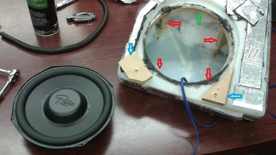

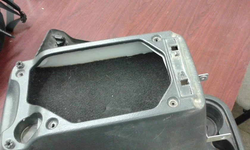

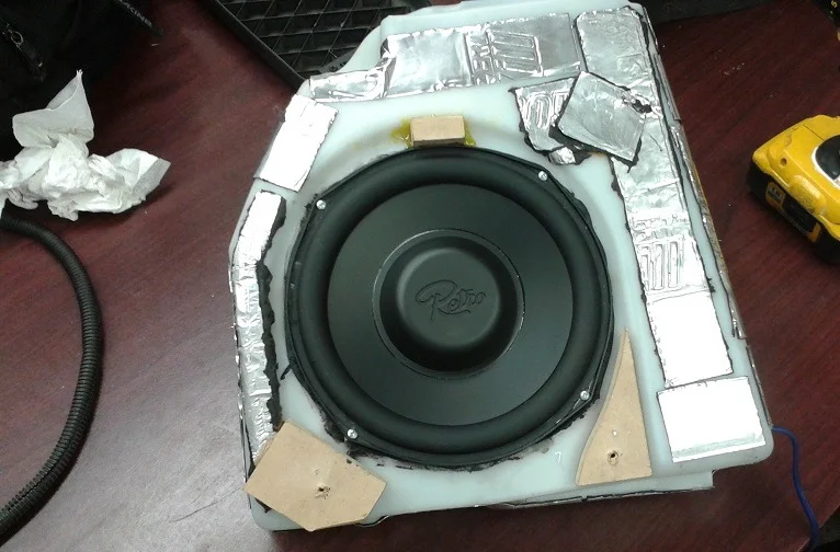

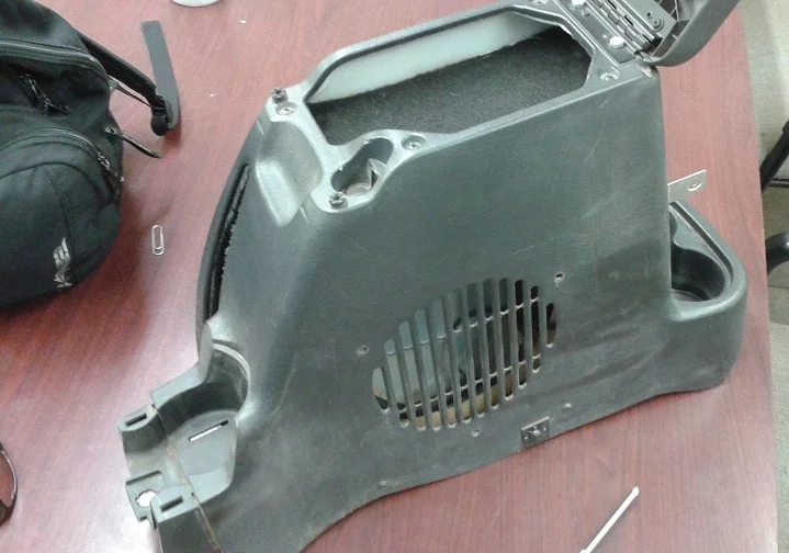

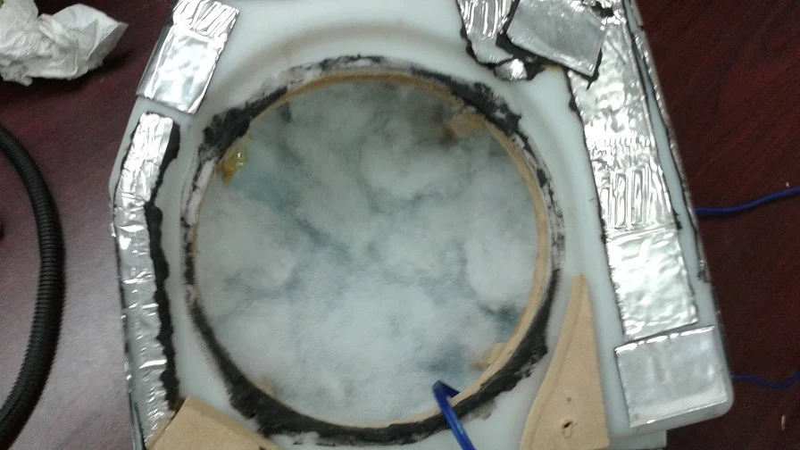

I put a slimline 8" sub in my center console. Required some minor fab work, but nothing too difficult.
