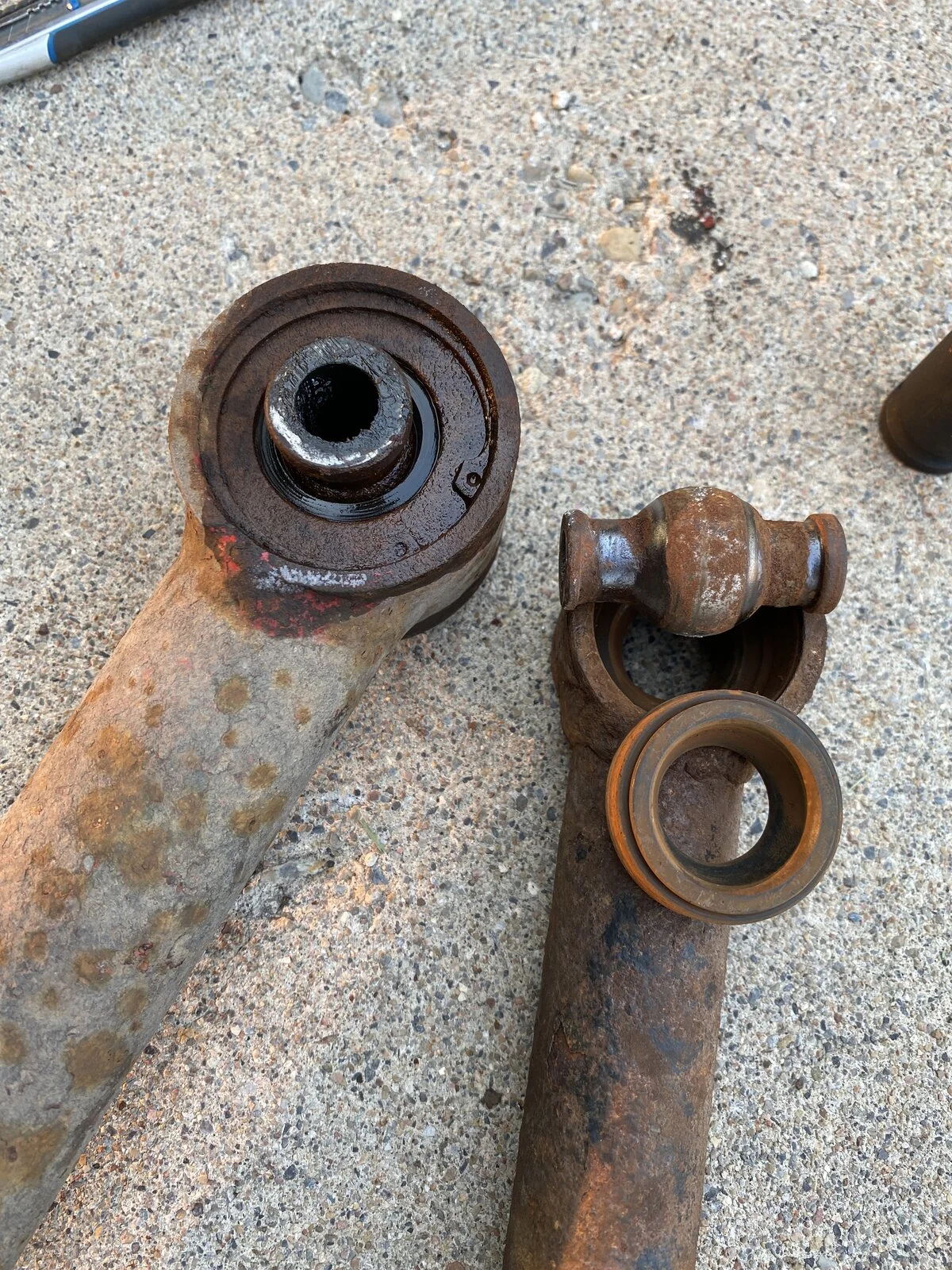

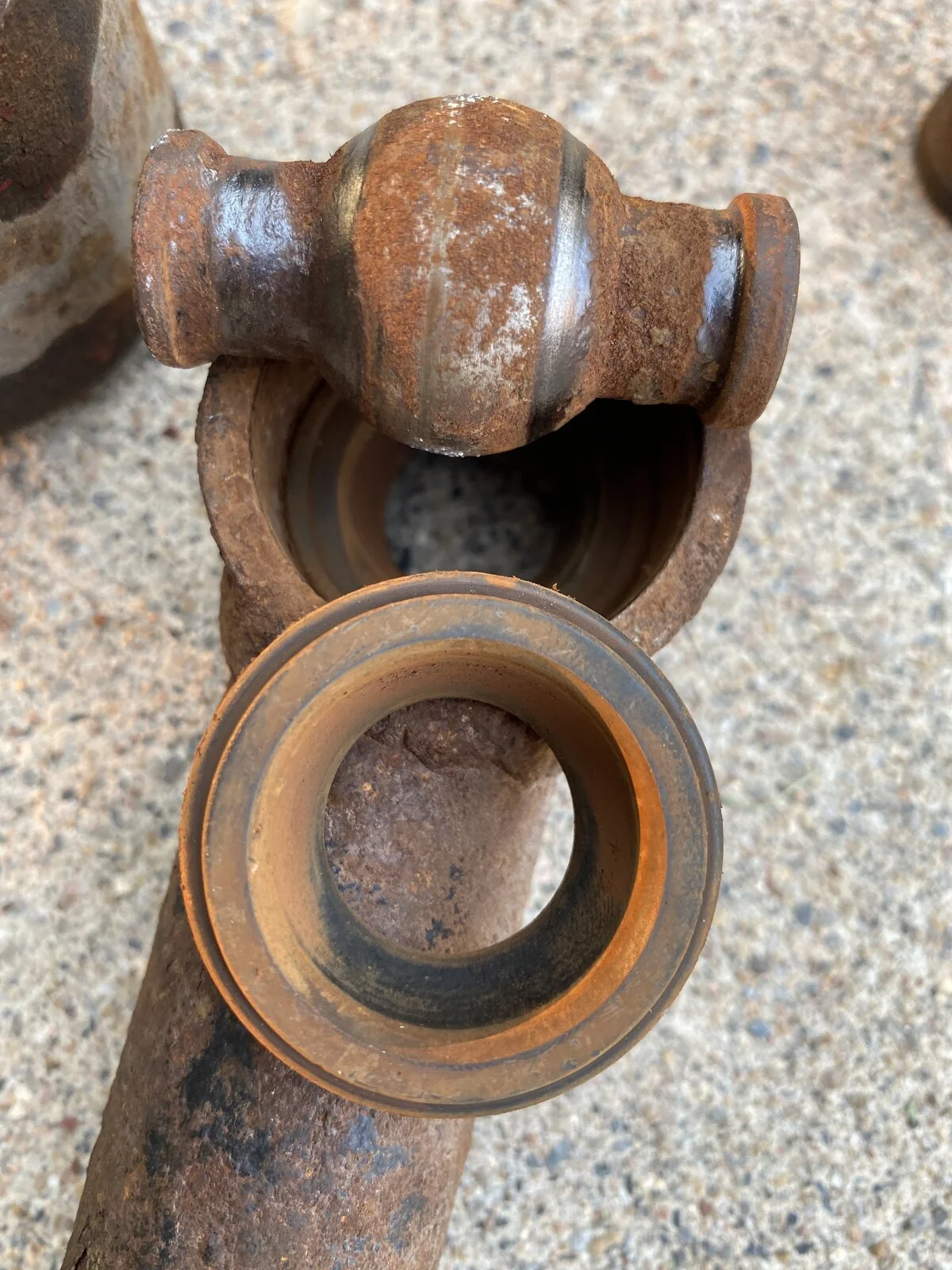

I am currently in the middle of some suspension maintenance and need help identifying a flex joint so that I can get some rebuild parts for it.

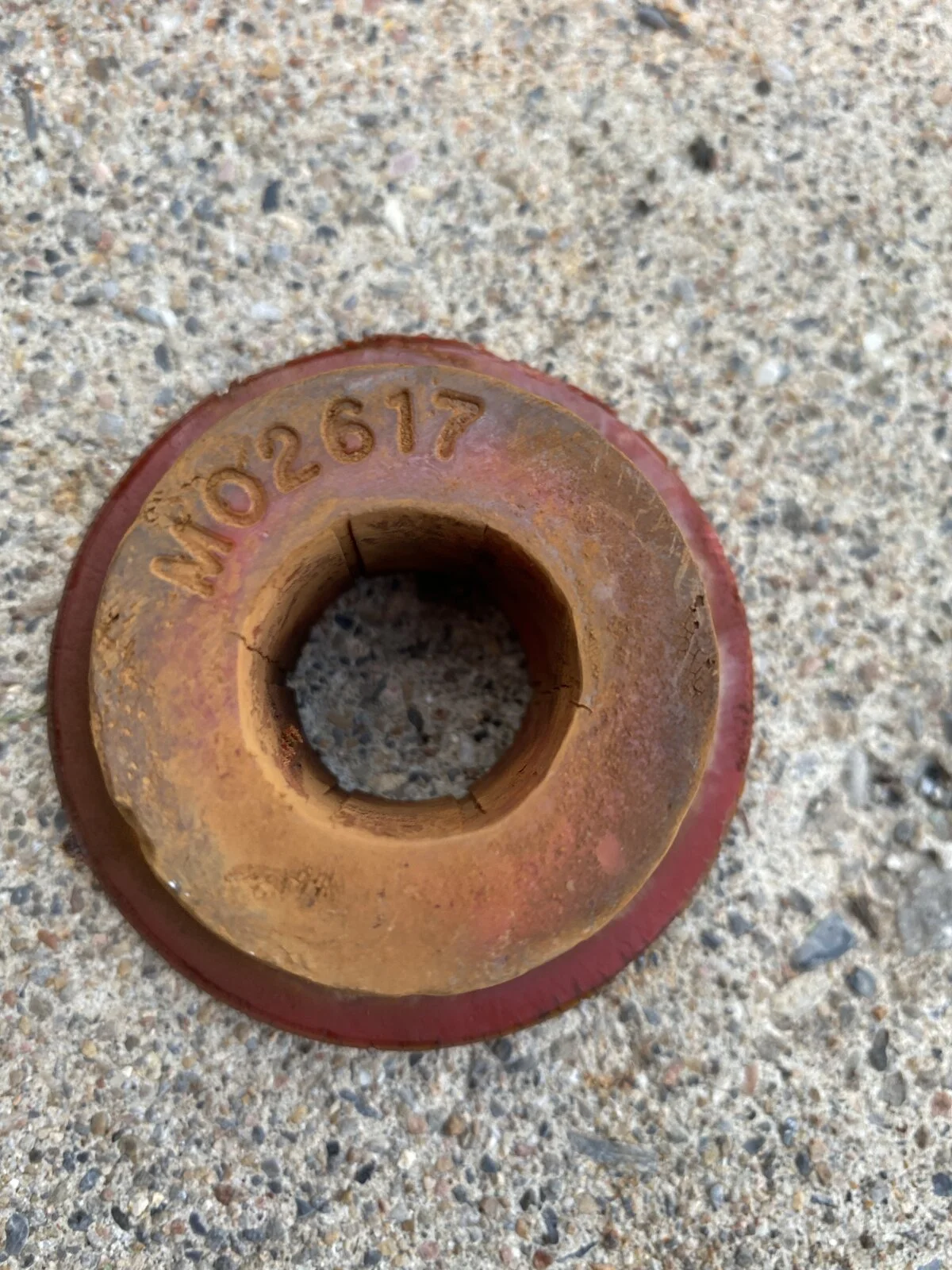

Also, can anyone name the bushing in the last picture? I typed in that part number in a Google search. Lots of bushings come up, but none with the same part number or dimensions, at least not that was obvious.

Looks like a Teraflex joint... Google teraflex control arm joint rebuild kit
That's what I was assuming too, but just wanted confirm as Teraflex is experiencing some shipping delays. I didn't want to wait 2-3 weeks to discover that the parts they sent are not correct. Maybe I will try to give them a call on Monday. They are less than 2 hours away from me.
I still need to identify the M02617 bushing.

Having looked more on the Teraflex website, I am begging to believe that these are NOT Teraflex joints. At least not the current iteration of it.
My joints have c-clips on both sides, and the urethane bushings are different. It looks like the current Teraflex joints only use one c-clip.
My long term plan is to have some aluminum arms made and replace all the joints with Jonny joints. I may have to move u my timeline for that.
