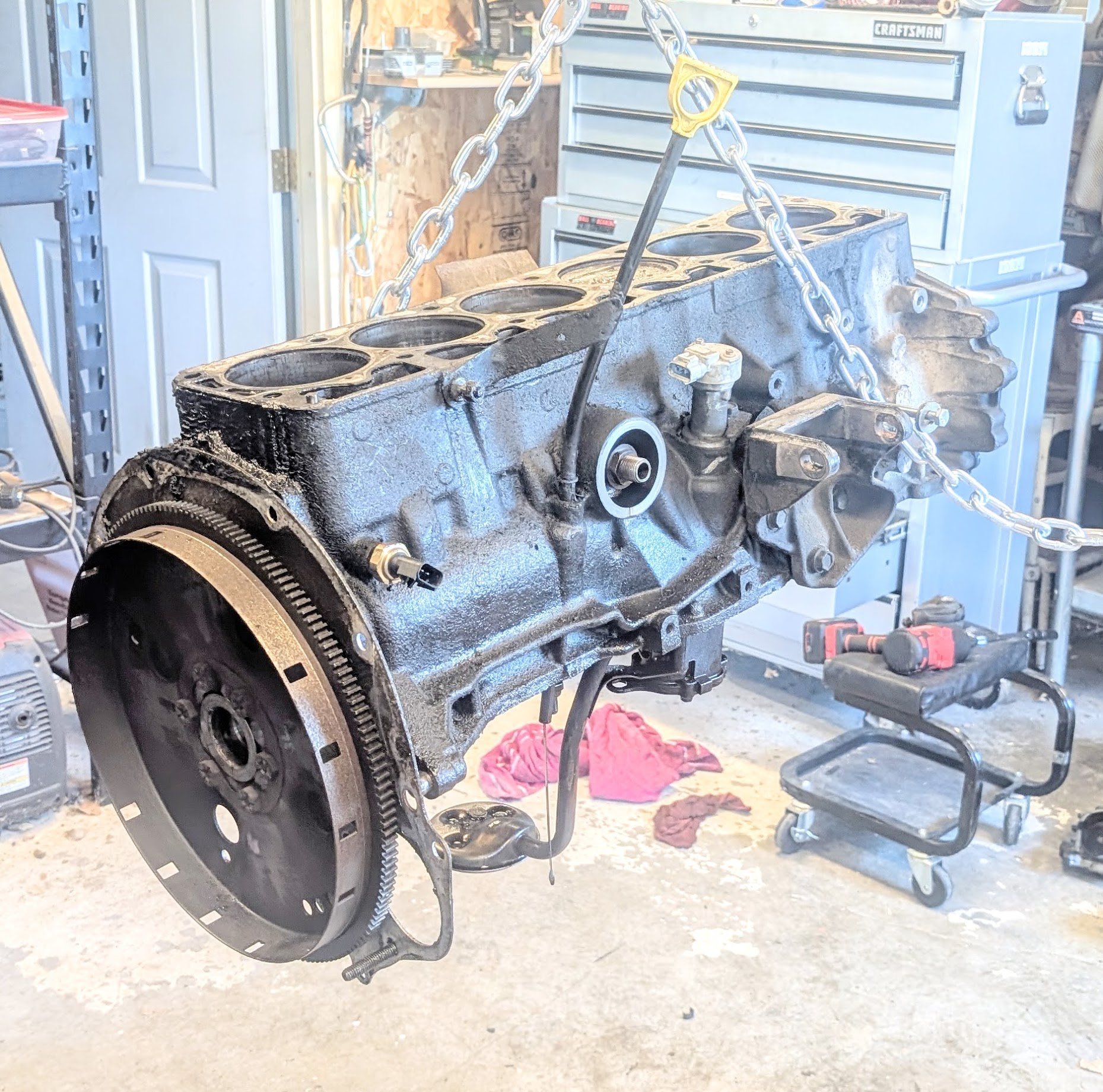

Photo showing the blown engine out prior to removing the Starter Ring and plate. Still can't quite tell the emboss orientation in this photo either.
It looks like the ring gear will move toward front/back a significant amount depending on which way you install it. Can you eyeball the starter to see where the ring gear has been running against the starter gear?
I haven’t done an auto in a Jeep only chevys and dodges. The converters I’ve done require a three step install. As you turn the converter you’ll feel three steps in as you push in and rotate.
Same here. And on the engines I have worked on, the bolt holes in the crank flange and flex plate are slightly offset so the flex plate can bolt on only one way, so it can’t be bolted on backwards. I have no idea if the Jeep is the same way.

Holy Shnickies!! Got impatient and went out and pulled the again. Here's what i learned. The Starter Ring is wedled to the Deep Drawn pan, im calling the Cranshaft Position Plate, due to the square holes in the side wall for the position sensor. I CAN'T flip the part around because everything would be backwards. So the orientation was correct. I'm calling it the Starter ring gear and the Crankshaft position pan welded together, the "Starter Ring Gear and Crankshaft Position Pan Weldment".

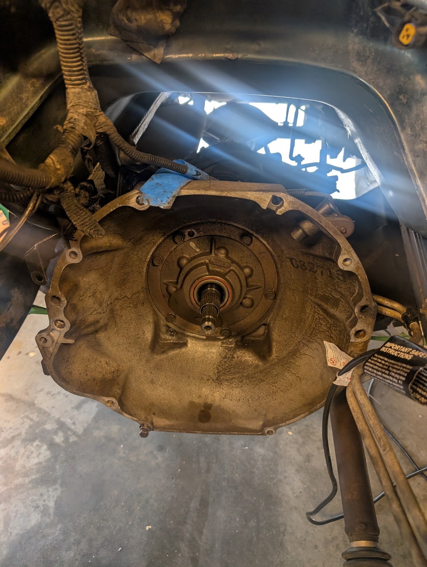

So why didn't the Plate and TQ get close enough for those 4 short bolts. I thought the TQ was fairly stationary. SO i tested that theory and it cam right out. Slid right of the spline shaft going into the transmission. So then i took just the TQ and placed it up against the Starter Ring Gear weldment in the back of the engine, and low and behold they're close enough for the bolts to engage properly. I had no idea the TQ could move so freely. I'm hoping this is normal and not another problem to deal with later.
Photos show the Ring gear and plate weldment, with shim, together and proper orientation. As well as TQ out of the tranny.
**I think the Weldment i keep discussing is simply called a flexplate. As i was reading other posts today, i see they are having a lineup issue, which allows me to check that again before dropping the engine in again.

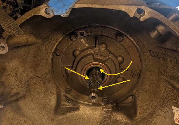

Take note of this when reinstalling the torque converter into the transmission.
I don't quite understand what that means. It sounds like there is a push in and turn, push a little more and turn type of procedure. It slid all the way in, at least i think it did when i put it back. I'll read around see what i can find. Thanks.
The FSM shows how to take a measurement to see if it’s set in, but it’s basically like 1/2” behind the plane of the bellhousing. Once it’s in it shouldn’t just fall right out. Usually takes a decent amount of effort to pull it back out.
Glad you figured out it was called the flex plate. I didn’t know 100% if the tone ring piece was separate or not, but I guess we know now.
As long as we’re talking about it, please lube up the TC about & the pump seal before you mate them, or else you’re gonna be doing all this again.
I'm about 50 years rusty since I did this, but here goes anyway:
The torque converter has to align, internally, on the first splined shaft, and then on the second splined shaft, and then on the flats/slots. As you slide it in, you may have to turn it at 3 different places.
Just push, rotate, jostle, & finagle until you feel it drop into all the spots.
Remember to lube it up first.*
* also applies to torque converters
Reactions: TJ Jim
One final update. Was able to get the TQ to insert properly. I now understand teh "3 steps" to install/insert. Step one the first smaller spline, Step 2 the lager spline, step 3 the flats on the shaft lining up.
Once the engine was back in and tightened up mostly, the TQ was still a bit to far back. To get it to come forward easily, i bought a bolt same thread and pitch, but longer, put it in and gently pulled the TQ forward to meet the flex plate, Slid forward with almost no effort, about 3/16" of movement forward, and then everything lined right up.....
