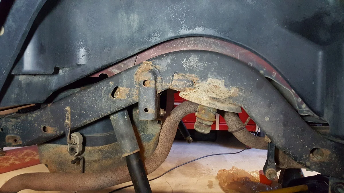

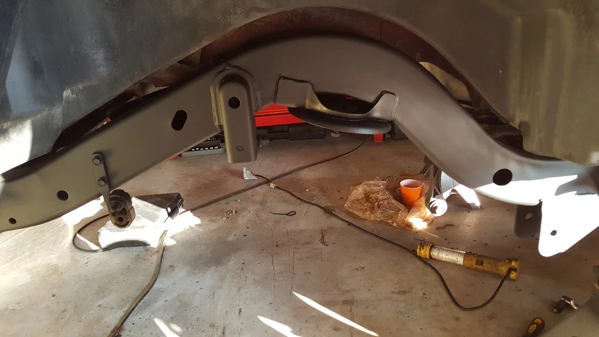

You don't have to do a frame off. The beauty of the TJ is you can get to most everything easily. The only real hidden place is above the gas tank. Remove it and you can get to what you need to there. Most of the rust treatment/prevention requires simple tools and lots of time and elbow grease. Bottom line, do the work yourself. You'll learn a lot in the process and save a ton of money. I've showed this before, but here's an example of what $25 worth of rattle can paint and numerous hours work will do to the outside of the frame. For the inside, I probably spent about $150 on Eastwood internal frame coatings.
The caveat is I also used a 4 1/2 angle grinder and flap disc assortment, along with a cordless drill and wire wheel assortment.

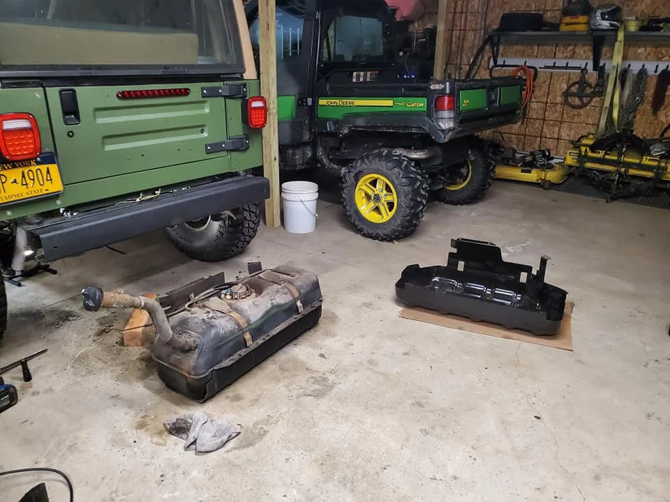

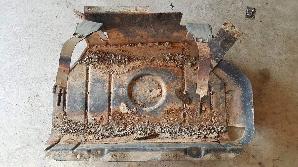

Per my previous comment about the gas tank, here's a view of what's potentially lurking in the bottom of your stock gas tank skid.
Fortunately, Savvy has the best cure for this problem!

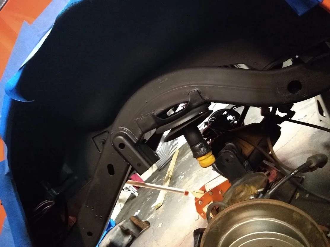

I just went through mine the exact same way. If the frame is solid, you can make a lot of improvements and preserve the Jeep for many years by laying on your back and suffering through surface rust clean up, and repainting of components. I too used a lot of Eastwood products on the frame and bottom of the tub - internal framed coating and rust converting spray, and then giving the bottom of the Jeep another good coating of rubberized undercoating. It sucks, but the work is well worth it in the end.

I'll recommend against using that Eastwood internal frame coating, or any other type of hard paint like coating inside of your frame. If you can get the inside spotless that's one thing, but it sounds like that is not realistic for you. Clean out as much as possible, then use either Fluid Film or one of the several Cosmoline sprays available. Any hard coating, any, will trap at least some amount of corrosion between the inside metal and the hard coat allowing rust to go unchecked while all the time looking pretty in there. Using the Fluid Film will soak in and smother the rust blocking oxygen from the metal. And it can creep up and also into any small crevices to stop the rust. Plus you can see if there are any area that might need a heavier coating where you might have missed earlier. And you can apply more with ease. For the body and any exterior rust you can clean, spray a self etch primer and then paint over that. Those areas you will be able to see if the rust is blistering under the hard coating. But I would still use (and I do) the Fluid Film for everything underneath the Jeep. That allows me to use a long wand they sell online to get in the torque boxes and every little seam with the FF and block the rust. It's easy and much cheaper than using Eastwood products. I had tried them on a different vehicle and had extremely poor results even when cleaning to bare metal. Others claim good results. I only speak to my experience. FF on the axles. On the steering components. Inside the doors. Behind the gas tank. You get the idea.
I do recommend dropping the fuel tank to get any rust back there that can hide from you.

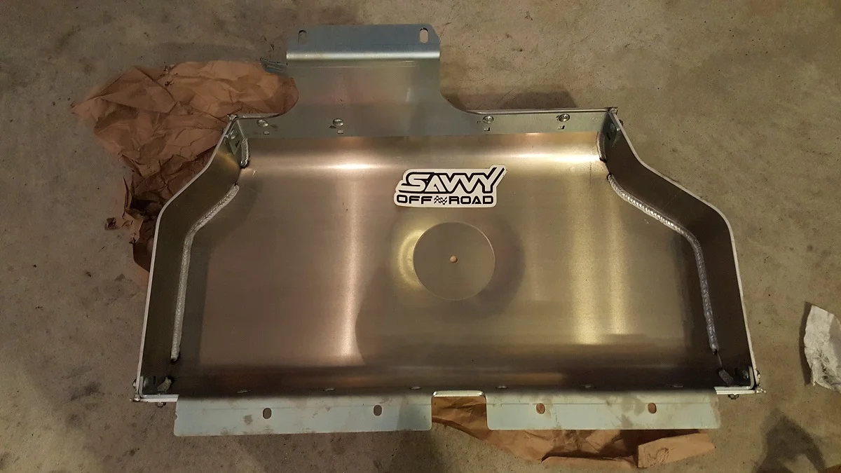

Is the gas tank skid similar to the transmission skid insofar as if you drop it, you need to support the gas tank? Or can you drop the gas tank skid by itself without having to support or mess with the tank itself?
Rustoleum products are as good as anything imo.
Also vote for fluid film, its nontoxic. It's essentially lanolin which is wool oil, sheepskin sebum gross. But it wont poison you or animals.
CRC 06026 Heavy Duty Corrosion Inhibitor is awesome to spray fasteners with. It forms a more durable waxy coating than fluid film so it wont wash away as rapidly. It's like cosmoline aerosol. Probably toxic though and tuffer to clean up when you get to being a mechanic.
https://www.amazon.com/gp/product/B0000AXYA0/?tag=wranglerorg-20
Reactions: fourpointzero

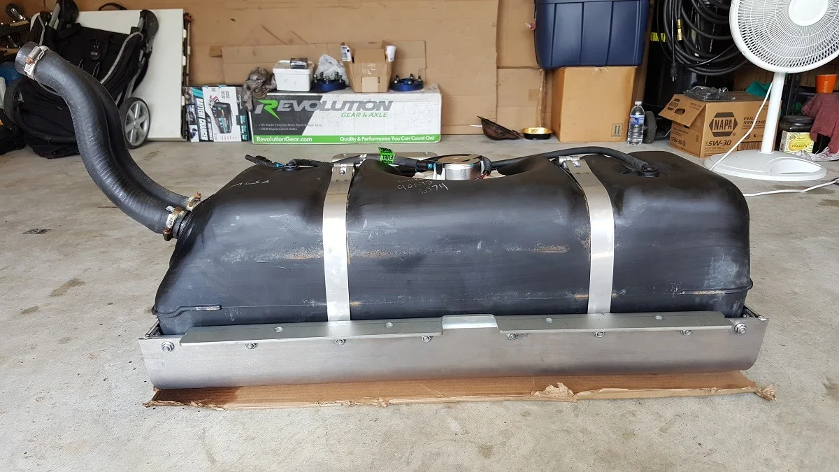

The Savvy skid is like the factory one, in that the skid is what holds the tank up.
Sorry, meant stock gas tank skid specifically but I think you answered the question anyway. Glad I didn't pull it recently like I had considered...I didn't know it was supporting the gas tank itself, thought it was just covering.
Yup, the stock skid holds the tank in place with two straps at the top just like an aftermarket. There is a quick disconnect for your fuel line bundle, evap line and electrical. A few bolts and its out.
