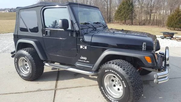

2006: "everything works and kept in garage" from add. Lift with no more info given. Currently has cheap looking chrome bumpers and side steps that I don't like. Wheels and tires are good looking all 5 match, interior is a little beat up. Does have A/C but no cruise control

Between a Sahara and a pretty much brand new TJ; its a hard choice, but i'd go with the '06. The one thing that I dislike about my '02 is that it isn't the most "up to date model" TJ (which the '03 to '06 models are) - with the bigger bucket seats, the bigger side view mirrors tailgate vent instead of a hard top vent, trail rated badge (even though its stupid really, factory added 'anything' is cool in my opinion), and the fact that an '06 is the least aged TJ you can possibly buy.
And, with that nearly brand new '06, you can keep it garage kept and make sure it stays real nice and untouched; my Jeep was very clean when it was purchased, however, it wasn't garage kept and you can tell it in the paint and the frame.
Whatever you buy, show pics of when you take it home!
...And, if you do buy the '06, take off the sacrilegious Smittybilt bumpers ;)

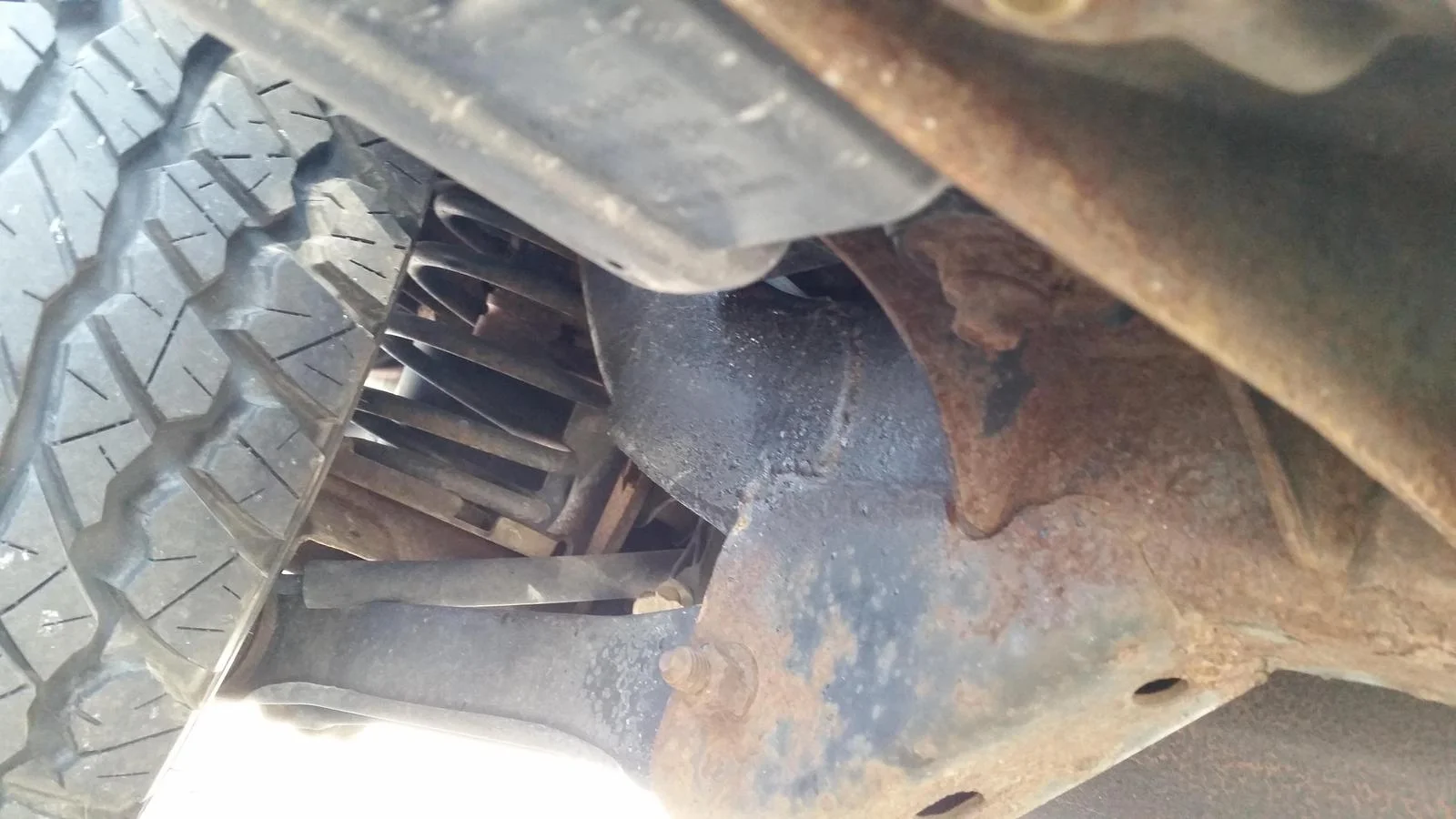

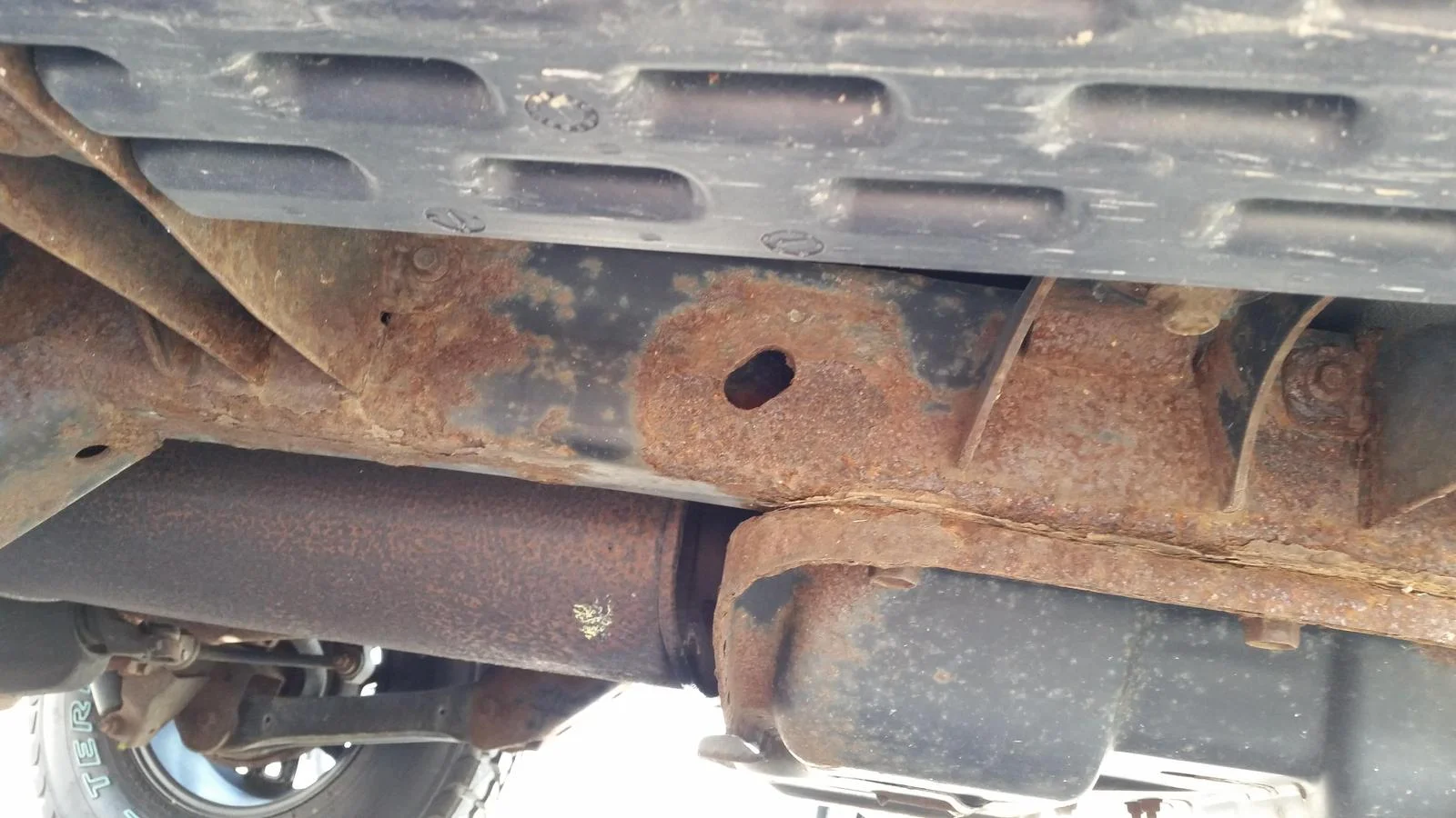

Well it has a Dana 44 and comes with a tan soft top. He said the soft top had some mildew though. Drove pretty nice to me. Shifted smooth and quiet, ran quiet at idle and no ticking or out of place noise under acceleration. The front diff looked oily and dirty on the bottom half mostly at the seal (not sure if this is normal but didn't seem like it to me) also look at what shape the frame is in...
Looks pretty bad to me. What do you guys think?
He said they did prophylactic frame patching here to prevent frame rot. From the previous picture looks like it was a little late.
Look inside the holes on the frame. If the metal is delaminating I would just thank them for their time and walk.
