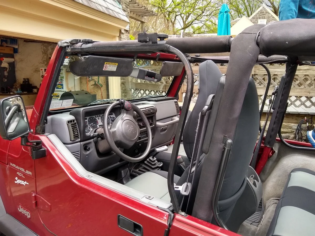

Hi gang! First time jeep owner here. Bought a 98 TJ with 105k miles and I have to say Its a great little ride. My boys are pumped about it. There are holes in the soft top so It will be topless for the summer.
Any way I got into it a little bit and have a ton of questions. Paid way under market value so assumed I'd find some surprises. First I swapped the rusty shocks and leaky steering stabilizer. I also ordered the 36mm socket to take the hub off to inspect the axle shafts. It also has an exhaust leak somewhere and I think it may be where the manifold meets the downtube. It was all wrapped in heat tape, no idea why. The downtube also has patches and just looks terrible. It will be the next thing to get swapped. Anyway thanks for having me I really value a great online community to help he out when I have questions.
Here are a few pictures,

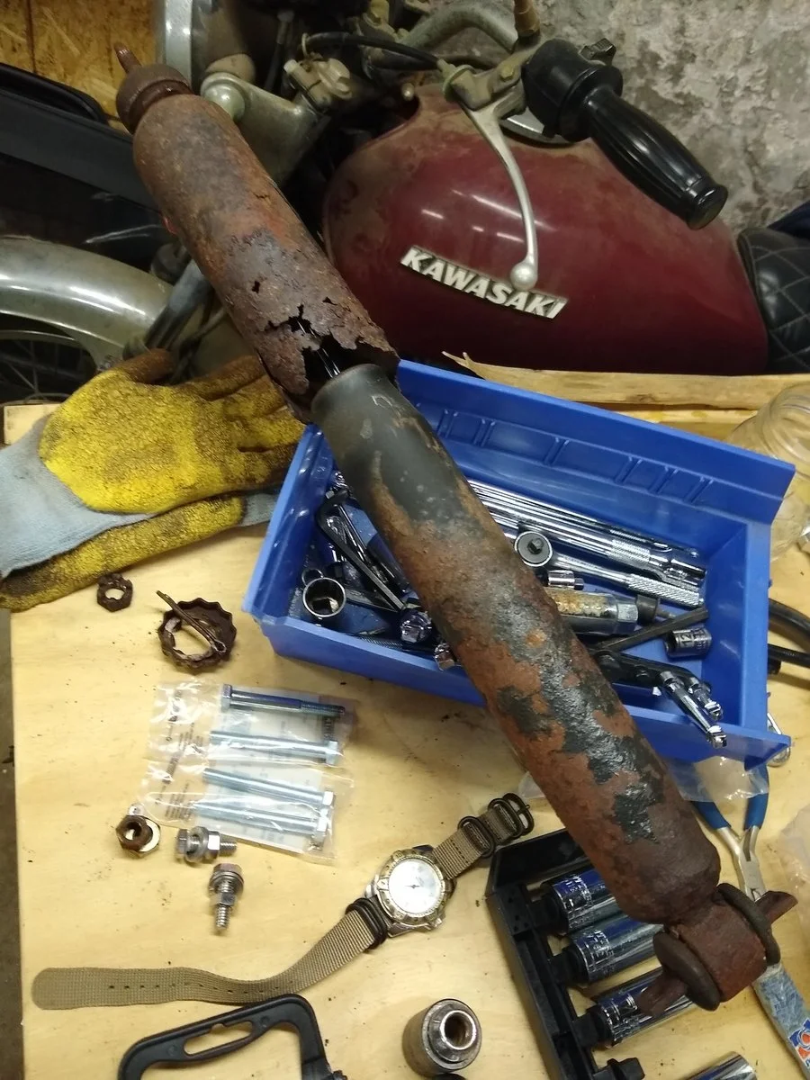

So that was the good , now for the BAD. Way over due shock replaecment. Pushed them in and zero rebound. Pretty sure they are original.

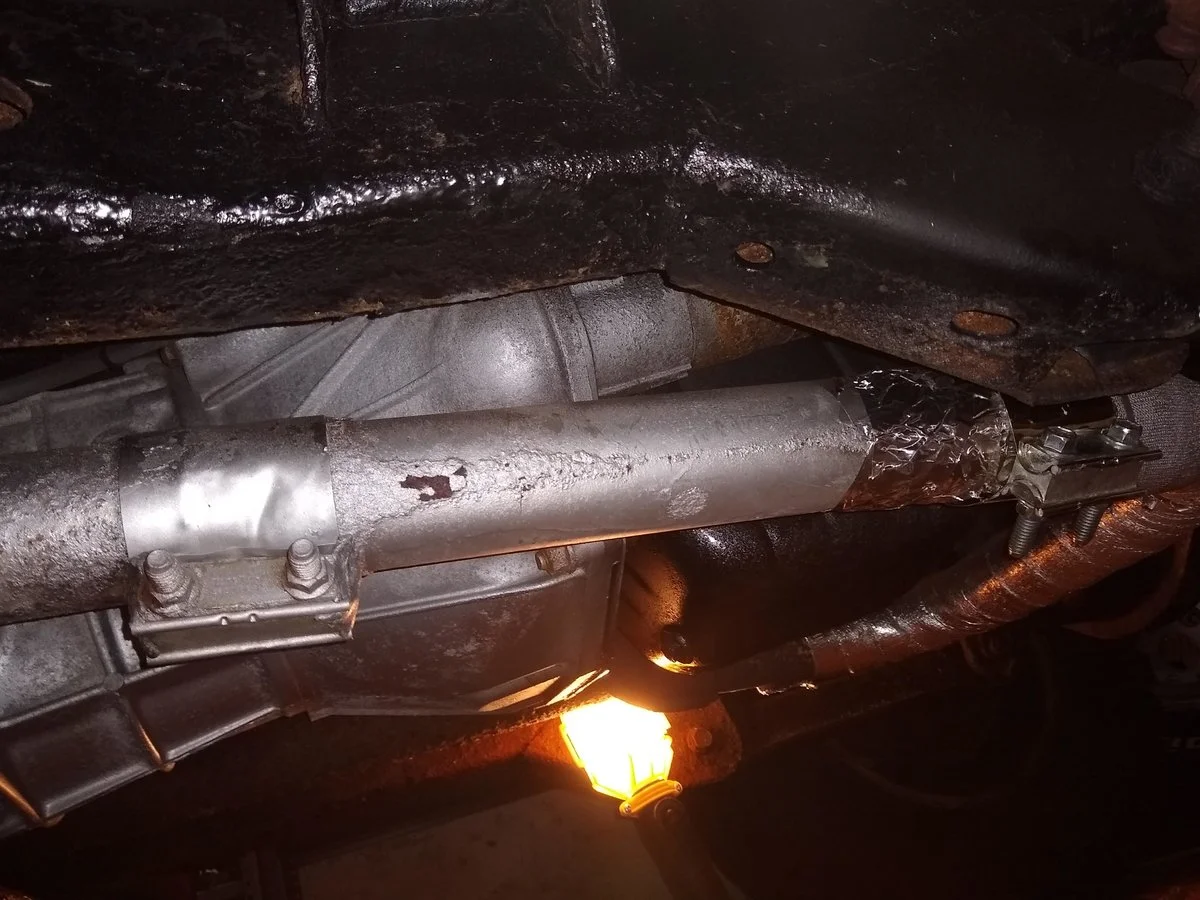

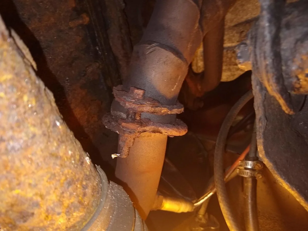

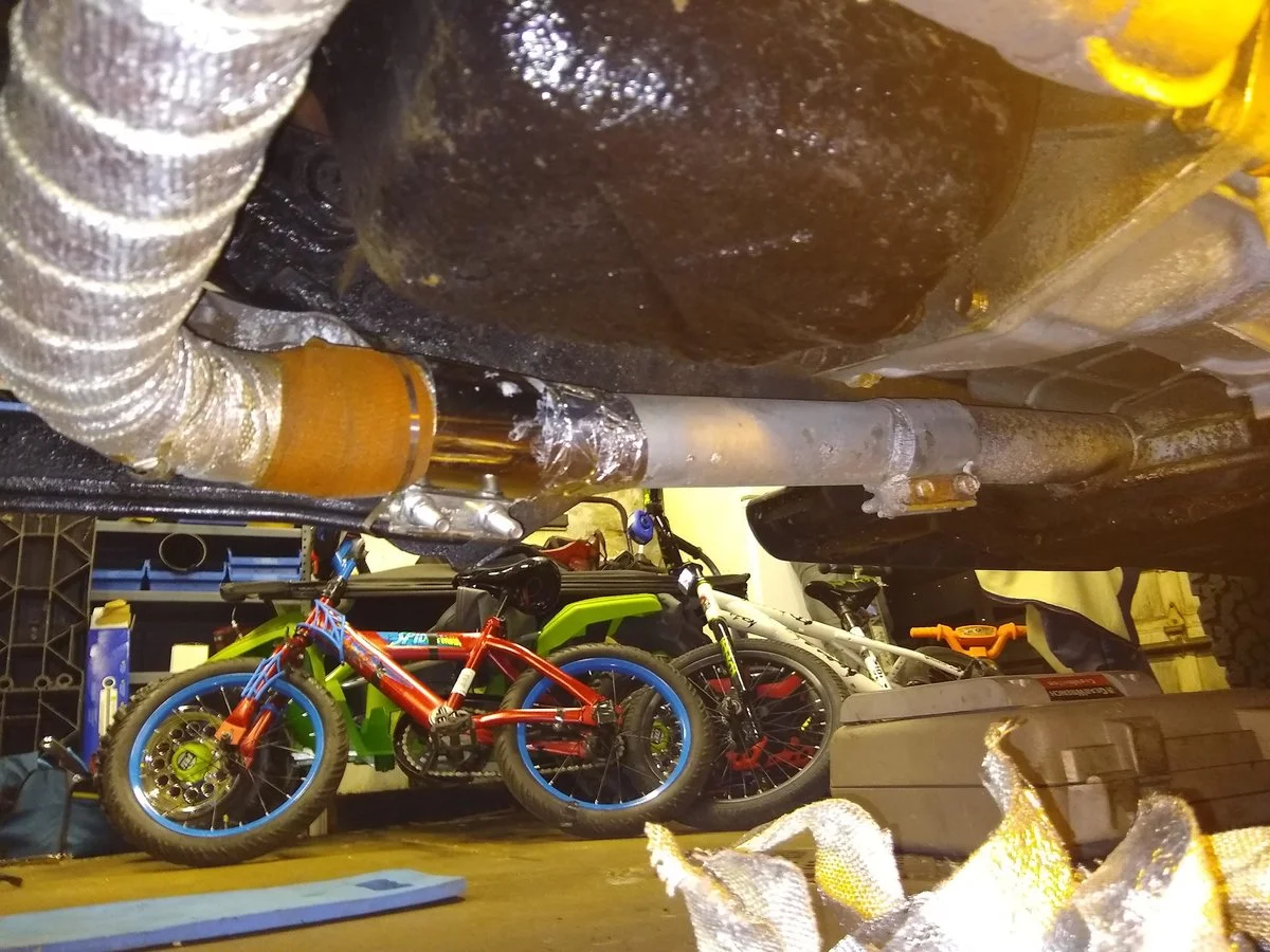

The Next few pics are of the downtube and where it meets the manifold. Here is where I have questions,
How does this interface work?
How do I get in there to cut rusty hardware off to remove the downtube?
any chance its leaking from where the manifold meets the head? That looks tough to replace.
Any info here would be great. The exhaust leek is driving me crazy. Who makes a decent downtube? It comes with a new catalytic convertor correct?
This joint had that silver heat wrap all around it before this picture was taken.

Welcome! What part of philly are you from? I’m from NE but moved out to MontCo 5 years ago. Nice looking Jeep! Looking at that last picture, make sure your frame isn’t rusted on the inside. Looks questionable like it was painted over. I can see rust thru the one hole. This is a great place for information! Good luck!
My god... talk about a rigged exhaust system! That entire exhaust system needs to be cut off and replaced, seriously.
The rest of the Jeep looks good, but that exhaust is terrible.
Have an exhaust shop do all the work and replace everything from the manifold down. They likely won't charge you that much (maybe several hundred at most) and it will be way easier than attempting it yourself, unless you have a lift.
Its terrible I know. I think I am going to just wait until the winter and take the intake off and just swap the manifold and downtube all in one go. Parts do not seem to be expensive for these jeeps.

TJ looks great, body looks fantastic. I would take a very close look at that frame even before the exhaust & other things, as it could be a safety issue. Get an endoscope synced to your phone & look inside from front to back, pull all the flakes out, drill some holes forward of the control arm mounts for drainage, wire wheel everything you can & repaint. There’s tons of threads on here about how to tackle TJ frame rust, & given the age of your TJ, where it’s likely from, & what we see in the photos this has to be job 1.
